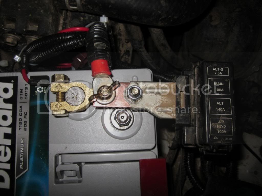

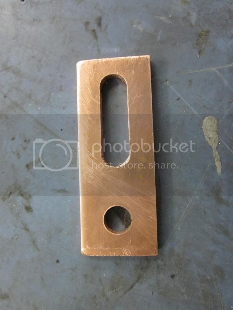

No, I am not. I had already ordered a foot of it for $9 from McMaster-Carr. 3/16" x 3/4". I wanted it to be rigid enough to hold the fuse box up in the air like it was on the stock set up. I am sure once someone gets around to doing this install, they will take you up on it. The battery is huge. 3 free replacement warranty, 1150 Cold Cranking Amps, 205 min. Reserve Capacity, and 100 Amp Hours at a 20 Hour Rate. Much more battery than what I was looking at before.

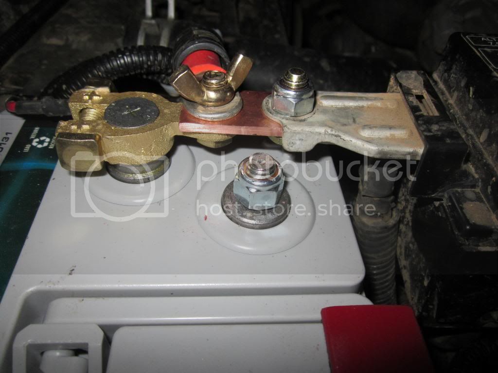

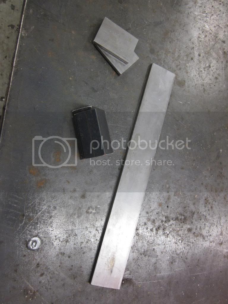

another pic - this time with the busbar piece
3/16 x 3/4 x 2 and 1/4 inches.
where did you get that nice thick piece of cooper? how much did it cost you?
It cost $8.86 from McMaster-Carr for a foot long piece. I had to cut of the 2.25 inches i needed. I ordered it Friday and it was delivered to the office Monday.

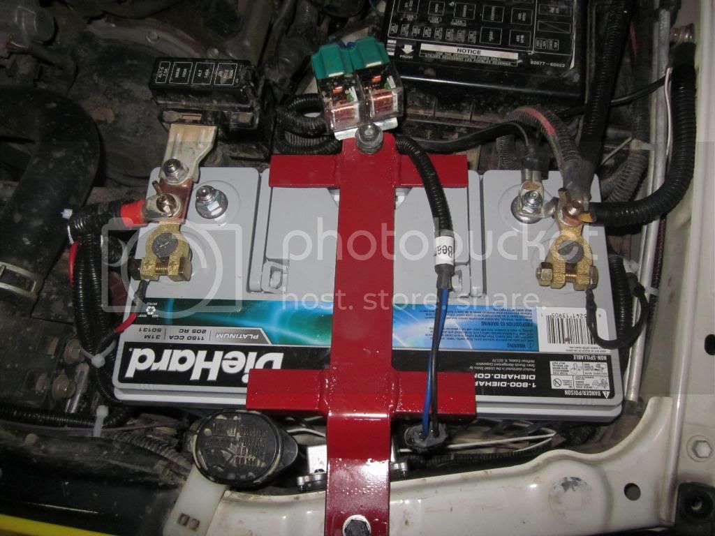

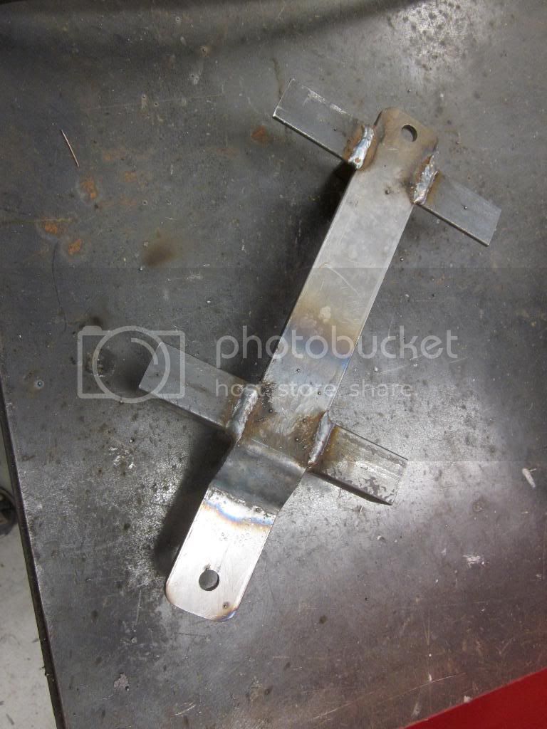

So I finally got fed up with my True Start Toyota battery not being reliable and dying on me twice in the past week and purchased a group 31 Marine Die Hard Platinum AGM battery. It has almost twice the capacity and twice the power of the stock battery (1150 CCA, 205 min RC, and 100 AH @ 20 hour rate).
Sears: Online department store featuring appliances, tools, fitness equipment and more

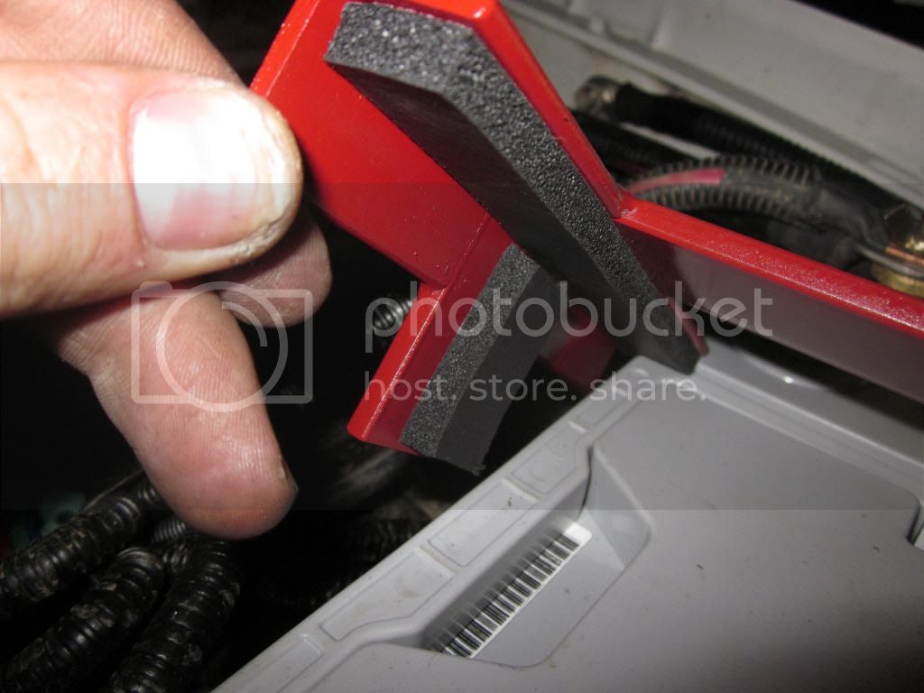

I was hoping, and under the impression that this battery would be pretty much plug and play sans the terminal location. However, it looks as though the design has changed since 2008 and the battery is a little bit taller. Because of this, the stock battery clamp will not fit (may be able to in a pinch). The biggest problem is in the length of the threaded hook. Anyway, enough talking and on with some pictures.

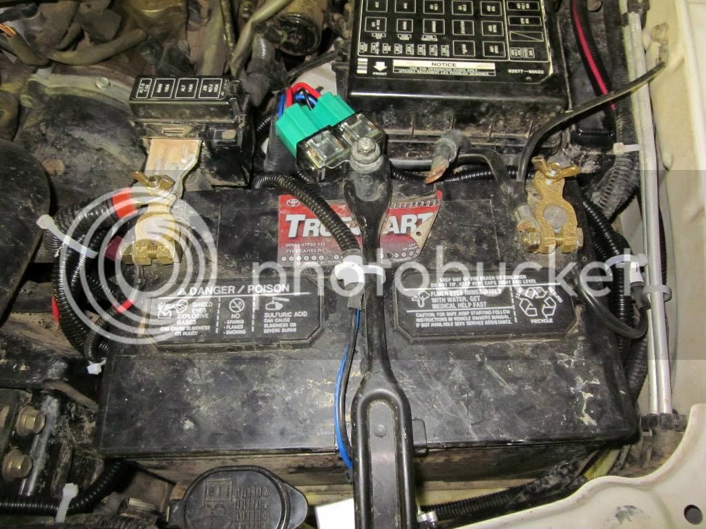

The old battery setup

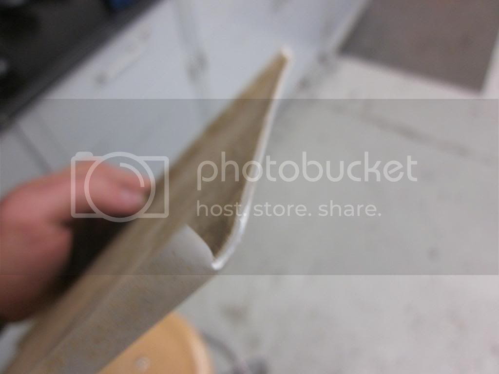

Had to trim the battery tray for size

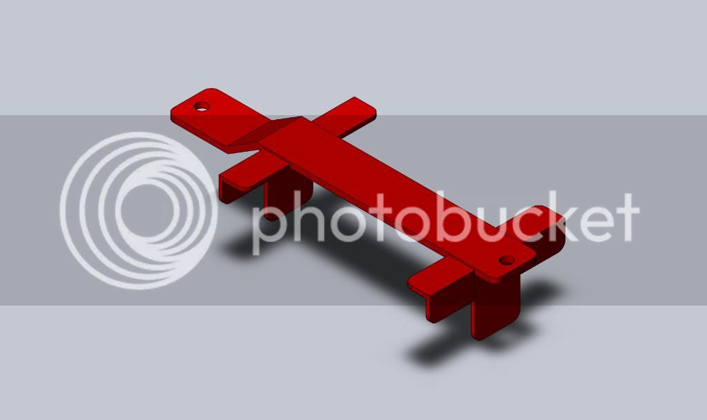

Since old clamp would not cut it, I made this one. If you need dimensions or anything, I can send you a pdf or the solidworks file if you have that.

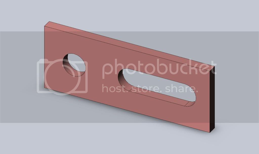

Next, I made a terminal adapter out of some copper flat bar from Mcmaster. If you need dimensions or anything, I can send you a pdf or the solidworks file if you have that.

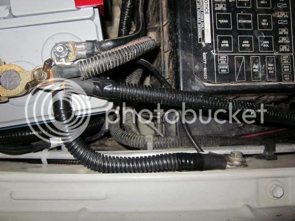

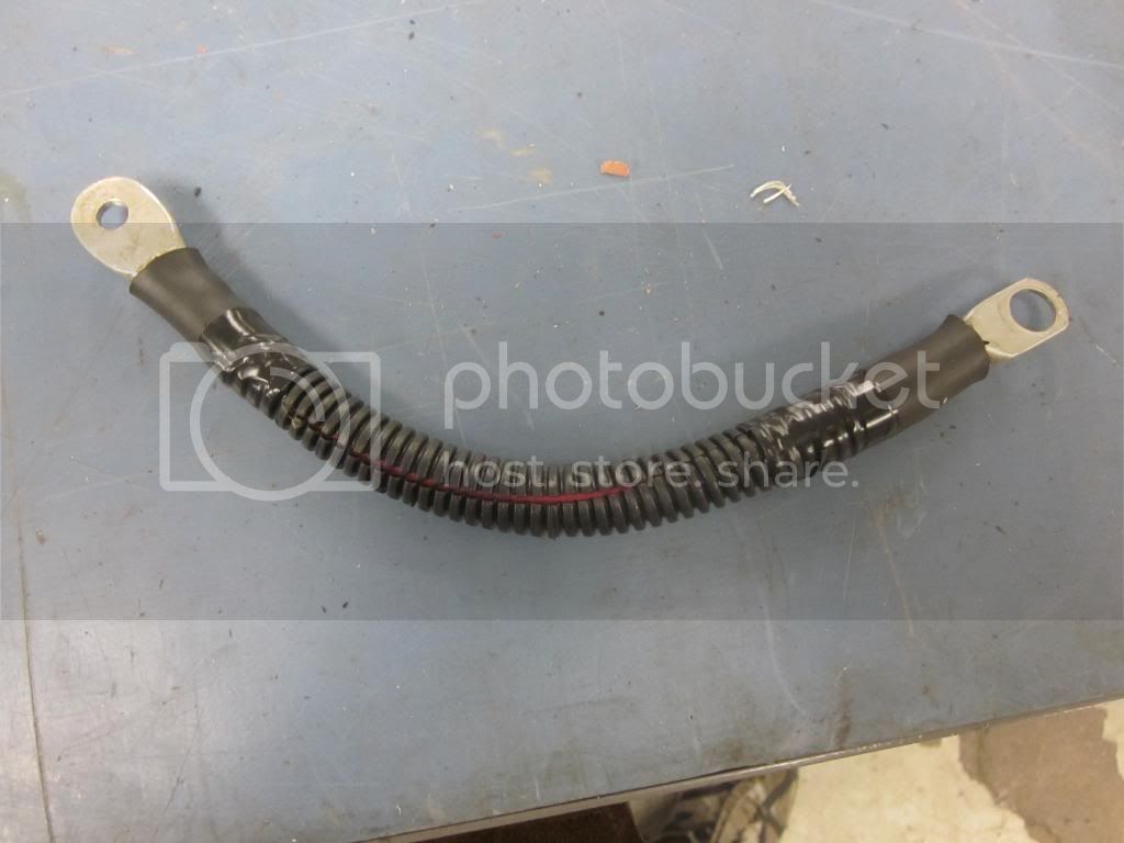

I also made a larger chassis ground cable from 4 ga. just because.
Let me know if you have any questions or suggestions.
