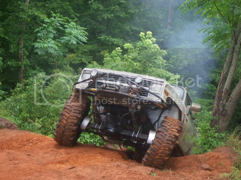

Oh and for you to say a Dana 60 isn't strong enough? I think I know my s***. Here is the other toy I have. It has Rockwells, because after breaking several chromo 35 spline axles for the D60, we determined it was a lost cause.

And what does you posting a picture of a "snow cat" or whatever that is have to do with the topic at hand?
AND I DO HAVE A CHEVY? It just has a 12V Cummins in it with a Dodge Tranny. And Rockwells. I like my Toyota. If I wanted another Chevy I would have bought one. But thanks for the suggestion. Why don't you take your non-informative ass and go clutter up someone else's thread. Wait my mistake, you did suggest replacing the wipers and installing Marlin seals. Thanks. :rolleyes:

I posted the sno-cat because it is running Dana 60s. With a Cummins too...

Well again a snow cat running 60s means what to me? All that tells me is they are stronger than Toyota axles or else Toy axles would be under it. You just proved my point further.
