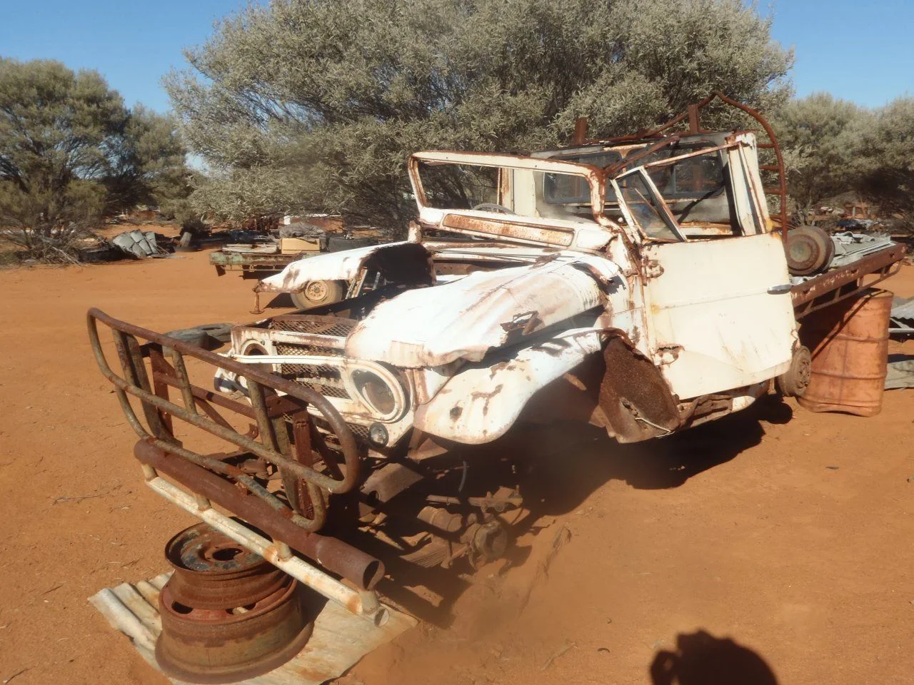

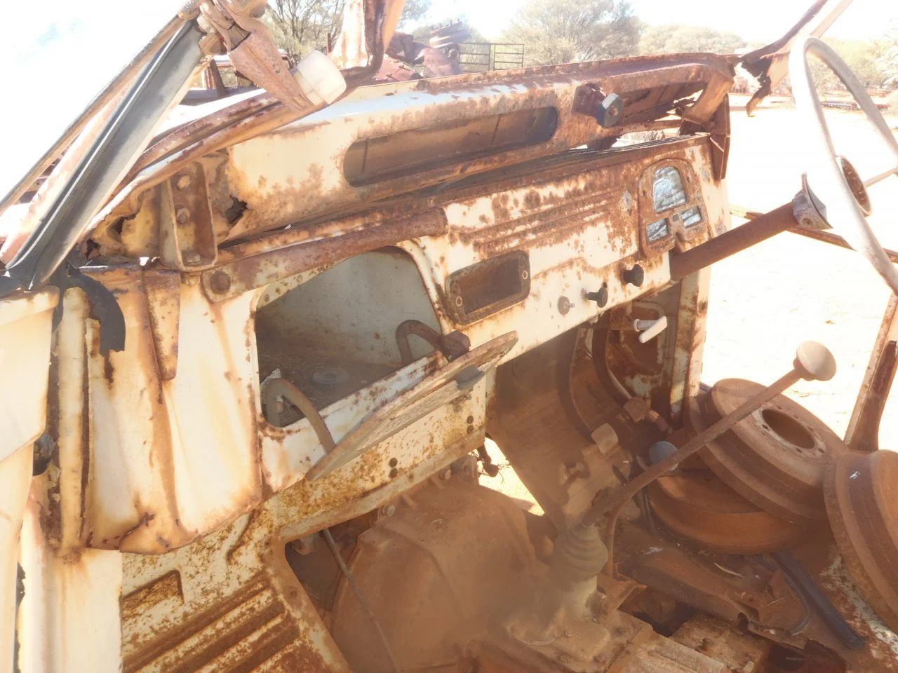

payney - step 1 - get that original 64 interior mirror out of your garden and into your safe - step 2 - gather up a couple mates and a decent esky and come for a drive across the paddock. this uncut (heavy surface rust only) 64 dash is what you need for your project. its in the perfect donor vehicle!
