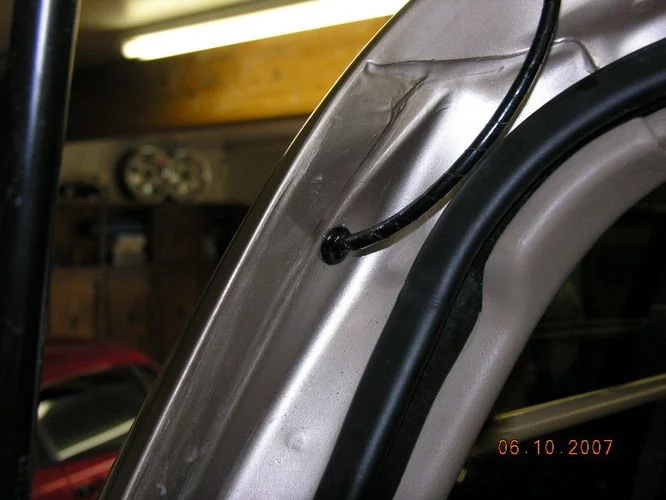

I got the brain under the drivers side seat. Fits nice once i moved the alarm a few inches as well. Ran the antena from the drivers side and came out perfect with about a foot to spare under the drivers side seat.

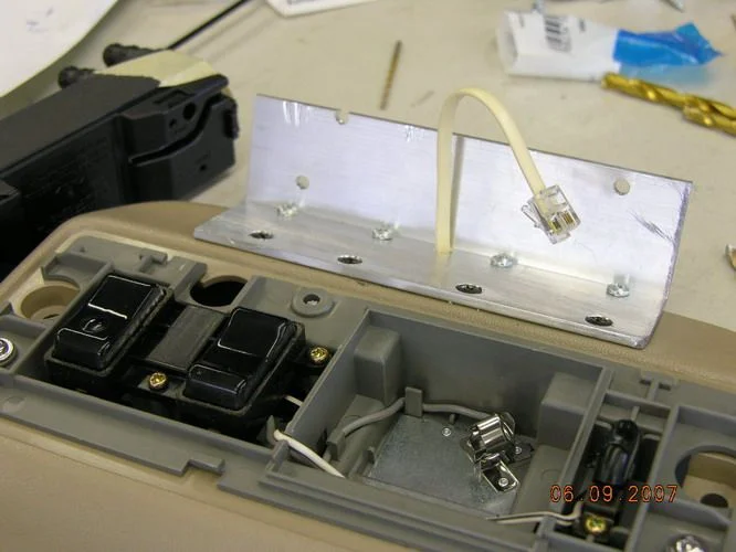

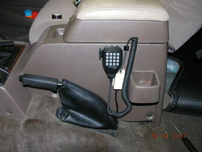

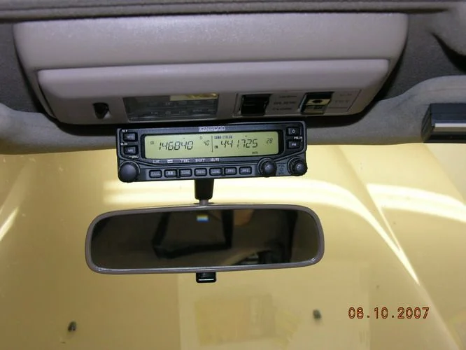

I'll post pics of the install when done. I think it will come out cool. I'm going to build a custom mount for the faceplat and put it above the mirror hanging down. Mic is next to the E-Brake handle.

Here are some photos if they posts. Try the link if it doesn't work!
http://new.photos.yahoo.com/stewart1466/album/576460762404221482
Sprocket,
That looks like a really nice and clean install.
Congrats. Very nice.
