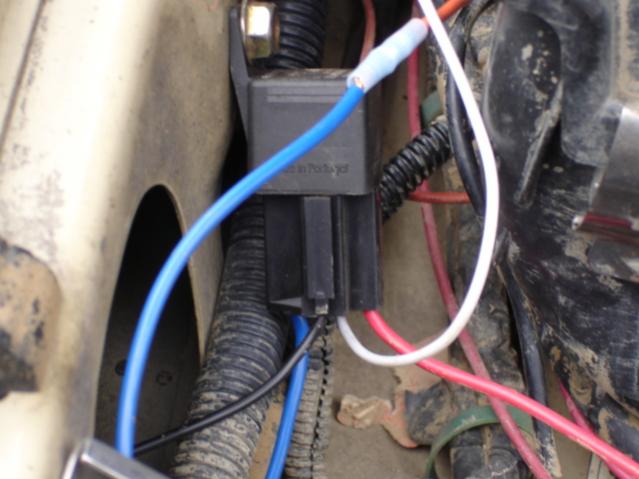

I used a relay triggered by the factory toytoa a/c clutch wire to tirgger a relay that energizes the GM A/c compressor.

First pic is showing a relay that is on the passenger side firewall that feeds the compressor. Wiring is still under revision but functional.

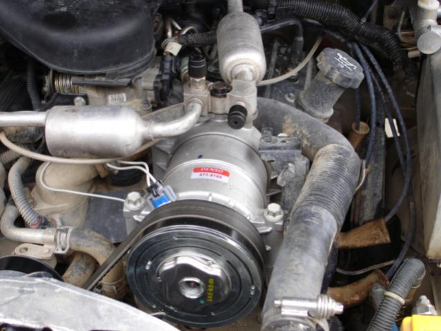

3rd pic shows new GM compressor, you can't read in the pic but its a DENSO
