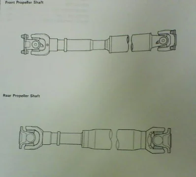

As @BILT4ME said, the front driveshaft comes from the factory out of phase. This is almost unique in the automobile world (I have heard of one other vehicle that uses this configuration, and it was made in the first half of the last century, IIRC) so many driveline pros will argue that it isn't right. For a lifted truck it almost doesn't matter if it's in phase or not because the angles are wrong for either config, but if your truck is at stock height you should definitely have the factory config. You could should print the FSM page that clearly shows the phases of the two driveshafts and show it to the driveline shop.

Welp, didn't take much troubleshooting. The front slip yoke is installed in phase.
I guess the tech was right that someone assembled my driveshaft "wrong," but that someone was Toyota and it was supposed to be like that for some reason. Going to give them a call tomorrow and see if they'll correct their mistake (again).
Thanks for everyone's help.

I thought there’s been reports on this forum that the FSM shows it both ways, and trucks arrived with the shaft both ways, depending on year. It just doesn’t seem likely to me that in 25 miles it’ll come apart, if it truly did come from the factory both ways, depending on the year.
When the early trucks came out (91-94) the FSM showed the front DS in phase. In 95 I believe, there was a TSB issued by Toyota to change it to 90°out of phase. All trucks 96+ are out of phase.
