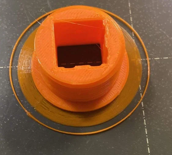

Ok, so I've bought the dual powerwerx units before (that replace a cig lighter 'outlet', but given I now have the powerpole 'part' design, I figured I'd create my own. Bit of time and pennies to 3D print.
First proto. Final will be in black, just orange was already loaded and since this was just a sizing proto...
Still on the 3D printer (with brim)
Powerpoles slide in beautifully.
The rear view. Same hole going through to push in the roll pins to secure them in place. One roll pin pushed in per hole.
I'm still 'refining' the nut thread.
I'll attach the STL files once I've got the nut sorted out. Fits the same 1 1/8" hole as the powerwerx and other cig outlets.

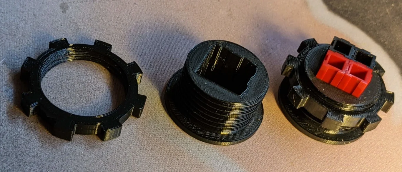

Got the nut sorted out. Great fit and put little knurls on it to make it easier to tighten.
Have printed out a pair (one for the back of the center console and one for the rear). They will go in place of 2 existing cig outlets. This will leave one cig outlet at the back of the console and one in the rear, just in case something needs the old style outlet.
