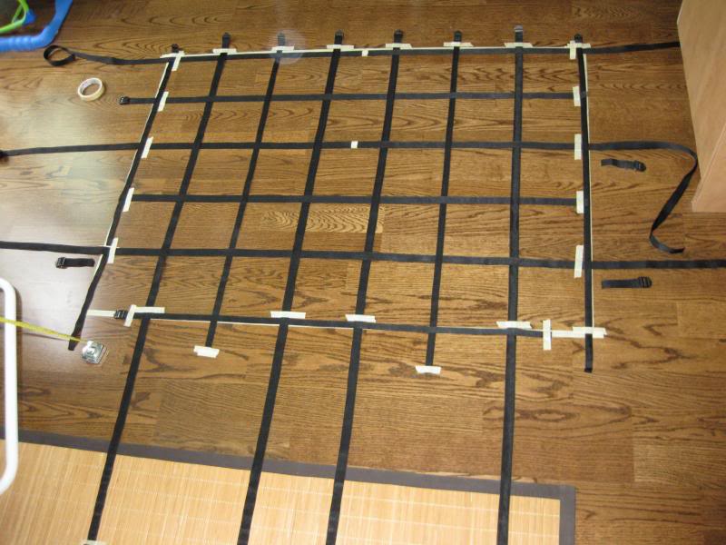

back from the past with a little update....with a homemade cargo net, the hard way!
pretty self explanatory...got some nylon straps of different sizes from a camping store, took some measurements, decided to latch them on using eye-bolts around the perimeter of the deck, while not getting in the way of sleeping (with mats/sleeping bags down, i'm sure we wont notice them), hand stiched every intersection (took a lil while! but i kinda like doin mundane stuff like this) arranged so that i could use the buckles for some of the strapping. i can fold the net in half to cover the rear part, and secure part of it to the top boxes, or i can take the top boxes off and net everything down, lot's of ways to tie things down. should be fun tryin it out for the first camping trip!
a bit of a pain tryin to line things up, taping the mock up down before doing tape and small stitches to hold the shape/weave before stitching it properly and making it strong enough to hold camping stuff down (camp chairs, tent, bags, stroller, etc..nothing crazy heavy so it should work okay)
folded back, the buckles will meet the strap ends. i added 2 straps midway to anchor on the top box to hold the front down while the straps fold back (sorta sandwiching the contents). i think this way it's quite versatile...the one end with all the buckles i can always use for more connecting points when using the whole net if, say, i had to drive with the bed folded down...

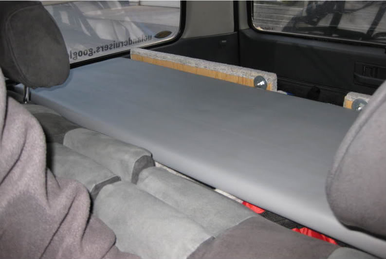

and here's the baby change table. this way, we can easily pull over, take the baby out of the seat in the middle, plop him on top just behind and change away. just a piece of wood, with blue camping foam, and vinyl on top...swings up to expose some storage for easy access to food/baby stuff, etc..
carefully supervised, little guy can even nap or just lay out for a quick baby massage after a long drive.
we just have to sorta turn around and kneel on the back seat to handle the little one, just enough head room...

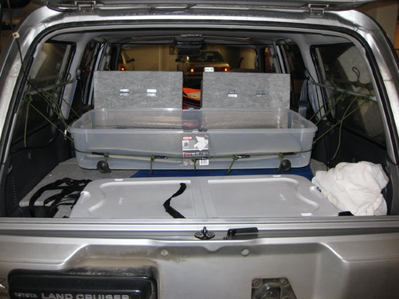

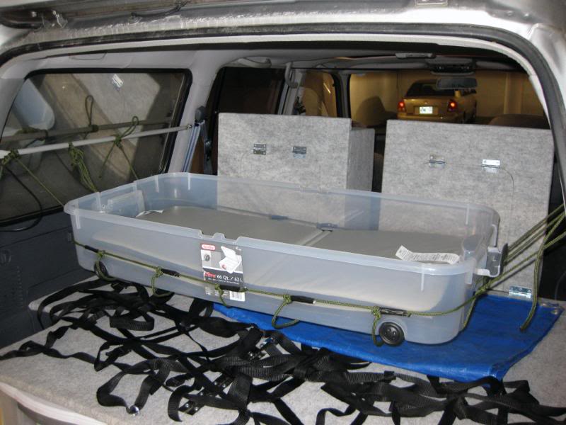

here's the baby crib idea...found the right size container, found some car seat cushions that fit perfectly (2), got some nylon rope, and it all can hang across the back anchored to the rear window bars...
just need to add some sheets, bundle the little guy up, and see how it goes...
it's a little tricky to try and level out, decided to use one of my bins underneath to set it on before securing the knots...but i've since decided to use the same straps that i used for the cargo net, a lot easier with buckles/adjustable(duh!), will take pics again of that set up... should be interesting...gonna try gettin the little one used to sleepin on the bin! tripple checkin that it's safe.... he'll be suspended over our feet, only a few inches from the bottom, we can sit up and pick him up if he fusses...worse comes to worse, he sleeps next to the booby.
