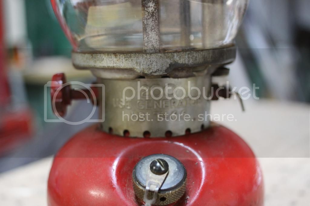

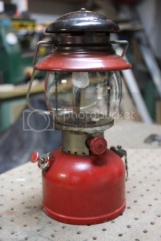

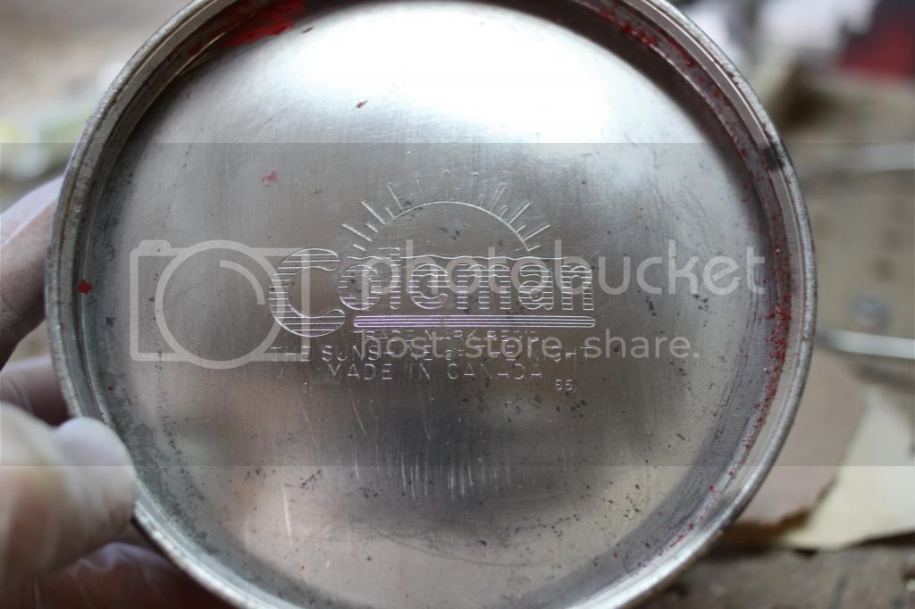

It's a 1965, 200, Made in Canada. Original Globe, no dents.
When I went to purchase it, the guy said it was old and did work the last time he used it... but when I showed up he couldn't get it to work.

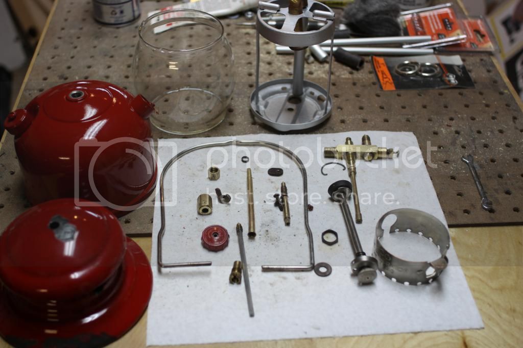

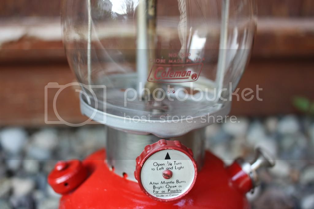

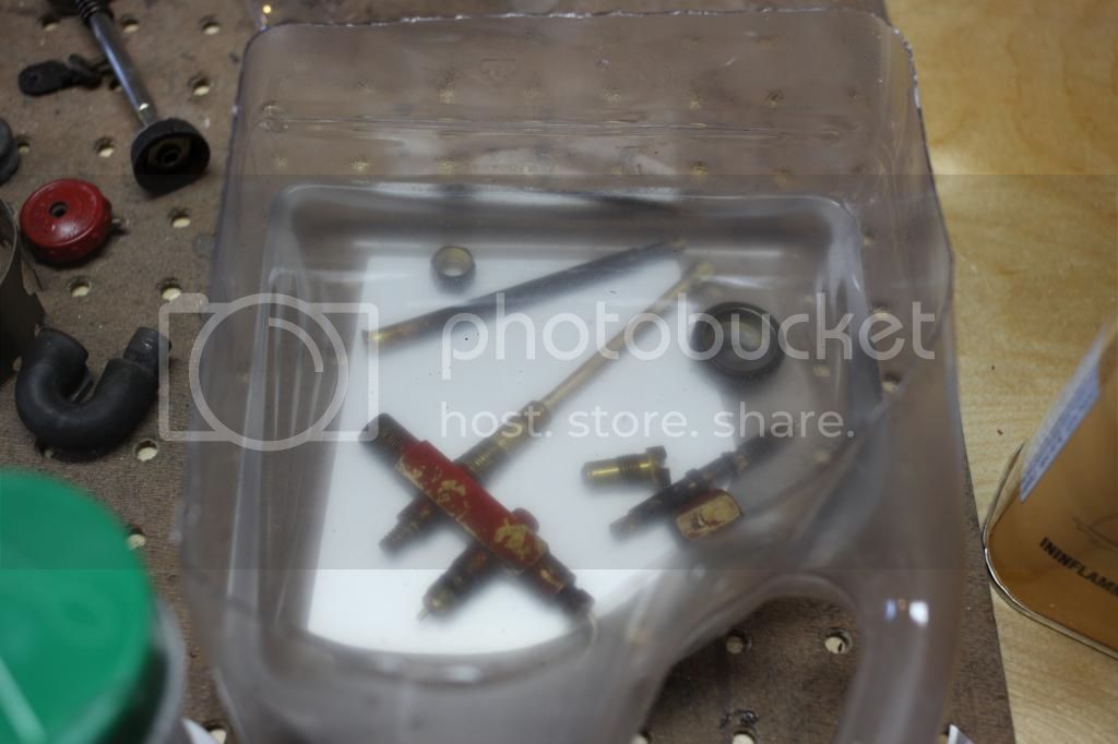

Offered him $10... and he took it! Simple fix, dried up pump cup and torn mantel. Within 5min of getting it home, I had it working.

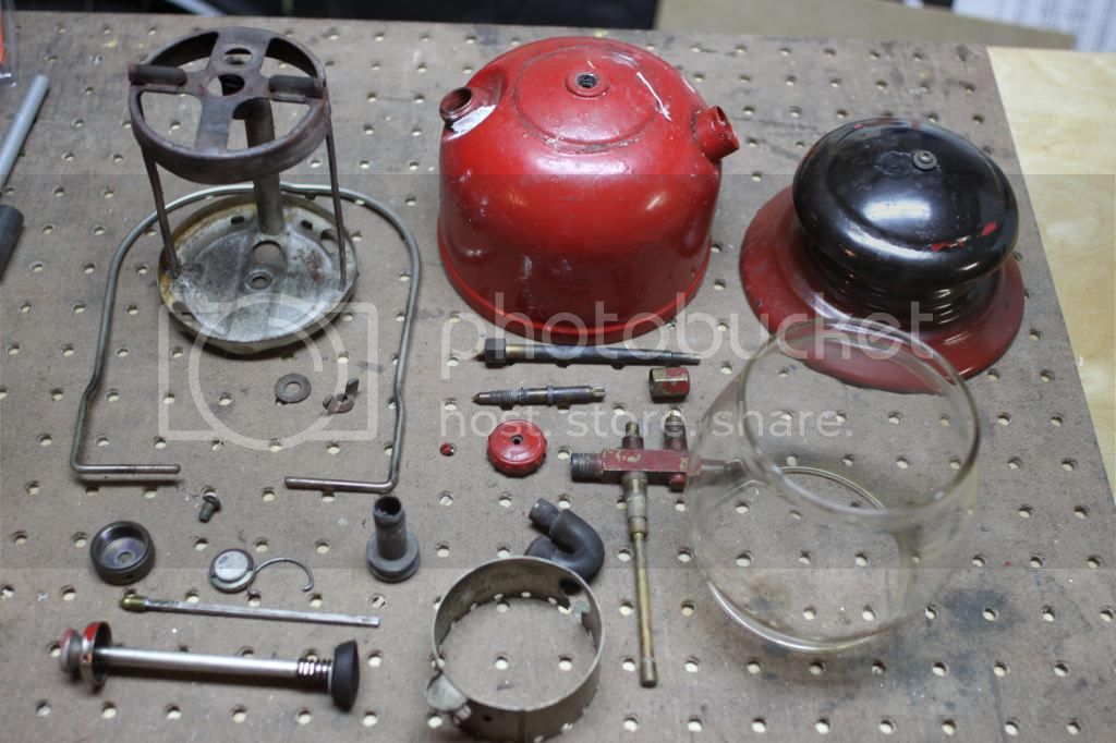

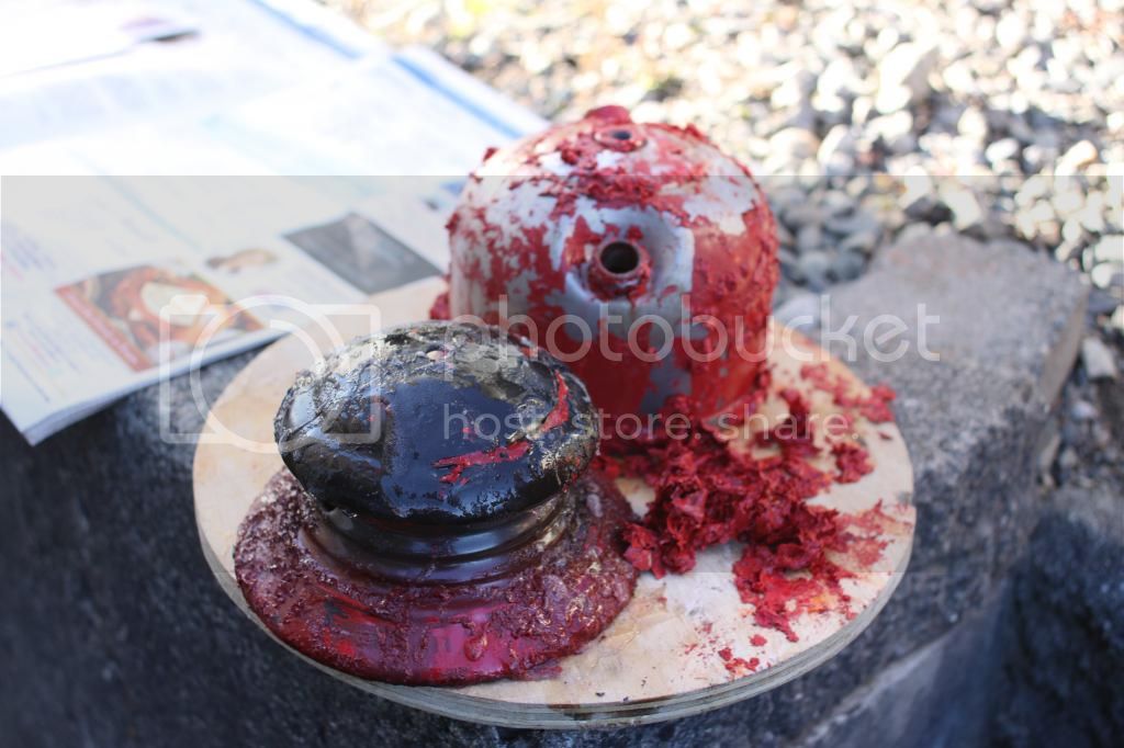

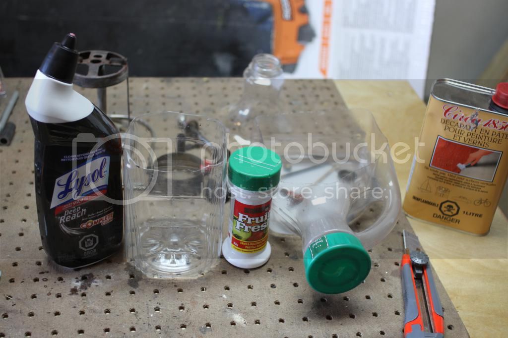

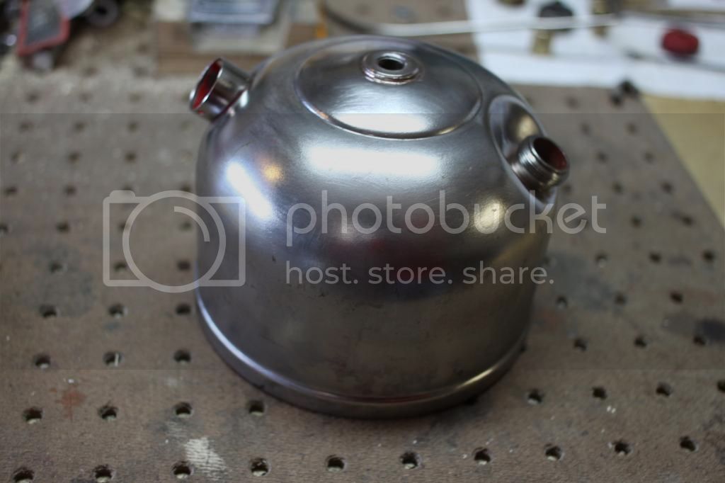

Upon further inspection, the lantern needed some TLC and it had some mis-matched pieces.

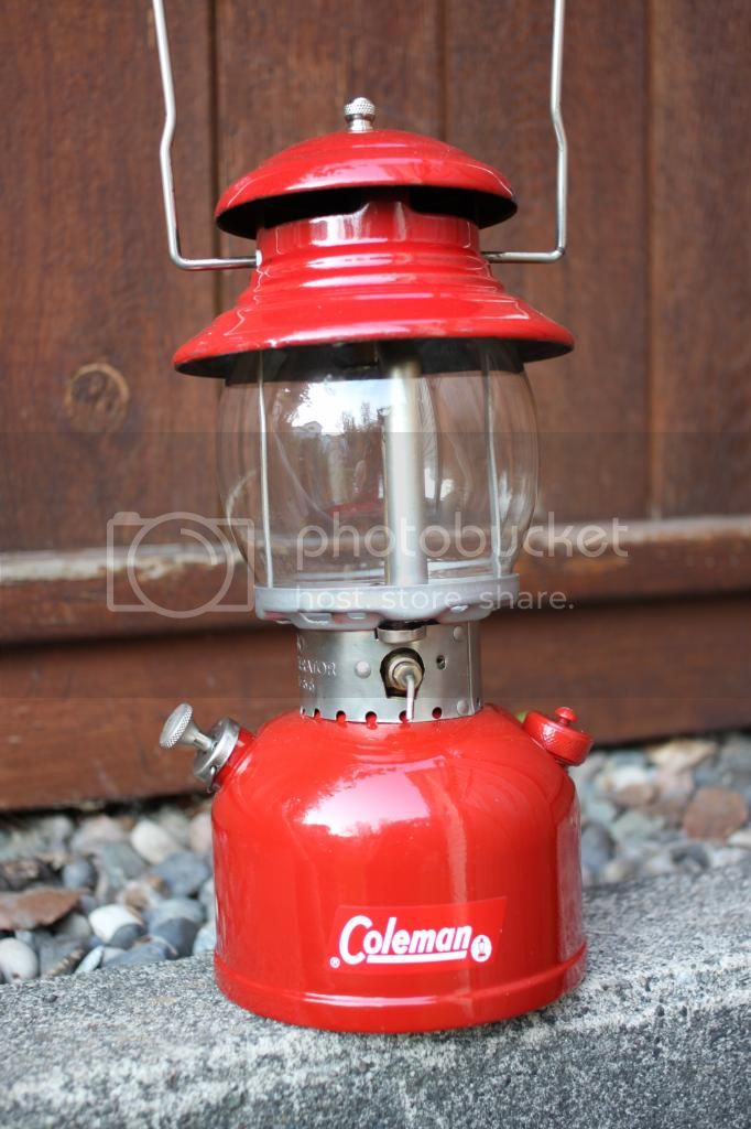

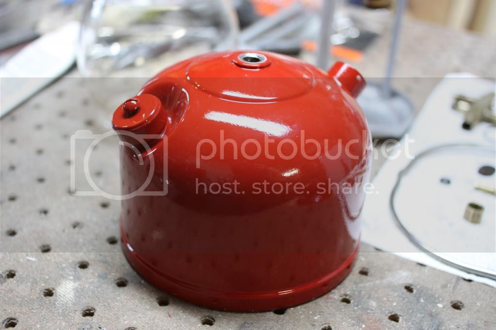

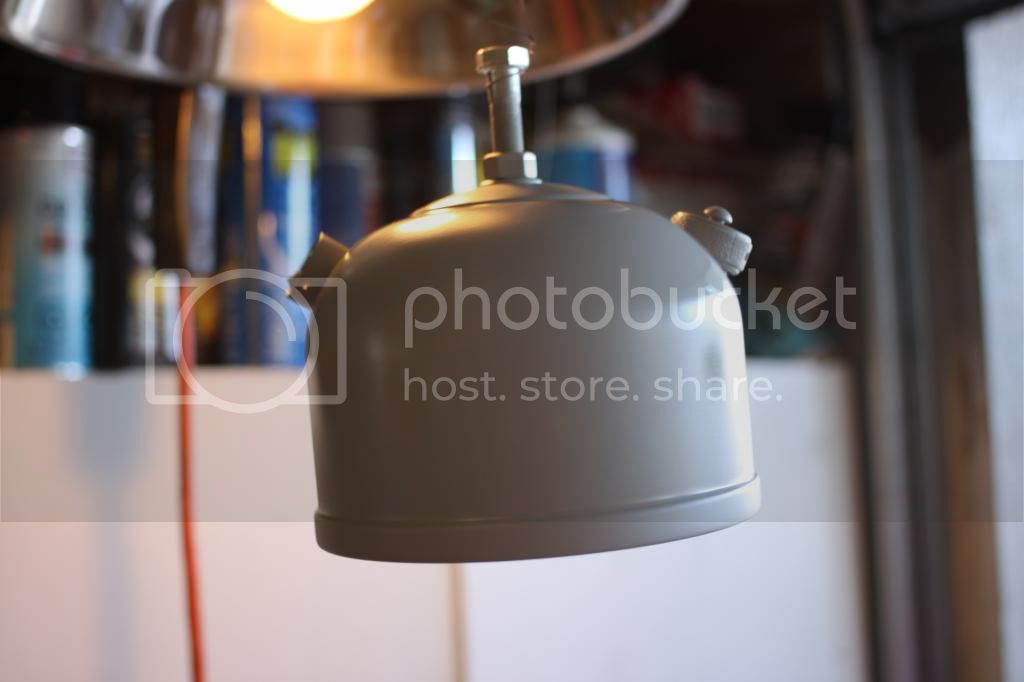

Decided to go ahead and do a full restore!

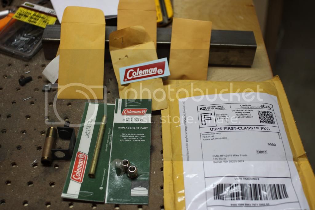

All the parts are obtainable through www.oldcolemanparts.com
Cost me around $30.00 for the paint and misc pieces.
Fun little project!
