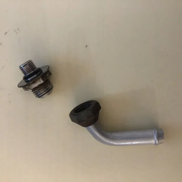

So when I recently pulled the radiator out of my 200 LC, I bend one of the transmission cooler tubes that directly connect to the bottom of the radiator.
This part can't be purchased separately from the radiator (%$#@#$). A fellow Mudder in TX has one on an old radiator he pulled out of a 200 and is sending it to me (thank God for forums like this!). If that doesn't work out for some reason I think this little tube could easily be made if I had a tube bender, and flare tool. I've never done that but I'm sure someone on here has. Would a cheapo Amazon brake line flare tool kit do this? I need the flare for the flare nut and also the rubber tube end "barb" for the spring clamp.

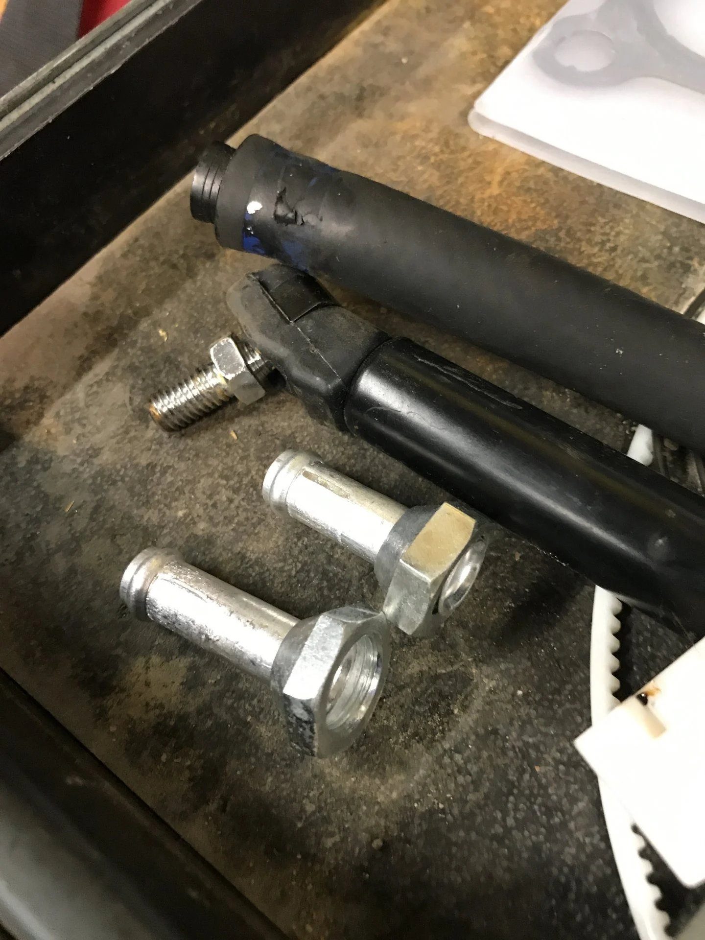

Can you take a picture? I doubt yours will fit but maybe. The ones from the guy in TX will not work as the fitting that threads into the radiator is different. Here's a better pic of mine with the flare nut removed.

Thanks. Don’t think those will work. It turns out that my radiator is not OEM and the connections I have for the tranny cooler are different than OEM. I’m going to have to make something. If I can make the turn with the hose using a straight hose barb, that will be the easiest way.

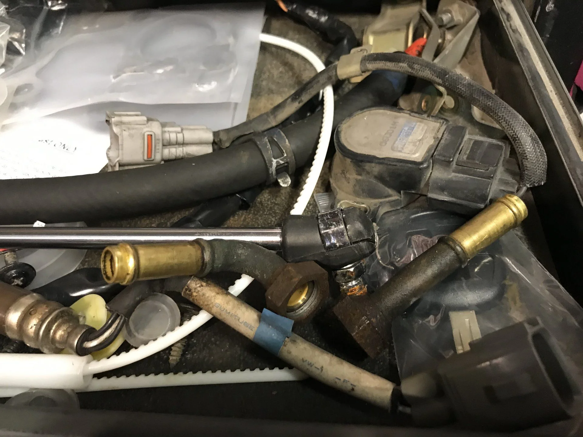

Welll these are aftermarket courser thread than stock. Your welcome to try them. I will likely never use them. I by passed that cooler.
Hmmm. If the thread is right on the flare nuts, they might work if I could get the hose to bend in the space I have. I’ll PM you and maybe I could come to you to take a look at them.

Thanks. They are AN. I tried a local hydraulic shop but they didn’t do anything aluminum. I could get close with Summit and probably could have made something work. I ended up reusing the twisted fitting. It really isn’t too bad from a flow restriction point of view and it doesn’t seem fatigued. I’ll just keep an eye on it.
