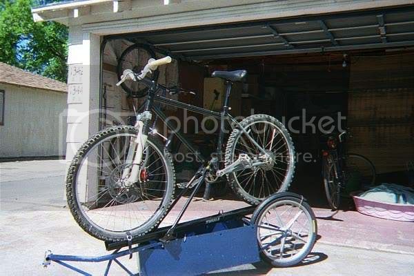

Can save weight with aluminum in the design if you can do simple beam analysis (quasi-automate the calcs in Excel). Vary the tube dims and the wall thickness' to yield a tube selection that will carry the same load as a steel tube design choice, but weigh less. Adding wall thickness helps, adding geometry, mostly in the vertical since that is the dominate load direction, can result in less weight and a stronger design. I'll warn you though, when I went thru that process for the bike trailer below and building it out of aluminum would have cost 3 times as much.
