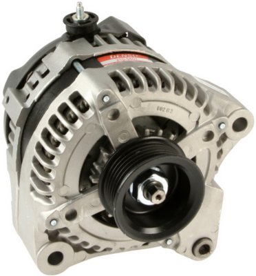

Denso 210-0607 is the 130amp replacement I used on my 07'. Changing the alternator is the same process across all 100's. There's no reason to remove the radiator or even any coolant hoses, but if you want extra room for the job I can see how removing different things creates more space...
