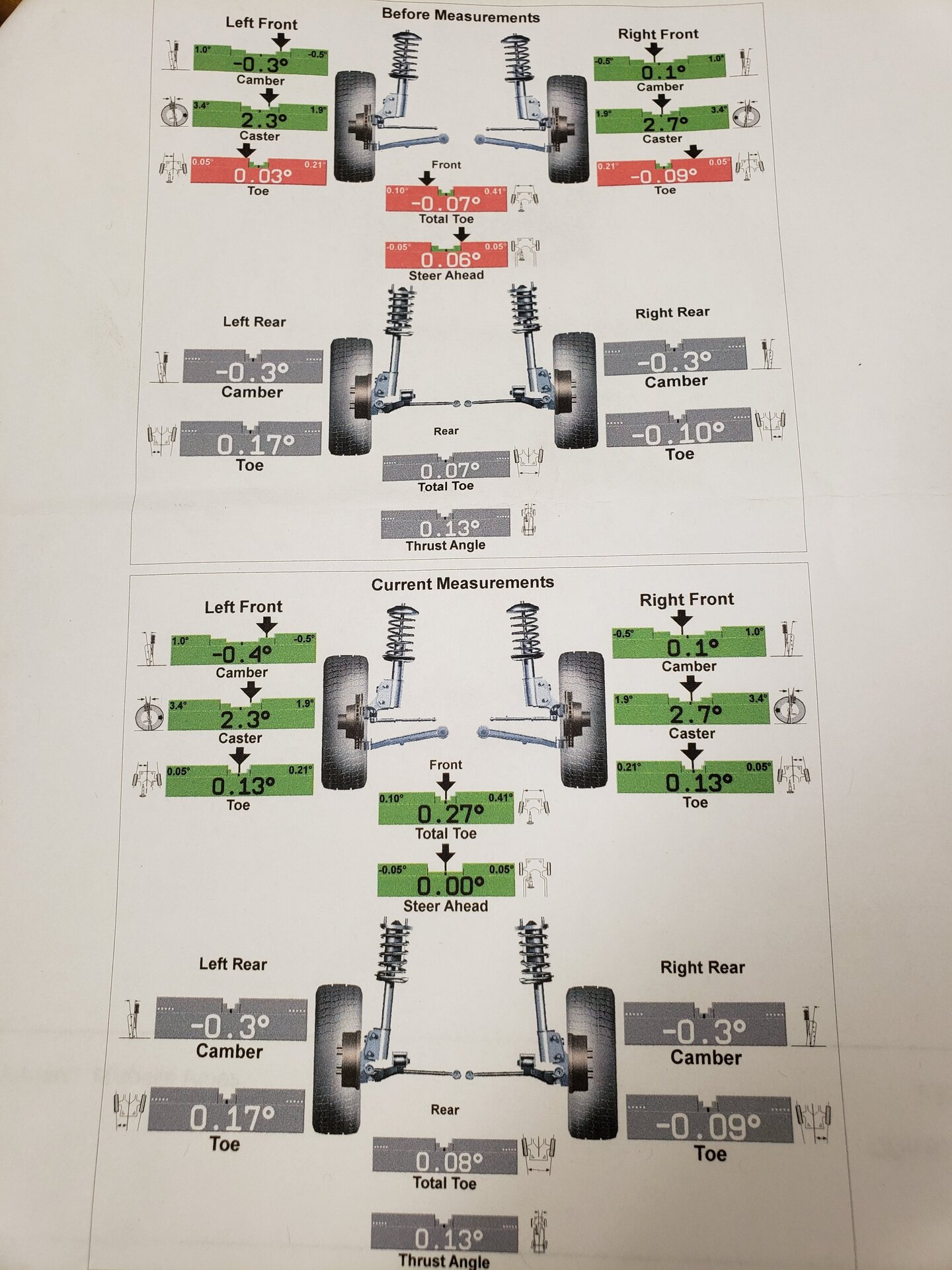

Had the dealer align my crewmax at the end of November, and put on a new set of stock size michelin LTX right after.. now, 2,300 miles later there is very noticeable feathering on the outside of FR tire (1.5mm step between sipes in outer tread blocks.) It doesn't pull as bad, but still wanders left pretty quick if you let go of the wheel (less pronounced in right lane, but present on either side of the road crown.)
How common is it for the adjuster cams to appear all over the place? I.e. no symmetry? (I am pretty sure the last place that aligned it screwed it up bad). The dealer didn't touch them, only adjusted toe.
Any comments on the numbers from any alignment gurus? Truck does have 5100's that are I believe on the first notch (3/4" lift?).
Your alignment #s look good if them's the real #s (bad shops can fudge #'s to make it look good on paper, and to get it done fast - ask me how I know). You could get an alignment check at a reputable independent service shop with modern equipment to verify, usually under $100.

Also, OEMs wheel alignment specifications are not all about tire wear, it is about vehicle handling and safety first, tire wear second. When a person sits in the vehicle, all the numbers will change, sometimes drastically. If the fuel tank is full/empty, towing, box load etc...that all changes the numbers.

its toed way out. spec is +.1-.4 hes -.1

Are you referring to the "before" numbers? Yes it was way off, pulled left hard and ate tires after my previous "alignment" (at an independent shop).

the numbers shown. the lower caster on the left in theory wants to go left. that same wheel camber says right.
so maybe numbers are fudged a bit.
that toe number looks good, possibly a little much, i like to stay closer to 1/8" toe. so that could contribute to the darting.
