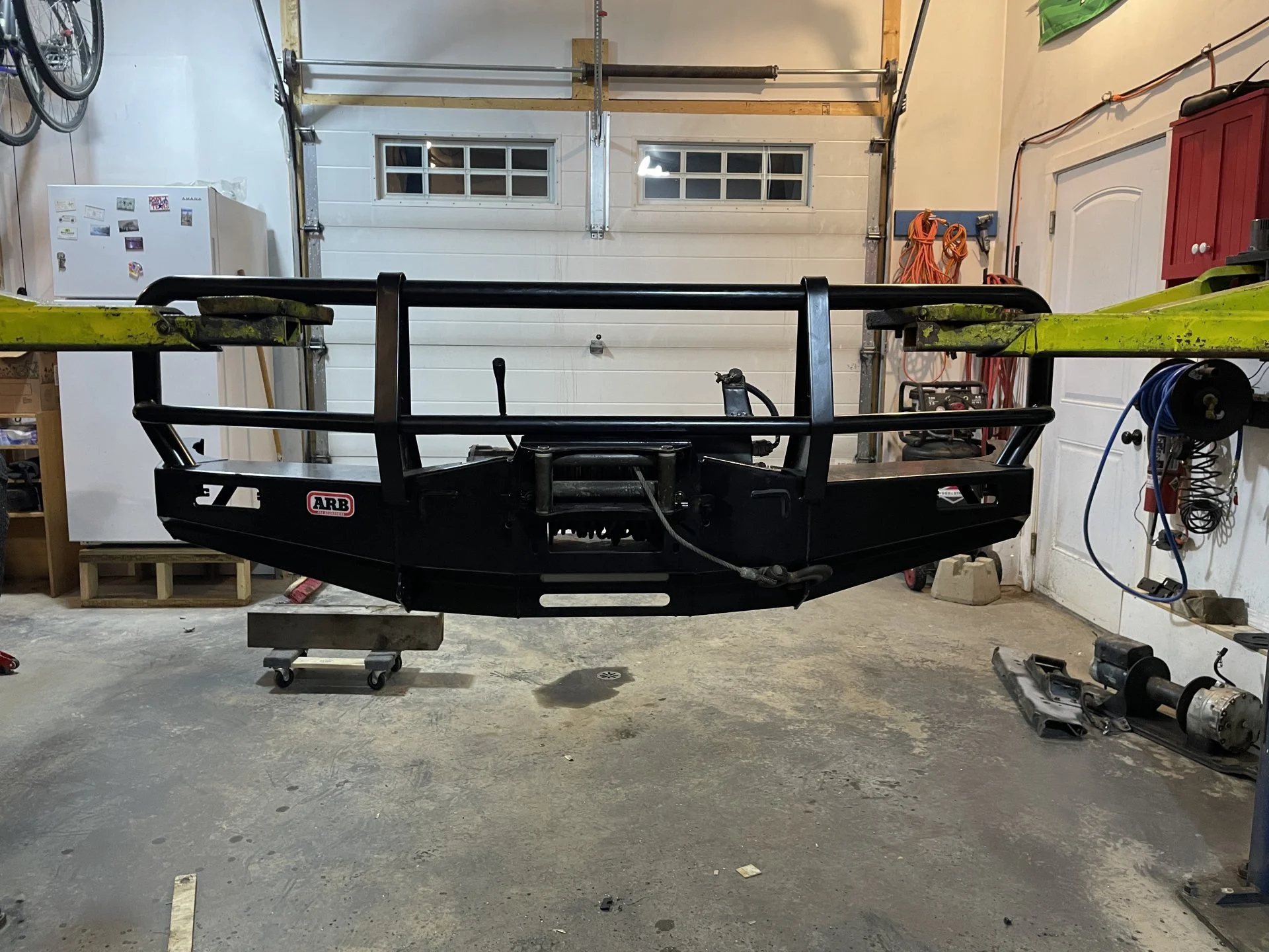

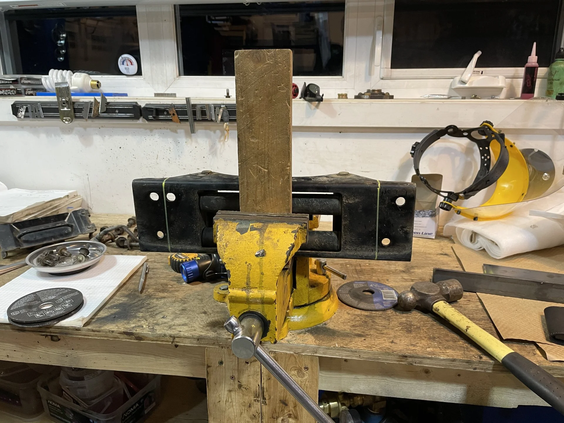

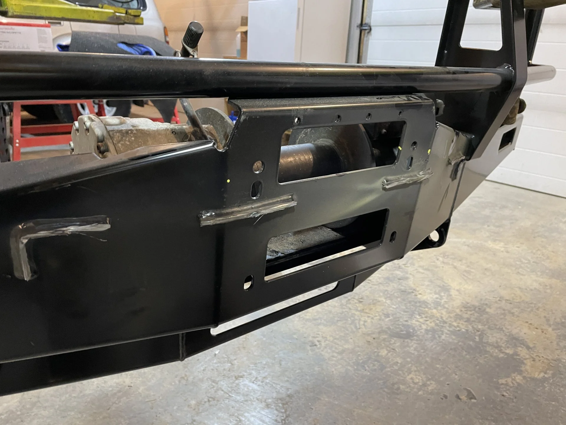

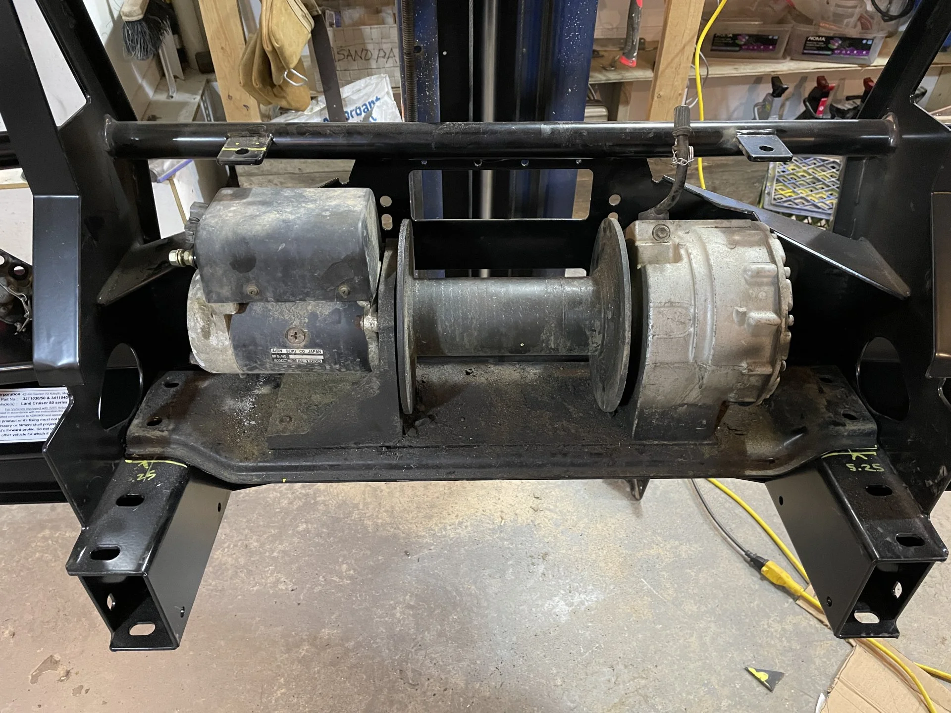

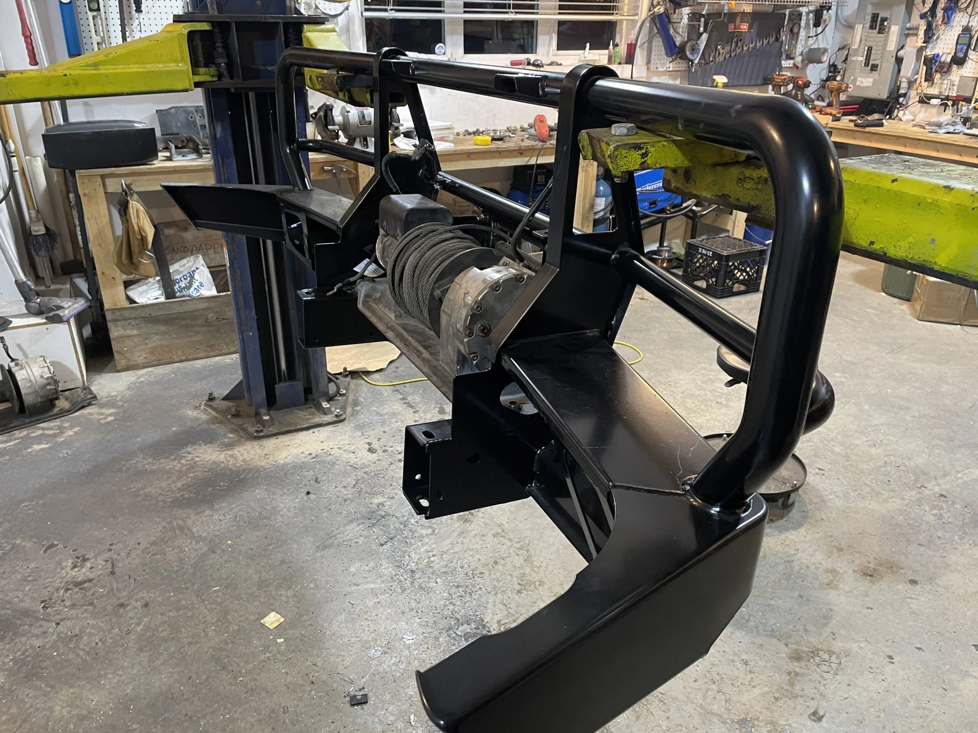

So my HDJ-81 came with a winch and I wanted to move it onto a new ARB Bumper. Basically I bolted the OEM winch plate on to the Bumper. Had to cut notches in the bumper steel to get it to fit close to the the front. Chopped the existing roller fairlead and drilled new mounting holes for it. Also cut the top cable opening on the bumper wider and deeper to match the fairlead. The roller plate on the ARB had to be ground off. Here's a few pics...

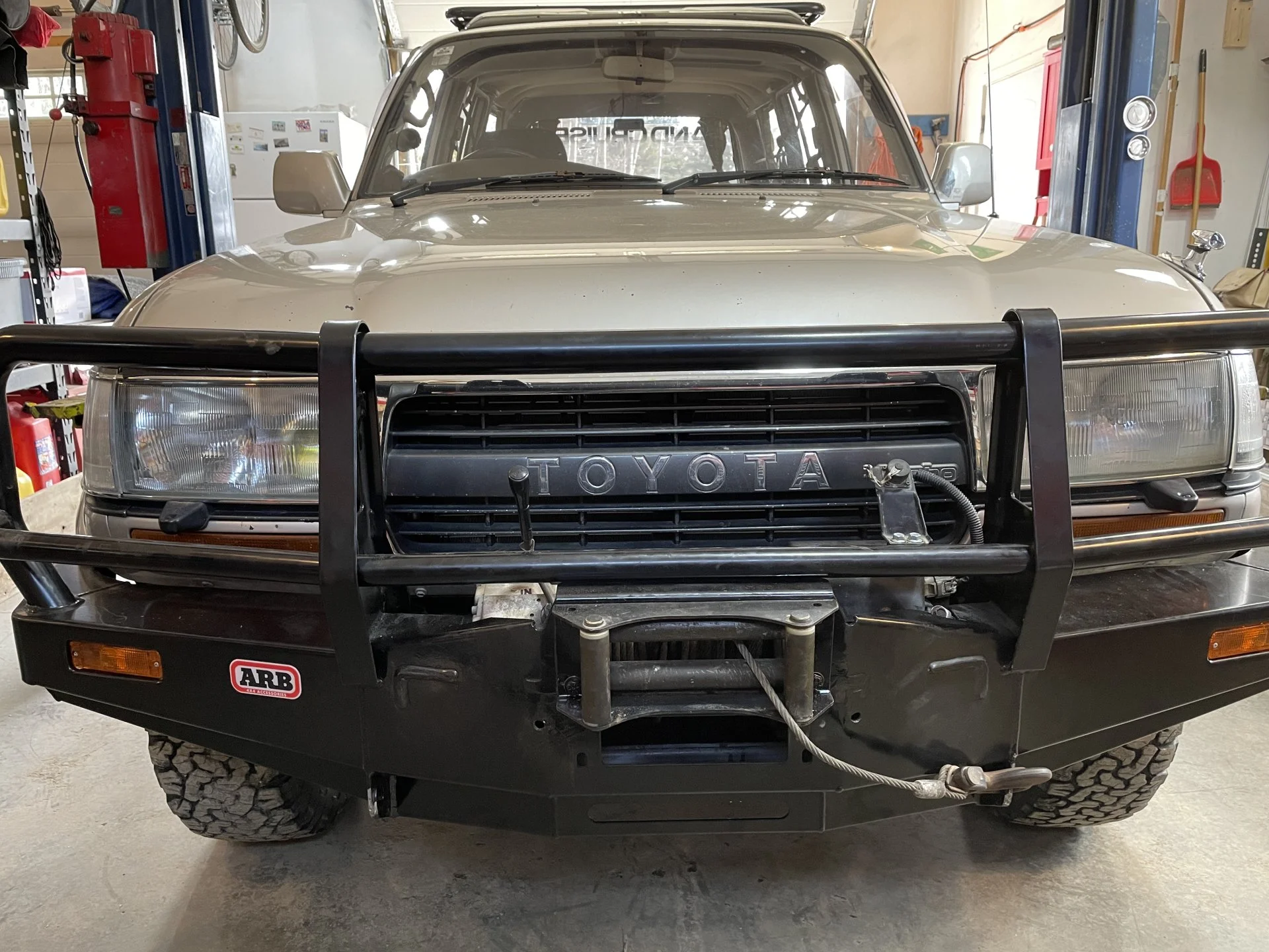

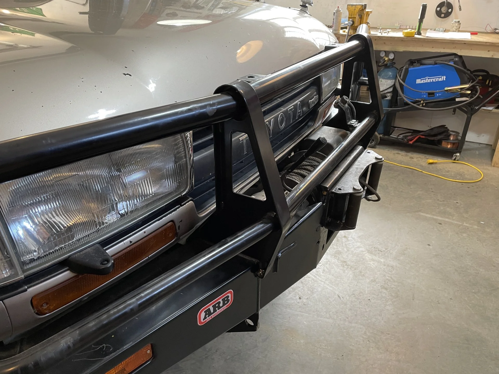

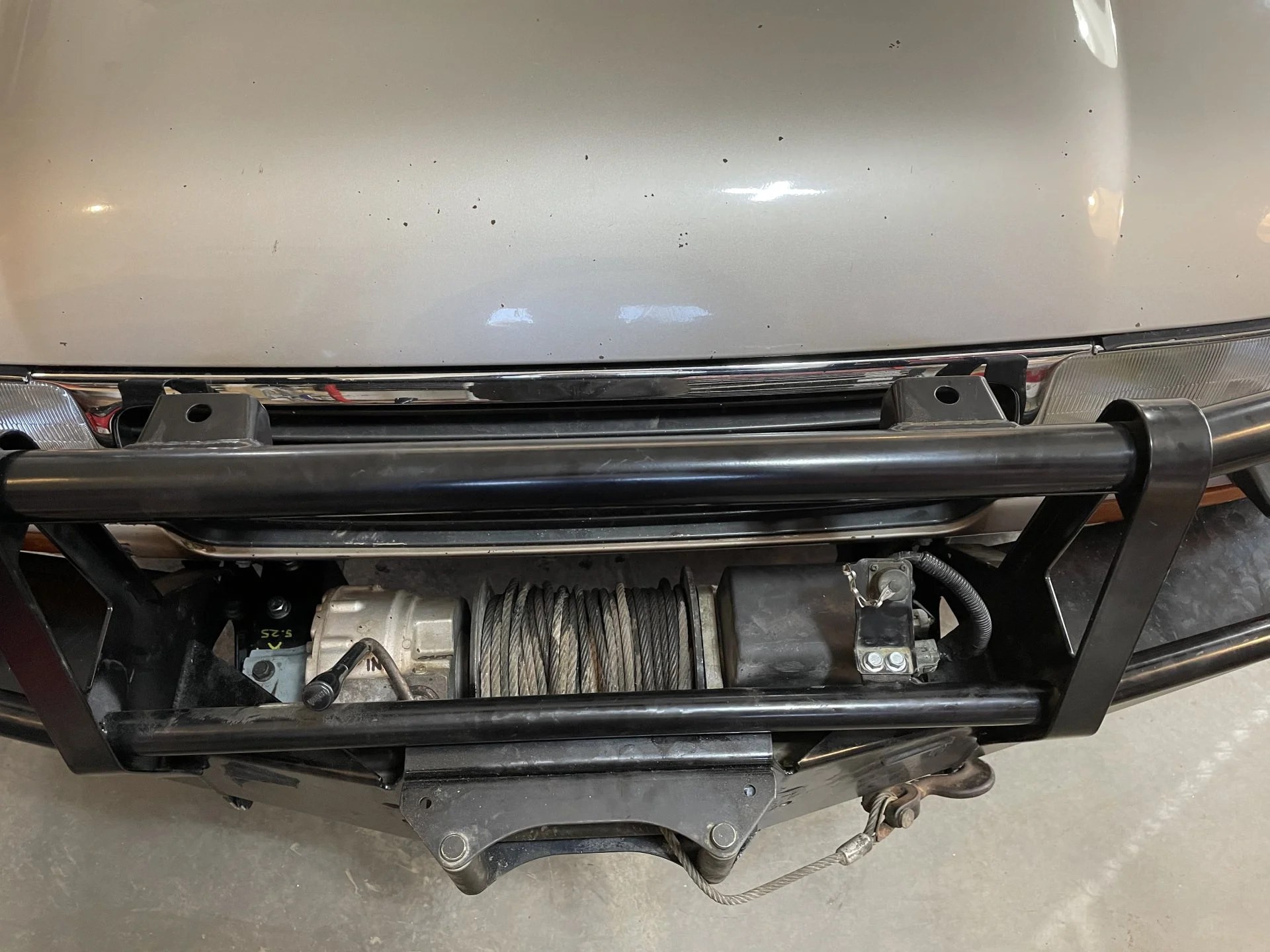

Next, on the truck.
