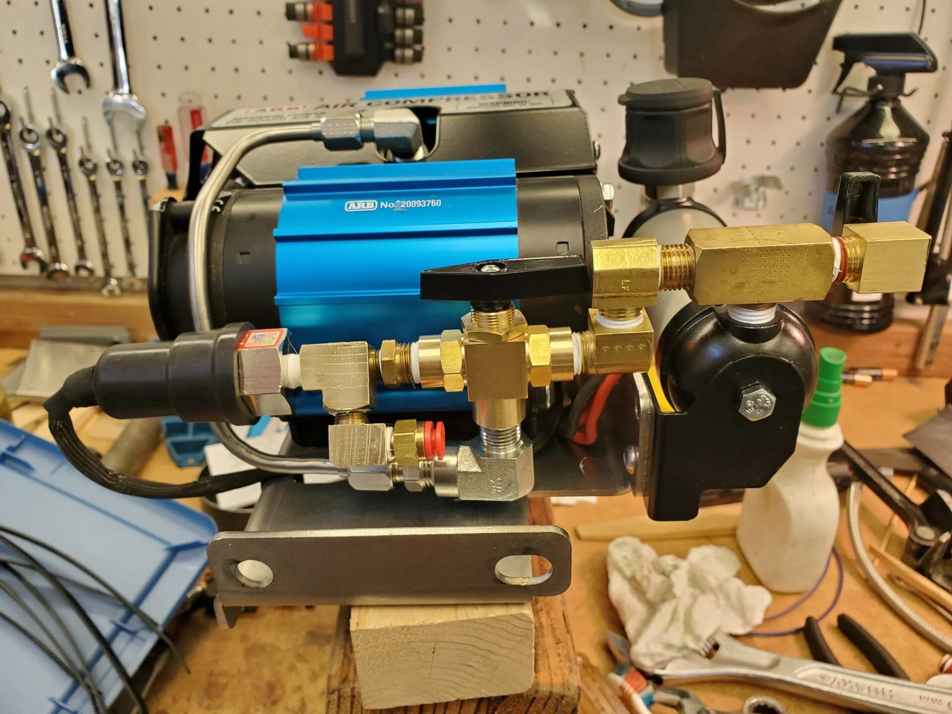

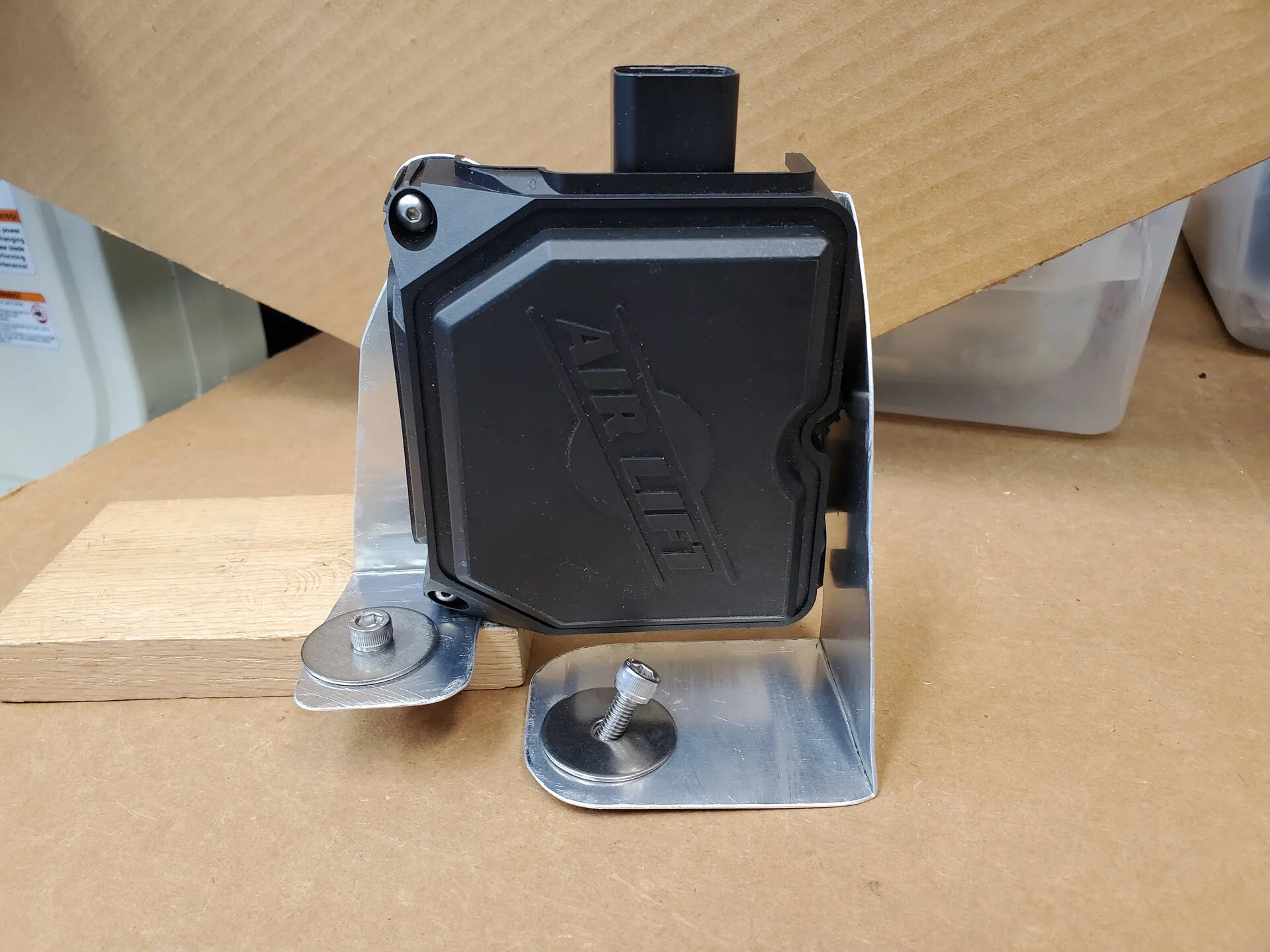

I put a hand 3-way valve to run the outlet of the ARB to either the air bags (pressure limited with cutoff switch) or the small accumulator and connection for the air hose (+100 psi limit). I mounted the airlift controller in the engine bay on the left fender near the firewall (tight fit, but made it work) with some DIY Al Brackets

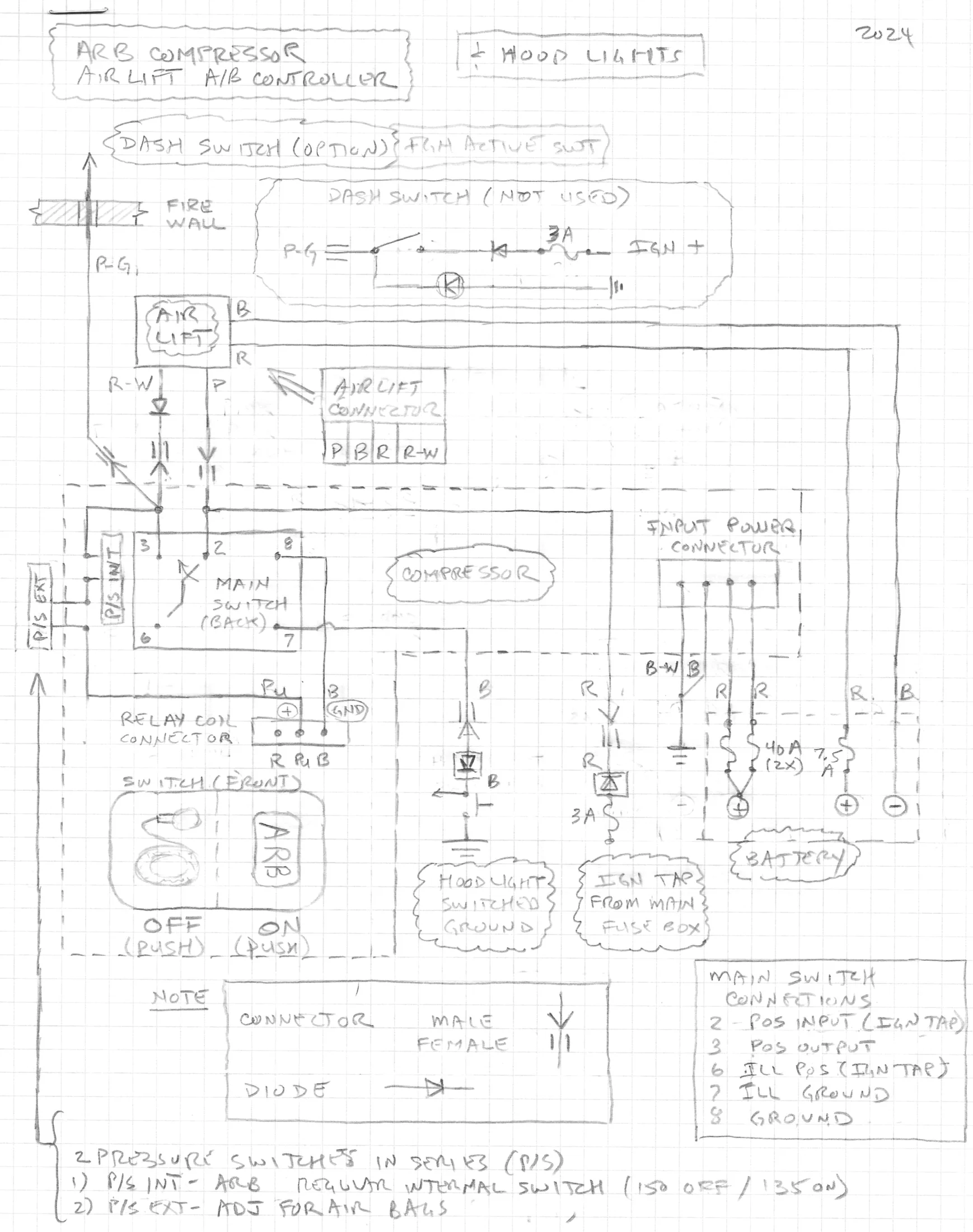

I do have the Gen2 wireless with the wireless remote (I don't really use the phone app, just the remote control). I have never gotten a compressor fault error. This is my schematic for connecting to the ARB compressor switch. I did put a diode in the line, maybe that prevents the fault code.

Thanks @LC Mike
I see you have the WirelessOne (https://static.summitracing.com/global/images/instructions/air-mn-1013.pdf)
I have the WirelessAir (https://www.xtremediesel.com/manuals/Air-Lift_74000EZ_Install.pdf)
Your system switches the conpressor on the positive wire, where my system switches the compressor on the negative wire... If I try to switch a relay instead of a compressor, then I get and error on my system as the relay does not draw enough current for the system to recognise a "compressor" installed (or sees the compressor as faulty).
I have ordered a load resistor which I'm sure will rectify my problem.

I managed to get it working using a 6ohm 50W load resistor. I'm also using a timer delay relay in parallel with this resistor to switch on the ARB compressor. The reason for the delay timer is because the WirelessAir system gives the compressor a "soft" start up by pulsing the 12V output to the compressor during the firs second or 2 of startup... The delay timer is there to delay the ARB compressor to only start up once these "pulses" has stopped.
I mocked up the system, and all works without any errors now. Now I will go ahead with the permanent install.
