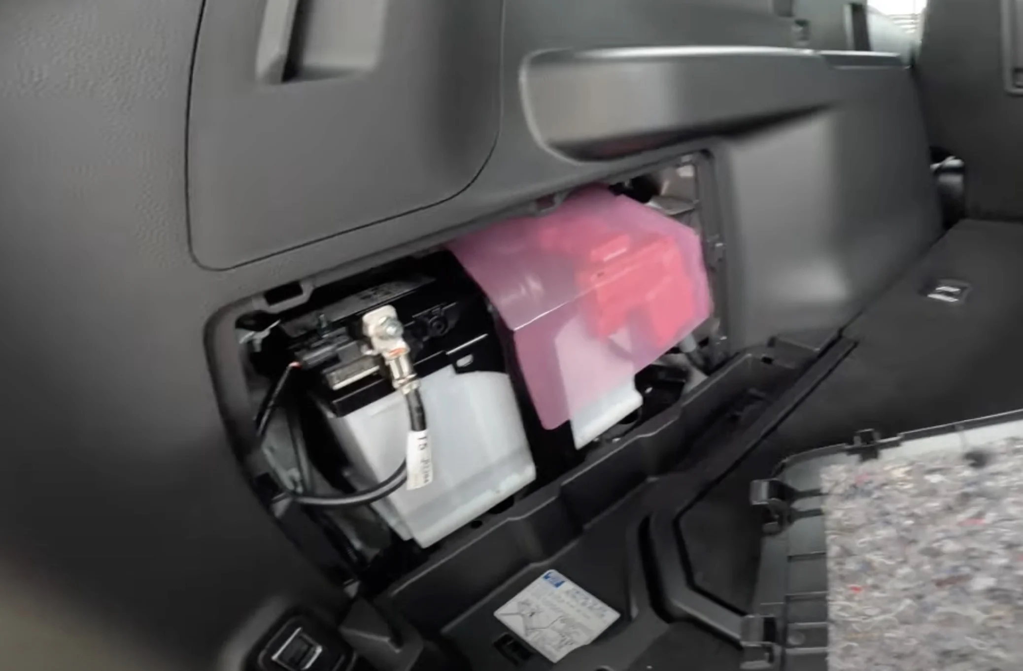

Just wondering what folks are using to air up tires after airing down for the trail. For my FJ40, I use a Lasfit 12V portable air compressor. The power cables clamp to the battery. We just purchased a 2025 Land Cruiser. The battery is in the back. The minus terminal is easily accessible but the positive terminal is not. There is a rather large red plastic cover the positive terminal making it inaccessible.
I want to be ready when I hit the trails with the LC250.

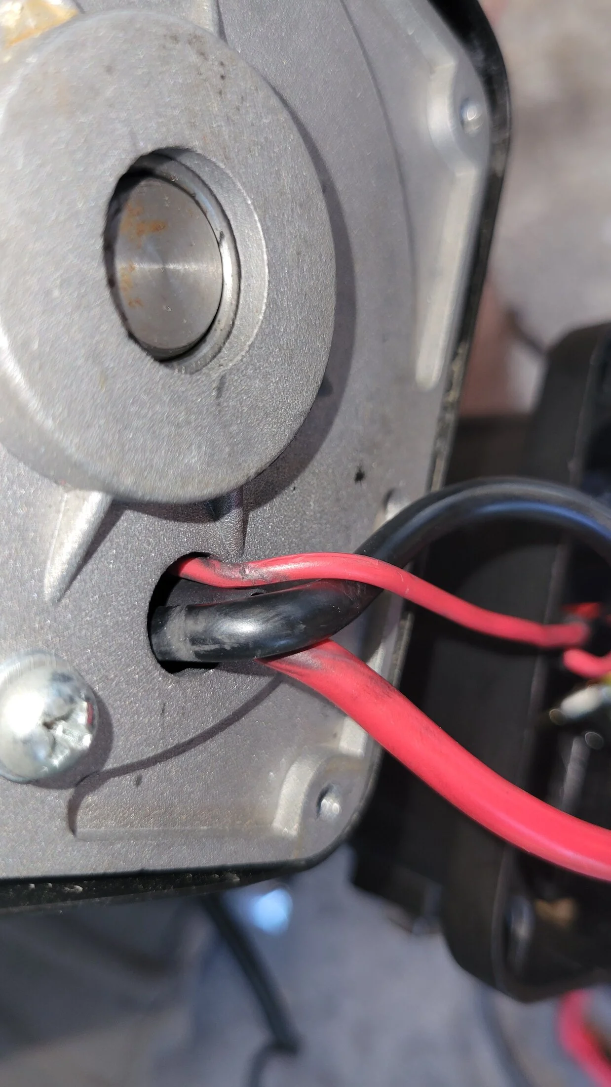

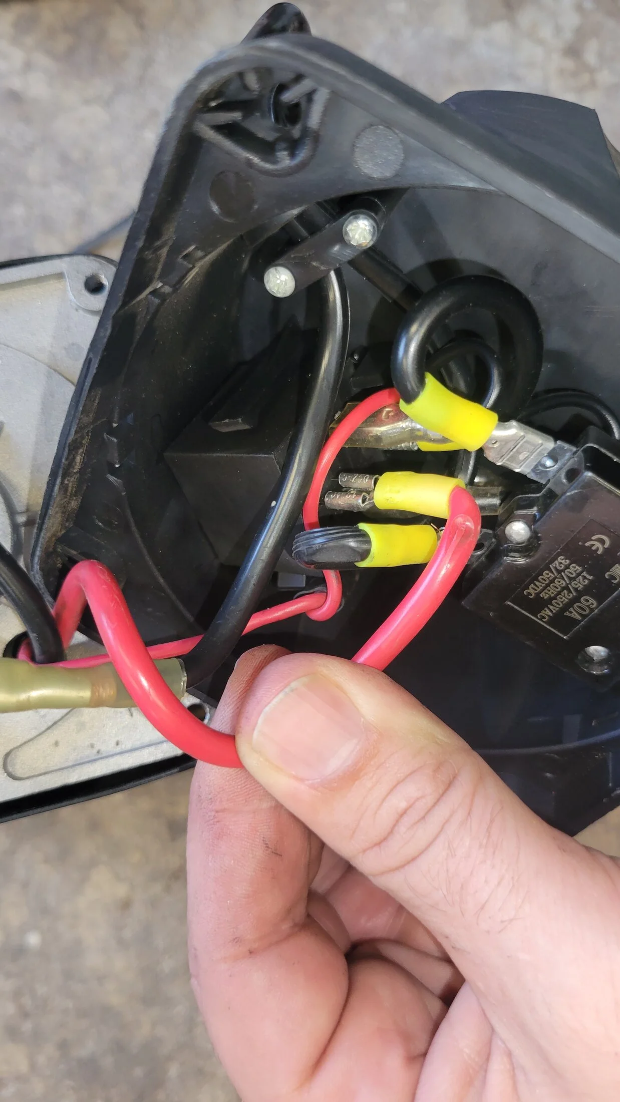

I didn't realize the Lasfit compressor appears to be one of the Chinese dual heads. If you have this one, it has a max draw of 90 amps - yikes. You'll need to be very careful even semi-hardwiring that to your rig with an Anderson connector to operate it safely. I would use no smaller than 4 ga wire, with a 100 amp circuit breaker very close to where your cables tie into the rig's battery. Otherwise, smaller than 4 ga wiring might get very hot, and there would not be a device to automatically disconnect the circuit during an overload or short-circuit condition.
If that compressor has anything smaller than 4 ga wire leads on it, I'd get rid of it ASAP and get something that is safer to use. They don't seem to call out the wire size specs, but they sure look smaller than 4 ga in the photos. FWIW, I have 6-ga wire running to my ARB twin, which only has a maximum amp draw of 70 amps.

This is how I would do it. Looks like a some other folks have done this. It would be nice if Toyota had provided a direct battery terminal post to each pole under the hood. Battery location isn't ideal for things like winches, snow plows, etc. But not insurmountable. I have a Smittybilt that's been my go-to for around 10 years at this point. Only issue it's had is the hose sucks, so I replaced with a high quality 30 foot hose.
I hate to continue to be an electrical naysayer, but for a hookup like that it would be good to have some extra sheathing on at least the positive wire. After all, it's buried behind a plastic panel and will be subjected to tens of thousand of miles of rubbing. Having a 6-ga cable direct to the battery shorting out on a sharp body panel edge is not a good outcome - even if a circuit breaker is installed (though, kudos to the installer for at least using large-gauge wire).

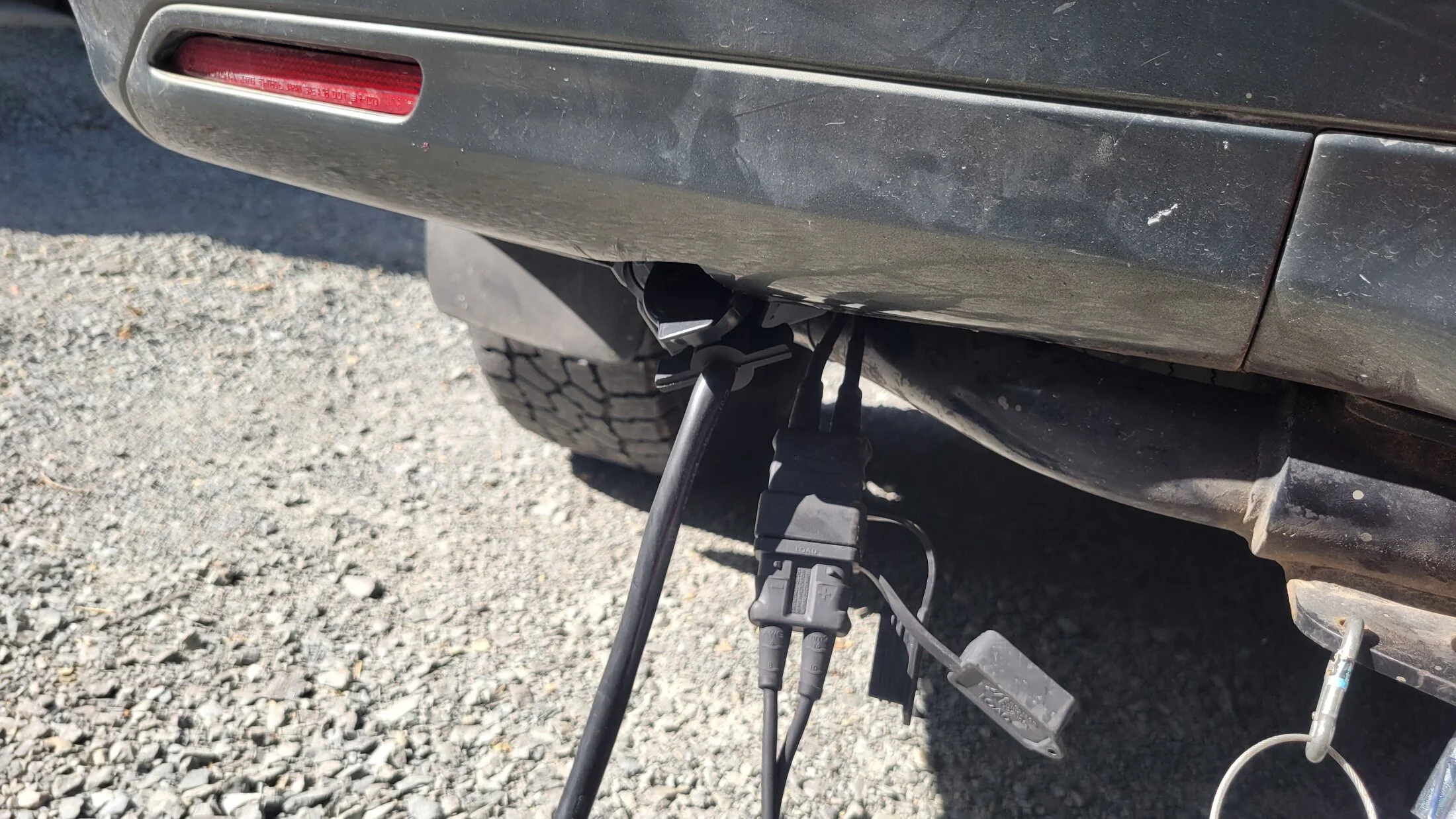

Here is how I did a pair of 10 ga Anderson connectors to power my camper fridge off the alternator of my GX. This uses a Anderson environmental boot over the connector, and the wires are double-insulated all of the way to and overlapping each boot with heat shrink tubing. These wires are under my rig and exposed on the camper tongue, where there is a lot of rubbing and potential for water-related issues. Inside the interior of the a rig, braided or corrugated sheathing would do fine, although I'd still recommend the environmental boot or another type of enclosure to reduce the potential of accidently shorting the connector (which does appear to be in use on that photo).

Here is how I did a pair of 10 ga Andersons to power my camper fridge off the alternator of my GX. The hot and ground wires have their factory insulation plus a second layer of sheathing (heat shrink tubing here) from the bus bar I have them hooked to all the way to a weatherproof cover that slides over the connector body.
Or, one can use braided or corrugated sheathing - both of which I have used in other applications on my rig.

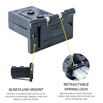

I have no idea what's behind that panel. Just a picture I found on the google machine. I'd sure hope they at least have a fuse or breaker on it. On my own junk - I'd use one of these type of flush mount receptacles with a door so it's nice and tidy.
It's only 18" of cable. Flush mounted connector and zip tied cable is all you need.

There's already a fusible link with an extra terminal for you. Mount the Anderson Connector on the access door or any of the plastic trim. This is a temporary connection. When you use your compressor with battery clamps, are you adding a fuse right at the clamp?
I do normally sheath all my wiring because I have so much of it in both braided and split loom but this is literally a battery on the other side of a plastic panel.
