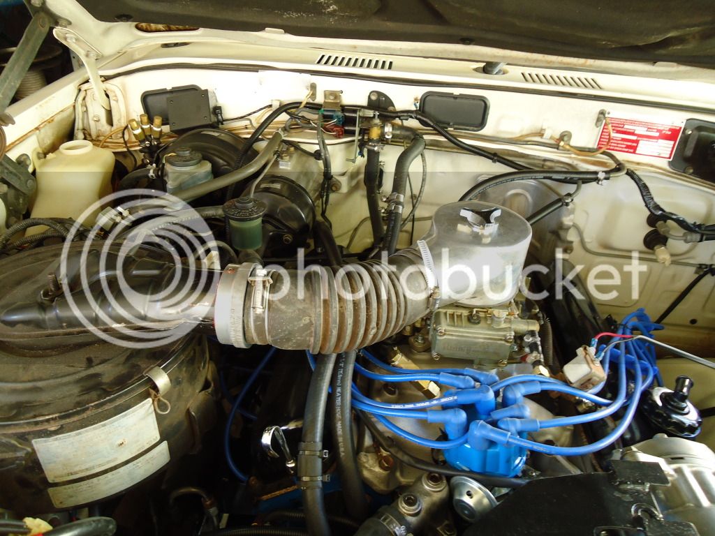

The FJ-62 filter assembly sits on the passenger fender liner with a hose between it and the 3FE's throttle body. No reason that you couldn't use one and duct the filtered air over to the TBI unit.
This one is an OZ 3F with what appears to be a dual-fuel propane mixer in the hose:
Pic of how the top of the TBI unit can be handled:
