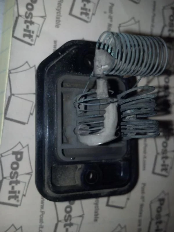

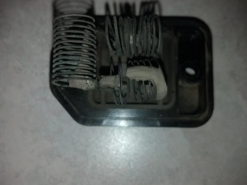

Blower resister replacement :)
These first 3 pics show how the old resister was broken on two coils. and the last of the three show a comparison to a new one. This is the resister for a 91 pickup that has the 4 lvls of air. The last picture shows the resistance of the coils, just in case someone wanted to make their own.

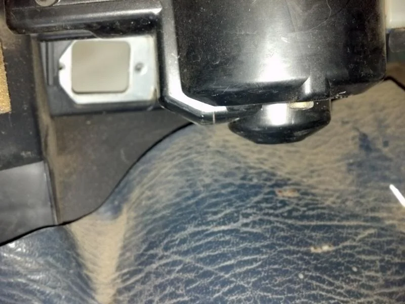

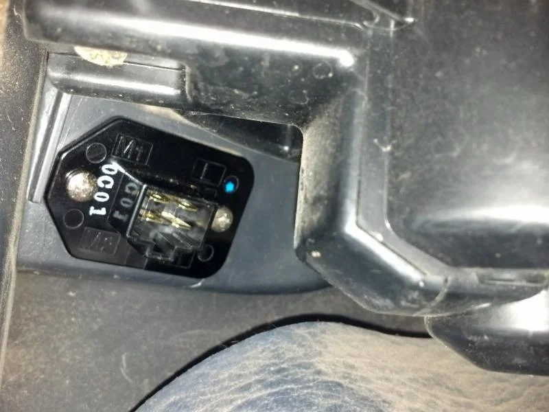

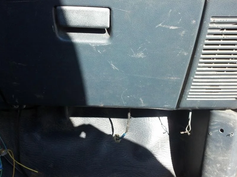

Blower resister replacement - Location
For those of you/us that have never done this before and wanted some pics of location and what the heck you are looking at/for.. this is for you.
The resister needs to be cooled in the ducting, and it downstream of the blower motor, about 2-4 inches down. if you are big like me its annoying to do without pulling out the 4 screws for the glovebox. Possible to do without pulling, but oh dear god so much easier.
The hanging cable in the first pic is the 4 wire plug that goes into the resister. Second pic shows the location without the resister, and Third pic shows it installed but not plugged in.

I also just wanted to note a couple things about those pictures. The breaks were in the wire, NOT THE WHITE COMPOUND. That is a thermal spreading ceramic compound that holds the wires in place. after heating and cooling hundreds/thousands of times and the constant vibration of the truck, the wires would break far too easily. Thus some "glue". I got some parts from a kid who had just rolled his truck, and his was broken from the accident. Too much good vibrations i guess.

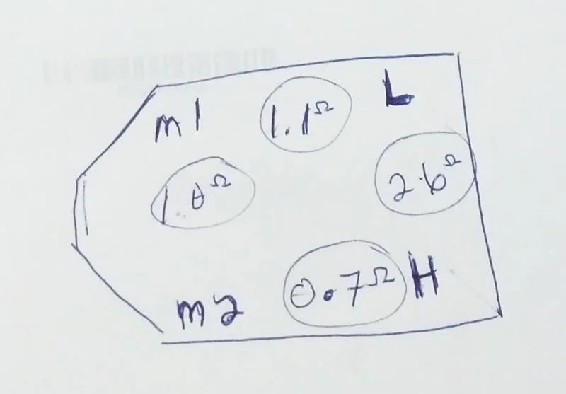

Here are the resistances between contacts. ( in ohms, i dont believe it was anything like mega or kila.. just plain jane ohms)
M1-L= 1.1
M1-M2=1.0
M2-H= 0.7
H-L= 2.6
