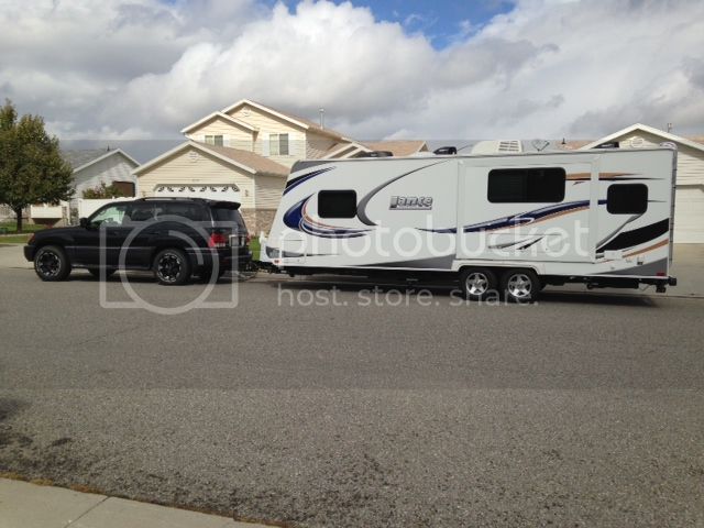

Picture below shows how low my LX was with the Travel Trailer Hooked up.
As seen, the AHC would stay on ‘L’ while the coil spring bumpers took the beating in support of the whole weight against the axle.

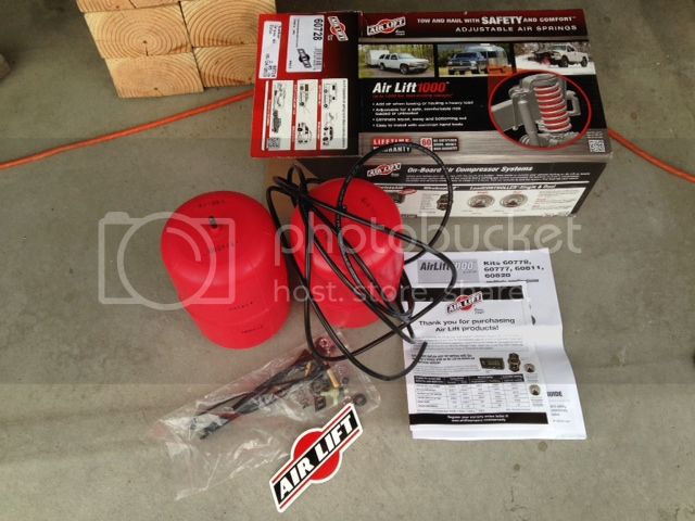

Anyway, after much speculation back and forth, I decided to go with Air Lift1000 Air Bag system.

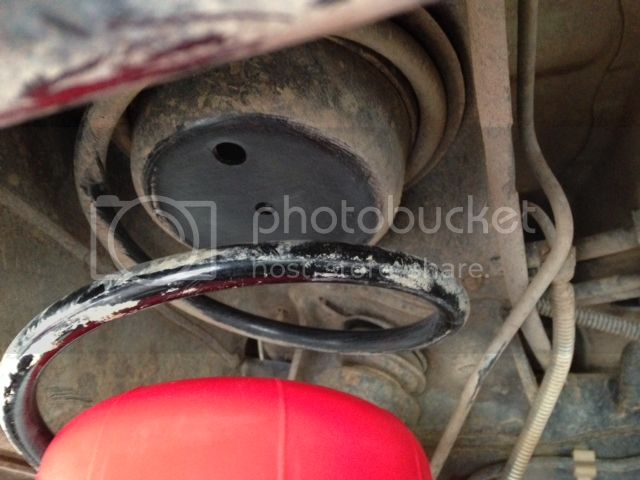

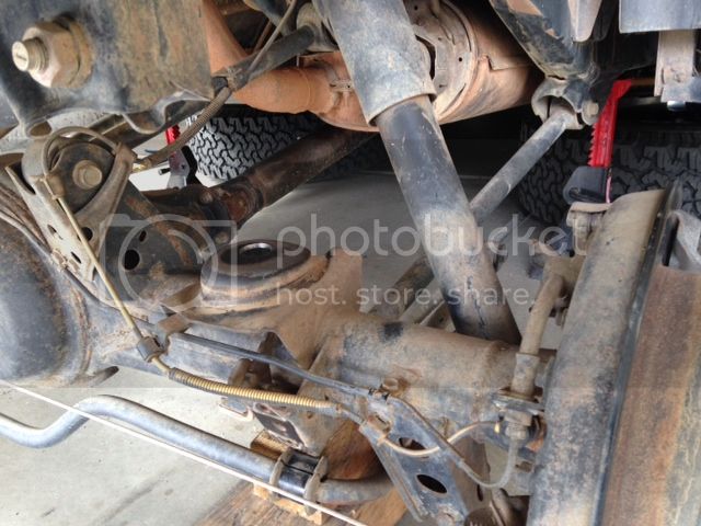

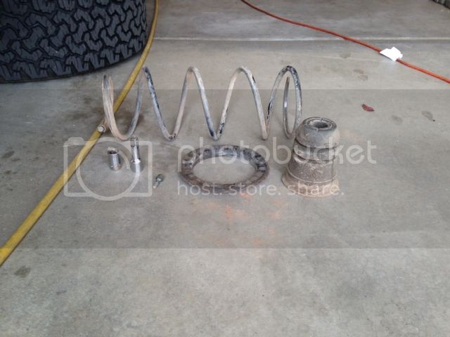

I dropped the passenger side axle, removed the shock absorber lower bolt then the coil springs slide out very easily.

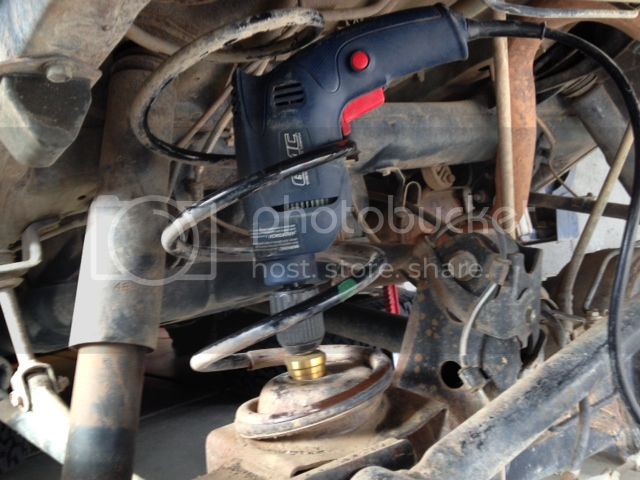

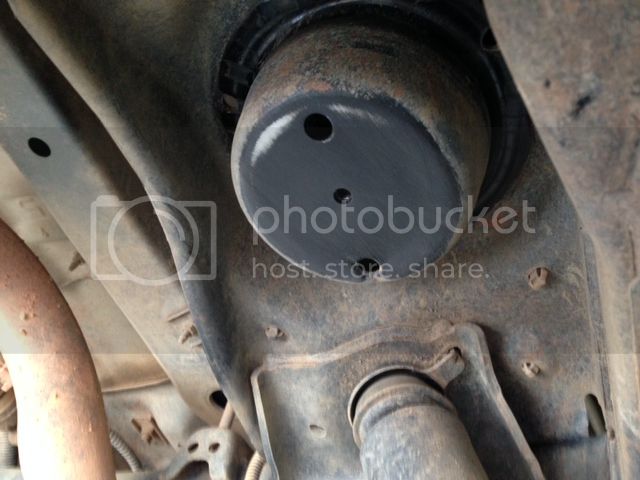

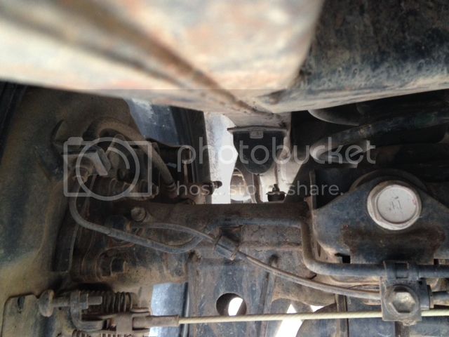

As for the driver side, I thought it would be much easier to leave the coil spring in place. So I simply removed the bumper stopper then somehow managed to get the hand drill on there without disassembling anything.

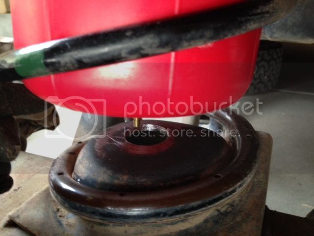

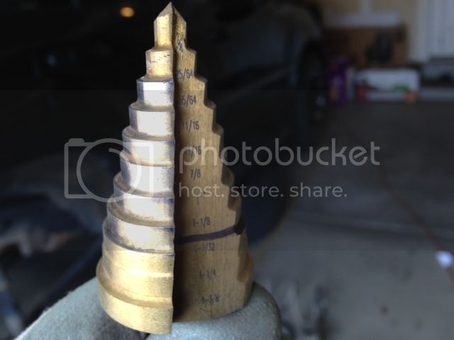

Also, with the help of a step drill, I created a larger Air Bag nipple opening (1-1/32 to be exact). In a folded position, the bag effortlessly slide right in between the Coil Spring.

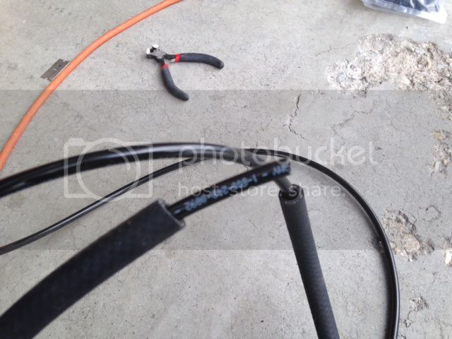

For added protection, I inserted the Air bag kit tubing inside a ¼ Rubber Fuel Hose. This way, heat or any other elements would be mitigated from possibly destroying the tubing.

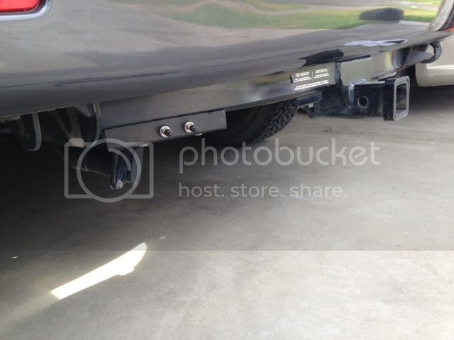

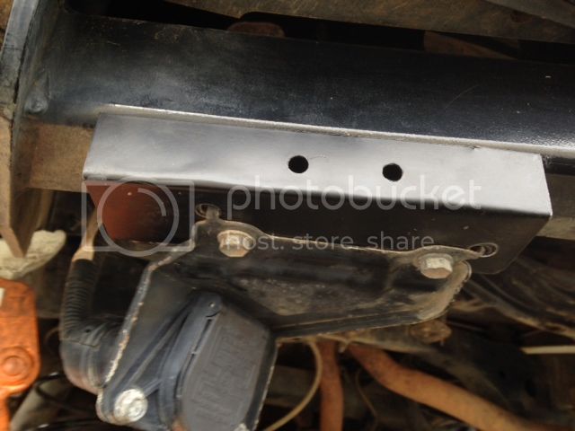

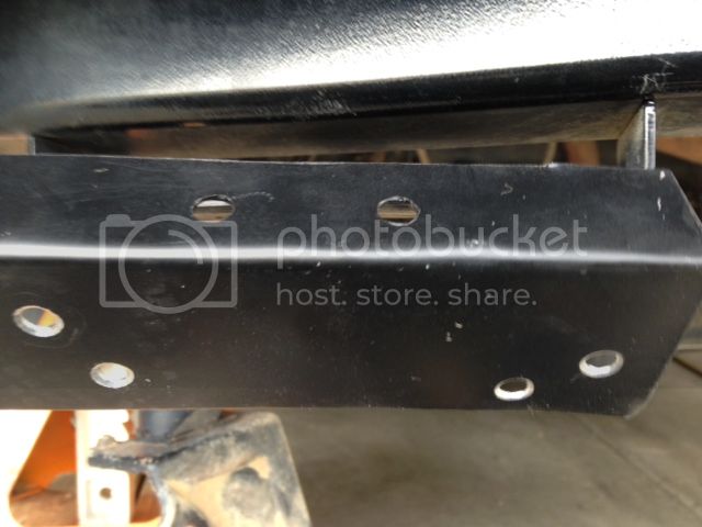

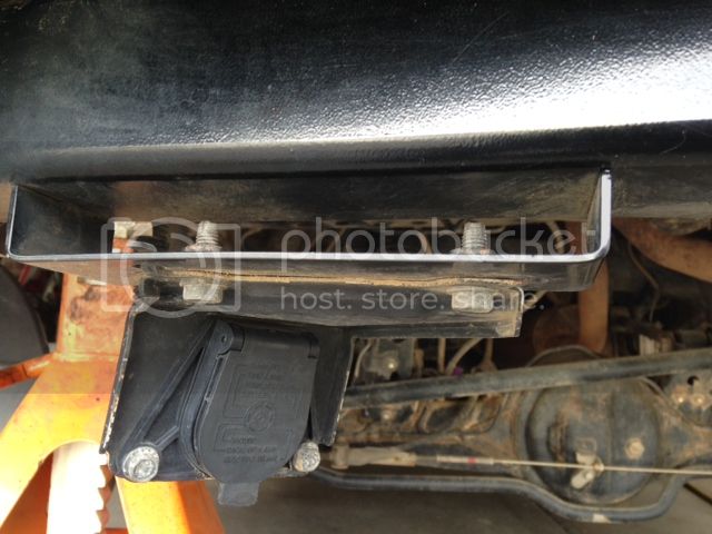

As for the two Schrader valves, I created a special plate that attaches to the 7-pin Towing Adapter bracket.
With only 18psi on each bag, the truck is 100% level with my Travel Trailer. AHC now has the support it needed and has stayed on ‘N’ ever since. Handling is much better on those curves. I have towed this trailer for over 1000 miles now with the current set up and I couldn’t be happier.
