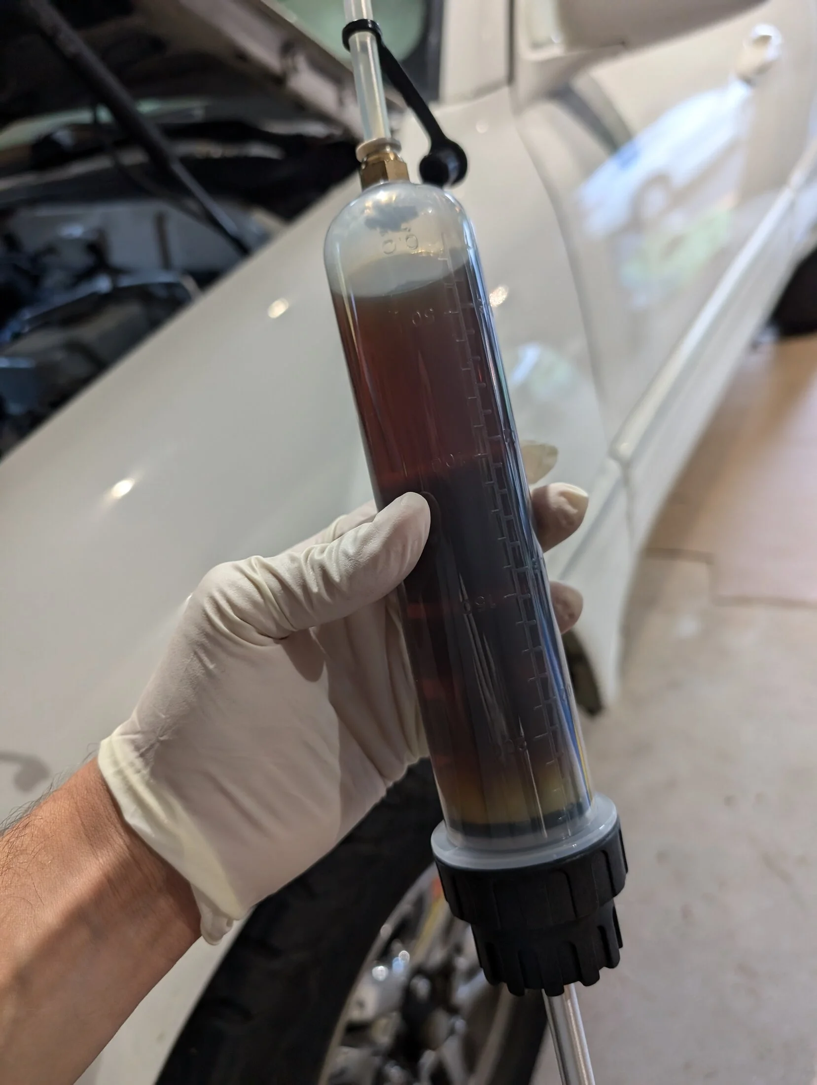

1. Get the car on a level surface and into L. This helps fill the under-hood reservoir so you can extract more with your hand pump/Turkey blaster. (For $14, there's a killer little syringe that made it this part effortless and mess free. The cheap-s*** pump with red tubes from AutoZone or whatever are a total waste of money.)

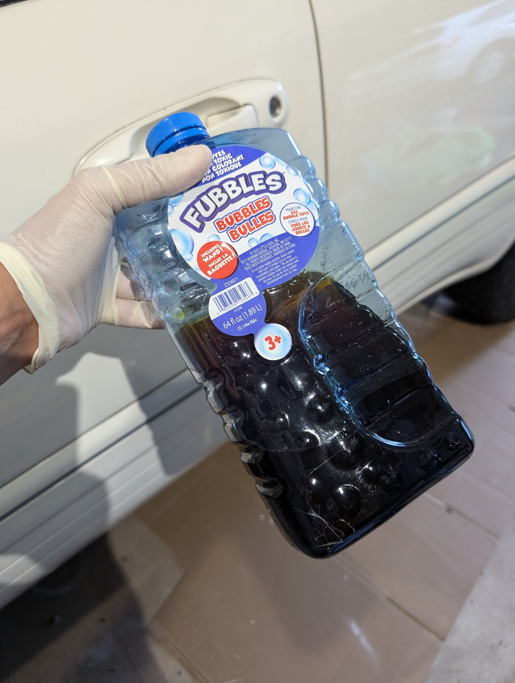

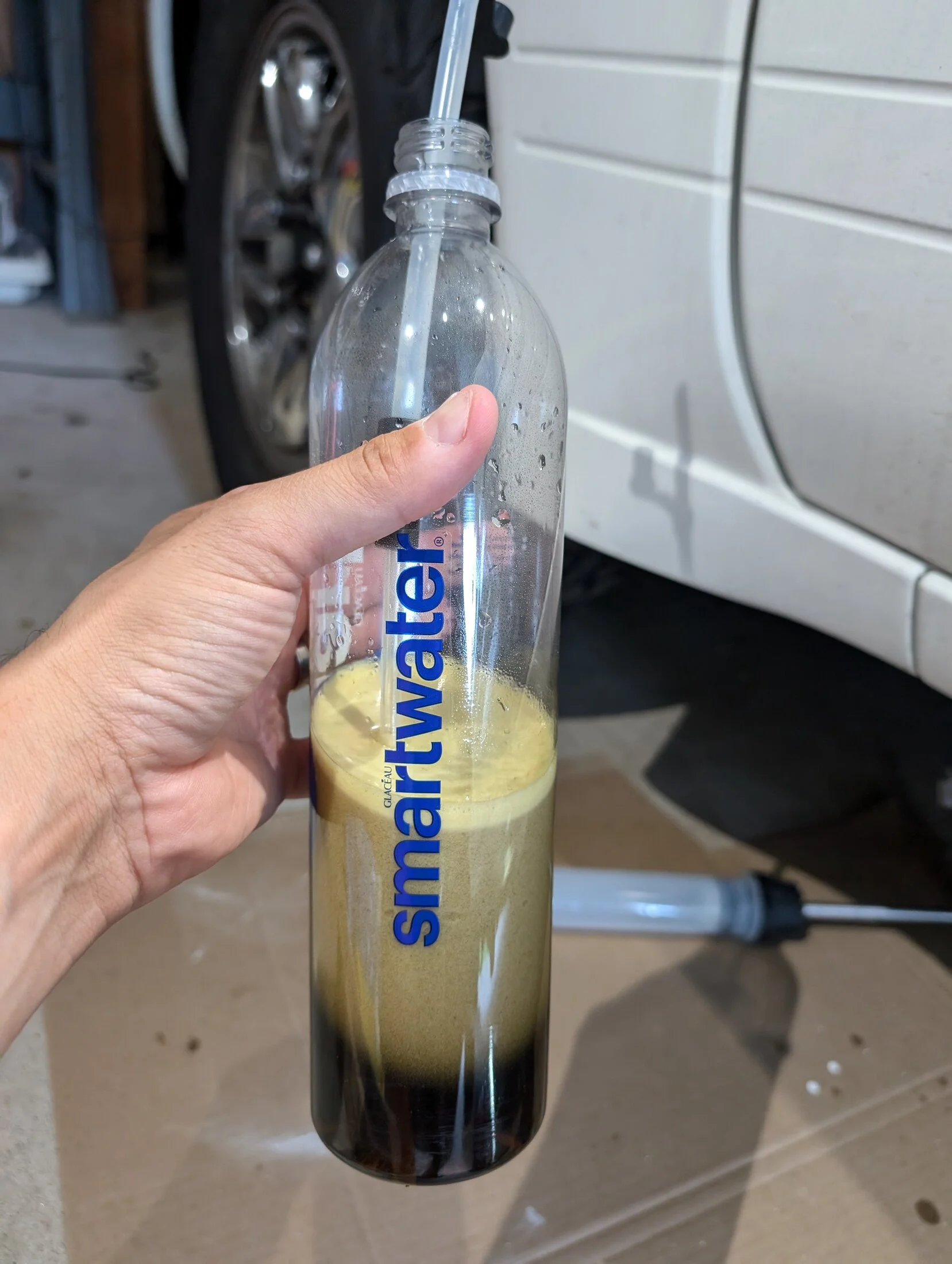

2. Bleed! 10m to each corner "globe" bleeder valve and the accumulator on the driver's side frame rail. My discharge of the old black/green fluid looked more like a frothy drink from Starbucks than something that would come out of a car.

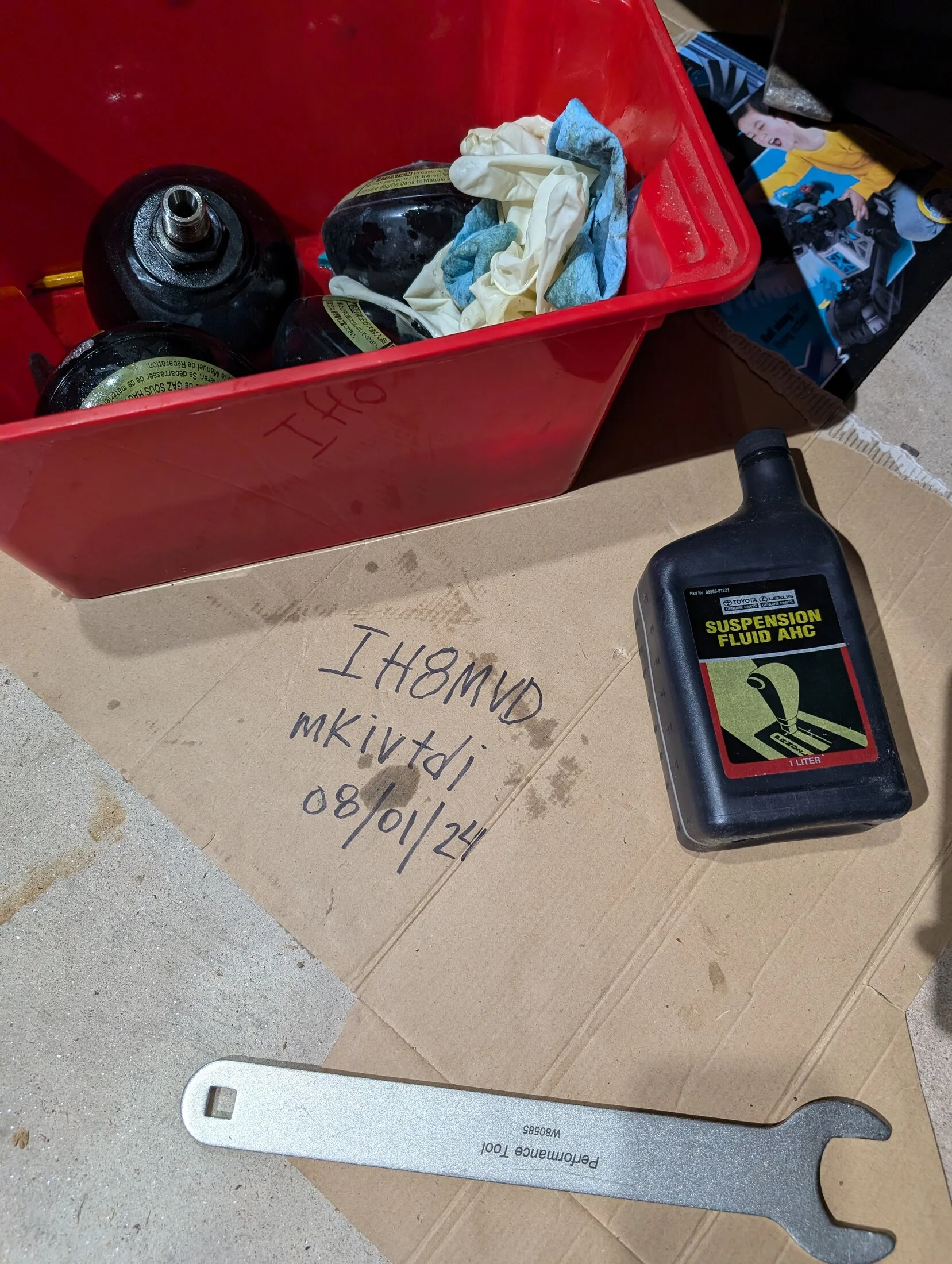

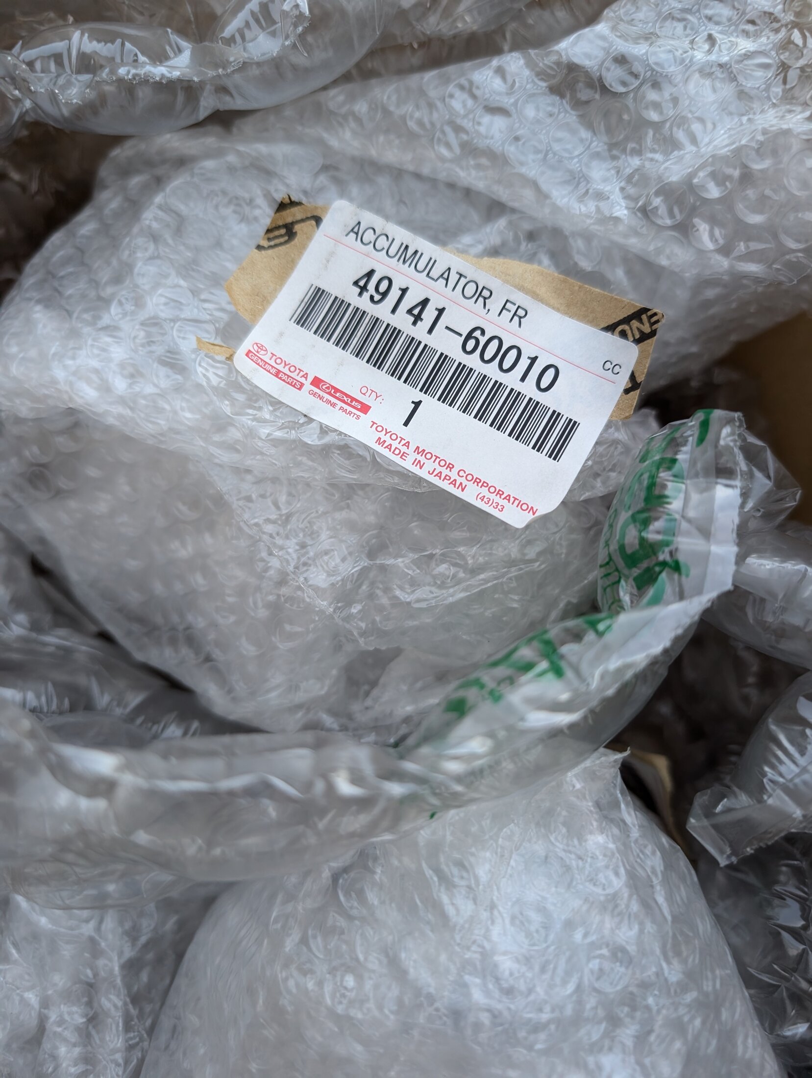

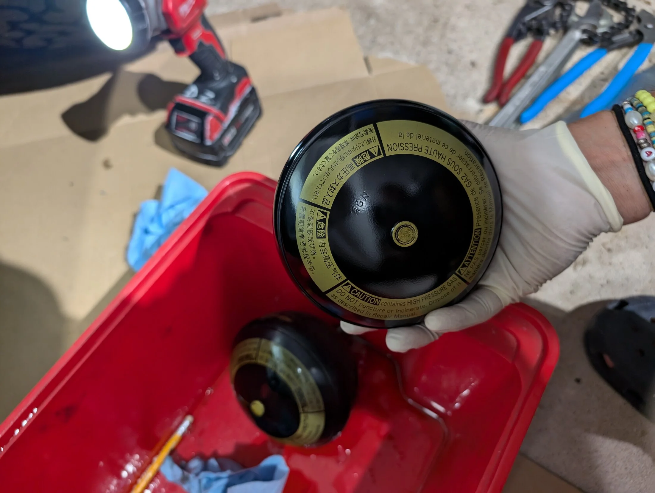

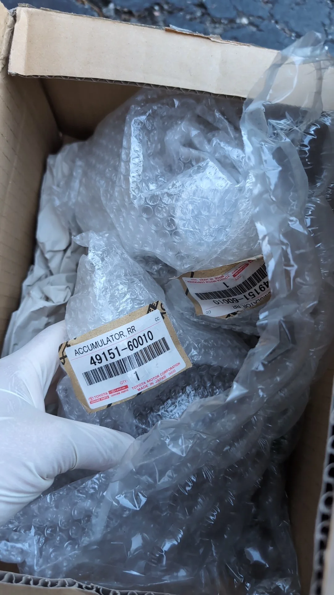

3. Remove old globes. A 36mm fan clutch wrench was all that was needed. Replace with new globes, note front/rear difference via part number. Also, lube the oring with some fresh AHC fluid before tightening back on by hand. Snug up with wrench.

Extractor from Harbor Freight I mentioned ^^
^^ Almost each corner came out black and frothy.
^^ Rears PN. Fronts posted in 2nd post.

I am using a 36mm fan clutch wrench. The other 3 were easy. Strap wrench gives too little torque.

I got the final globe off. I had to rent the beefy wrench from O'Reilly that was thicker than mine.
