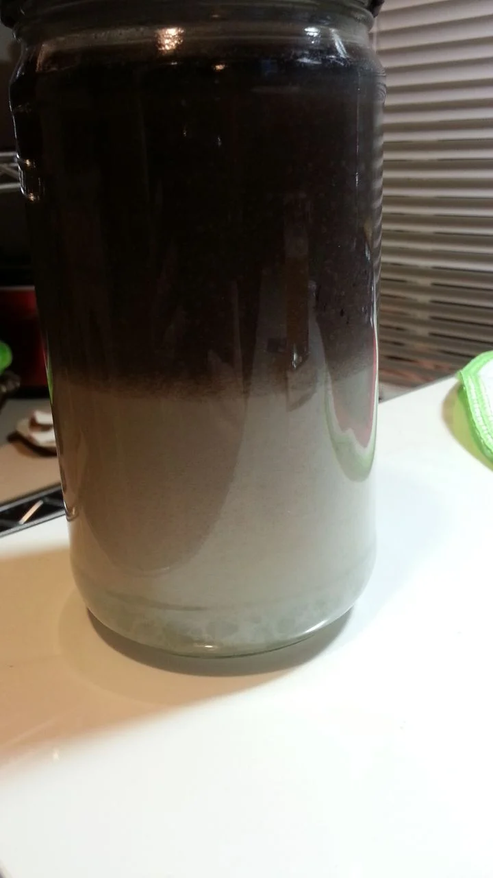

Saturday I flushed my AHC system. What came out of the reservoirs and the spheres was a dark greyish/black. I ended up using about 2 cans of fluid to flush everything until the point it was a consistent pink/red just like out of the can.

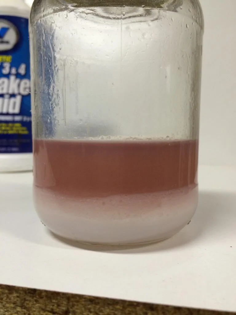

It's difficult to accurately assess the color of the fluid whilst it's in the reservoir so I'd drain off a couple of ounces into clear jar and look at it in daylight. The fluid starts out pink/rose (it was a clear/strawish color before 2009) changes to red as it ages and with use and age can end up a deep cola/caramel color. The term "flush" is used pretty liberally here - changing the fluid in this system is basically a drain and refill, there is no recirculating it's just a reservoir at the top with four dead ends at each actuator, fluid moves back and forth but doesn't recirculate so it's impossible to remove 100% of fluid when you drain and refill. If you suspect your system has been contaminated with brake fluid you can do a water reactive test. Into a meticulously clean detergent free jar drain 3 or 4 ounces of fluid off from your main height accumulator, add half the volume of your oil with distilled water, agitate to mix and let stand for 5 minutes. After 5 minutes you should see a clear delineation between the water on the bottom and the oil. There will be a thin froth interface between the two but the water must be clear and this indicates the oil sample most likely has not been contaminated. If the water is milky and there is "scum streaks" on the glass jar this suggests the oil is contaminated. Here is what a sample of 6 month old oil looks like with water added, and the same sample with a few drops of brake fluid.
Thanks for the replies,
I was not able to smell the suspension fluid but will post back with the(hopefully favorable) test result as pictured above. Nice little test.
Just to confirm: AHC fluid should be clear or rose is the color when new, no other colors like blue or green? As it ages it can turn dark which is fine unless it changes to grey, brown, black -which would mean it's time to drain & fill? Thanks a million guys.
Adrian

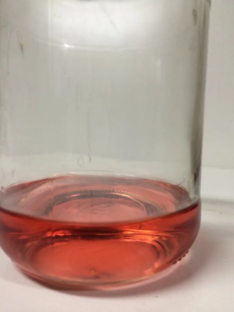

This is what new fluid looks like, pink. The only other color I've ever seen is clear/straw pre 2009. Definitely not green or blue. It darkens with age and can look horrible if it is years old. The book says to change it every 60k miles but I prefer to change mine at half that distance. The reason the water reaction test works is that the mineral oil based AHC fluid is hydrophobic - tends to rejects water and brake fluid DOT 3, 4 is hygroscopic - tends to absorb water, hence the cloudy water if brake fluid is present in the sample.

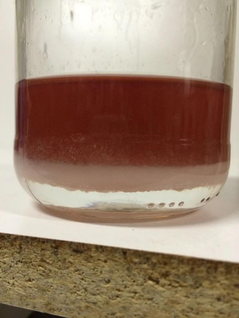

I managed to get my hands on a $50 tin of AHC fluid and a flavor injector. Pictures attached. Unfortunately my fluid is looking milky under the line of "old fluid stuck in the system mixed with new". I distinctly remember the fluid having a tint of dark blue/green before they drained and filled and charged me for a flush.
I can't just yell at the service adviser because he already has demonstrated he's not knowledgeable on the matter... Buy a bunch more fluid and flush like mad?
If this was your LX what would your next steps be?
Flush as described.
Yeah, if it had any blue coloration to begin with, it could be that you had been "lubed" by someone in the past (i.e., some idiot at a quick oil change had filled your AHC container with washer fluid.......however, if your reservoir was still at an "appropriately full' level, that's probably not what happened. In that case, I have no idea what would have caused a blue tint to your fluid)
