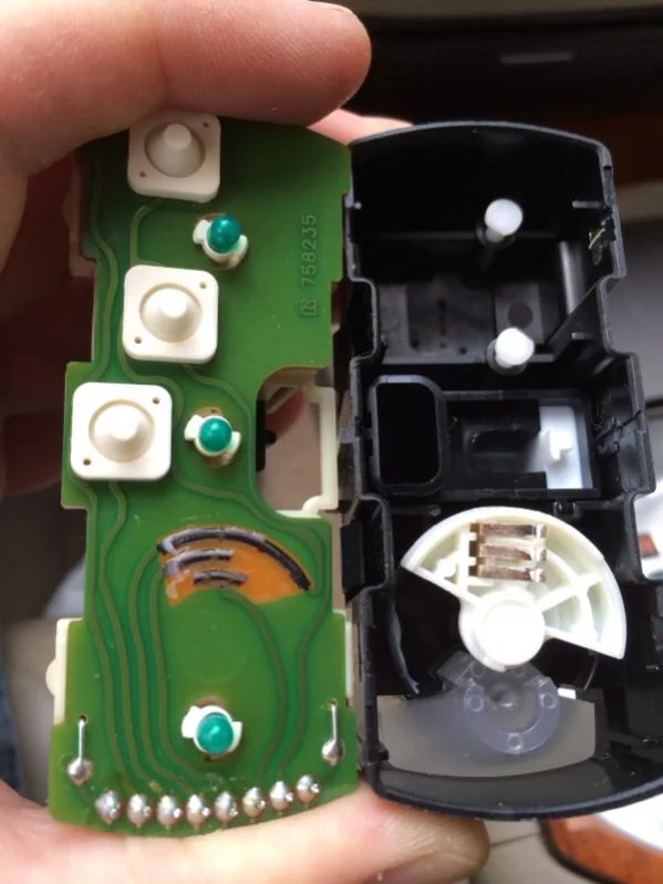

I feel for you, you've worked this issue pretty hard! Your fault finding and elimination points to the four control dampers not stepping thorough their four positions, they have four position stepper motors that shuttle the damping control valves through their 16 positions. Easy to check and clean the four position switch, it pops out, it has a three finger slider that contacts PCB tracks. I pulled mine, degreased the contact surfaces and cleaned them up with an eraser. 10 minute job, someone posted on the UK TLOC site that cleaning these contacts fixed their issue. Worth a shot.

How to pop this out? Thanks
How to pop out the damping control switch? If you pop out the whole panel first, it's easy. The panel can be lifted straight up, held by 4 clips. Read the FSM. (RTFM :) )
