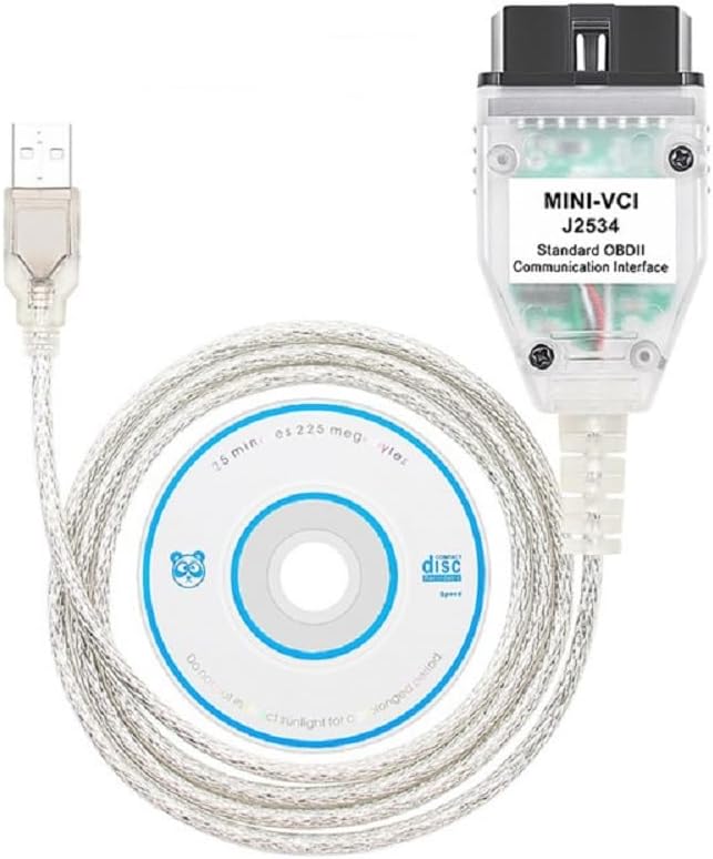

Buy cable off Amazon/eBay/Etc. "Mini VCI J2534 Cable" Its just an OBDII to USB cable.
Looks like this. Cable may or may not be clear.
Mine was like $30.
DO NOT USE THE SOFTWARE THEY PROVIDE. Its full of viruses and s***.
Install the stuff on an old junk laptop. Win 10 or older if you can. Bought a refurb Dell of Amazon for like $120.
Mine was like $30.
