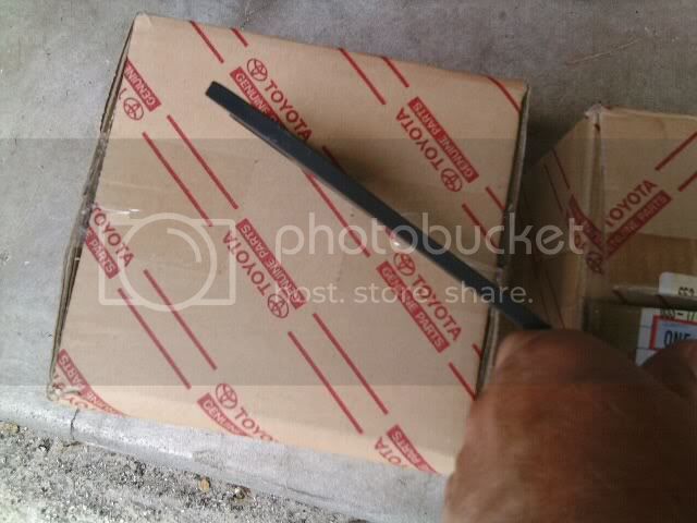

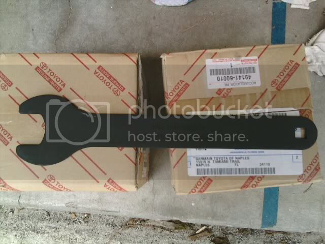

Here is what I did. I went down to NAPA and picked up a 36mm fan clutch wrench. It fit perfectly!
side view
They had this in stock in a larger set and broke it out for me. If anyone wants to use it just shoot me an e-mail at v12mac at yahoo dot com (you can decode that, trying to keep the spam down) and I’ll mail it out to you as long as you send it back.

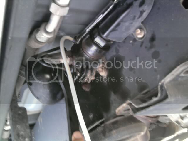

Drained off the pressure and remove globe.

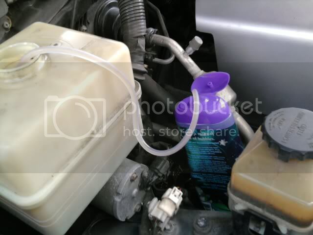

Didn’t have a turkey baster or syringe so I sucked out all the fluid I could get out of the system with this
The hose fit in the hole snug and I could squeeze out air and make a slight vacuum that would draw the fluid out. The hose only is in the top ¼ inch or so, that keeps me from squeezing any back out of the bottle.
Bleed out the system as much as I could. I really would have liked to have a 2nd can of fluid to really flush the system but the Toyota dealer only had 1 in stock. I’ll re-flush and bleed when I can get another fresh can. By the way I got the AHC fluid for 40 bucks at Lexus down from 70, and the accumulators from Toyota for 430 down from 636 at Lexus. Not too shabby.
