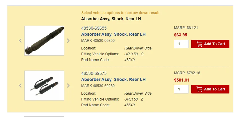

Rear (non-AVS) oem shocks are cheap and easy to install. Might want to try that first.
