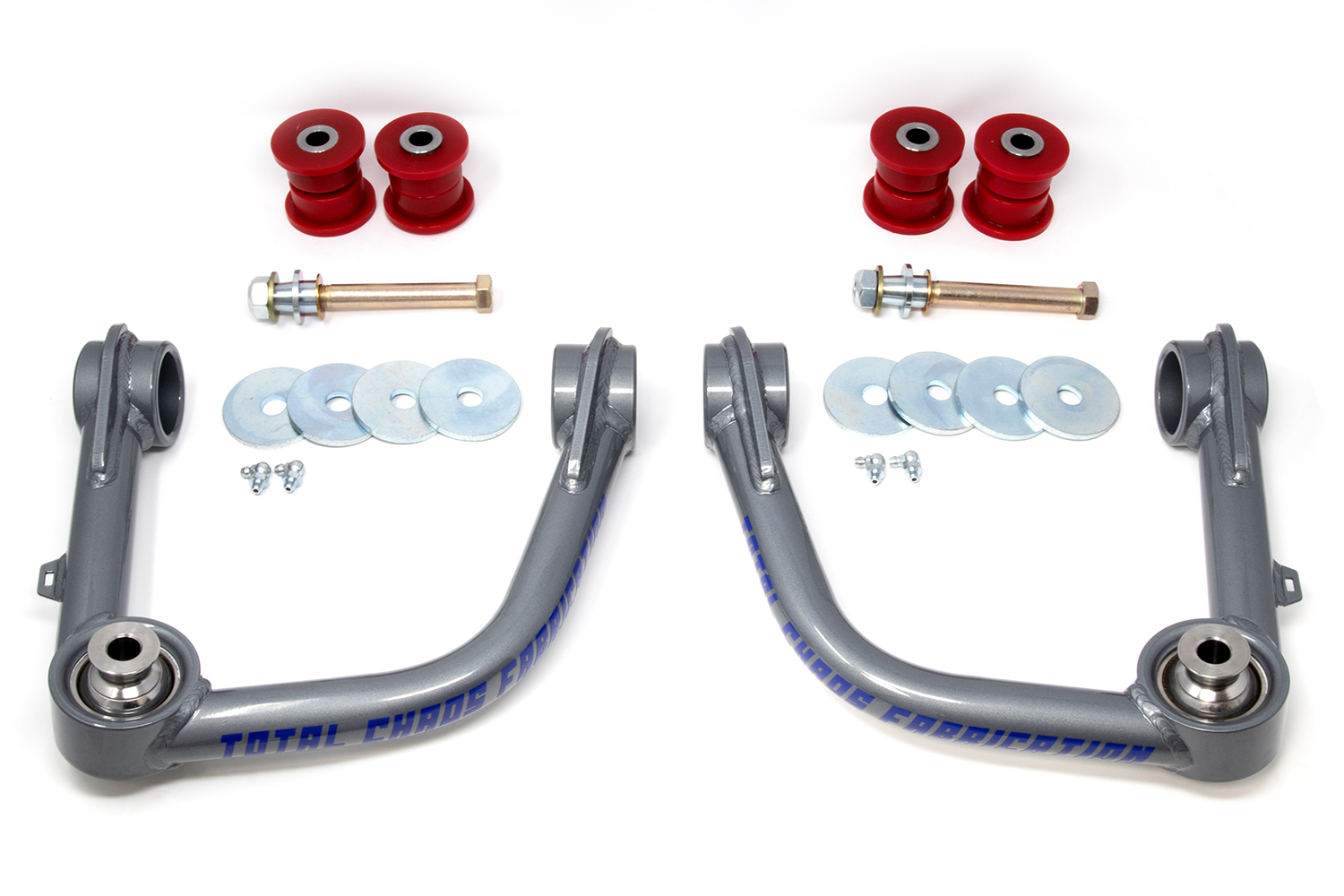

The whole idea of a performance aftermarket UCA was the brainchild of Matt, one of the two husband and wife owners of Total Chaos. They displaide them at one of the offroad expos in SoCall and had the owner of Camburg, laughing at them that "no one would ever buy those". Of course Camburg and now everyone under the sun have knocked off Matts idea since they work, and work very well.
In the past 5yrs there has been an explosion of knock offs that have hit the market all racing to the bottom with the lowest price. Just look on the Made in China sales sites from China and you will find most of the new "brands" supply origins. However in the past 10yrs there have been some legit actual improvements to the original design.
OG UCA's:
TC will always be the OG and do it right, and made in house by them in the US. Now days with custom US made stainless steel uni-balls. The $$ is always in the bearings. (Cheeper arms = cheeper bearings, TC uses the best bearings they can get! One reason the arms are not low cost)
