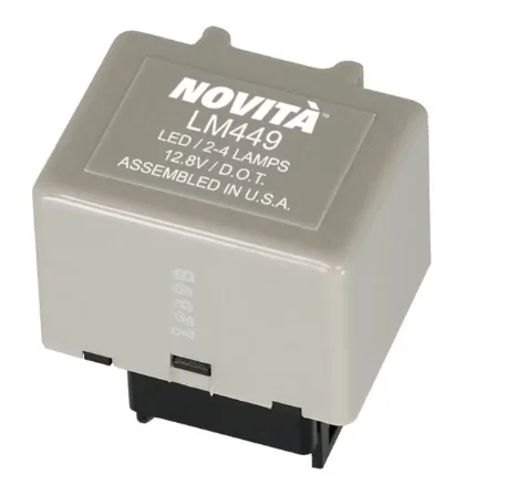

1. Novita Turn Signal / Hazard Warning Flasher LM449
The good: building quality is OK and it is backing up with autozone warrenty. you can find almost in any autozone store across the county
The bad: No any other functions added. For the one I tested, the flasher speed is too high.

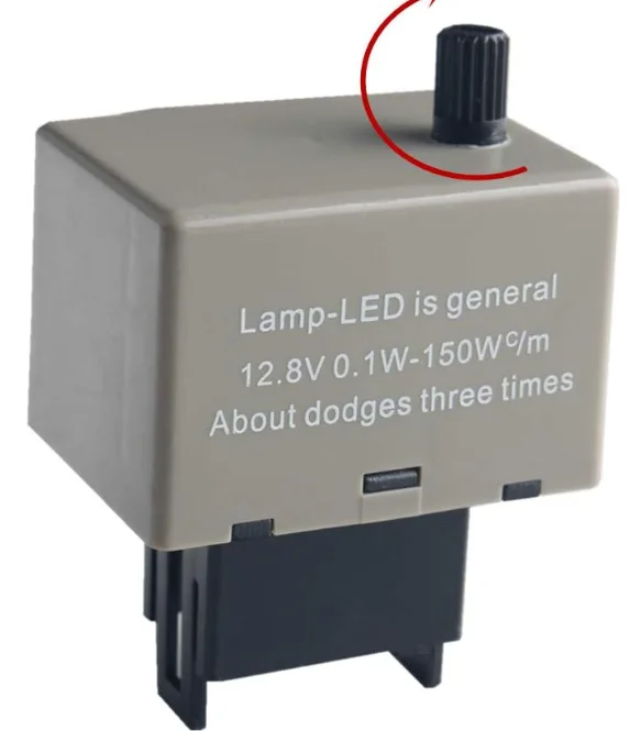

2. adjustable flasher relay from amazon
The good: flasher frequency adjustable, 3-click function, price is good
The bad: building quality

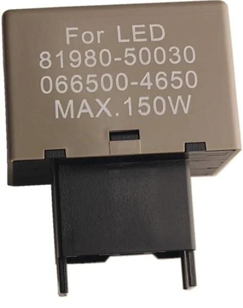

3. Non-adjustable flasher relay from amazon
The good: 3-click function, price is good
The bad: building quality, the one I tested has issue: when the lever auto-return, sometimes it will add another click on the other direction, very annoy.

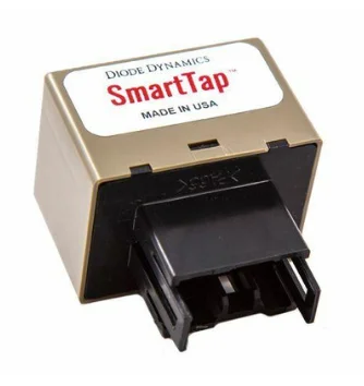

4) SmartTap CF18 LED Turn Signal Flasher
The good: building quality, functions?
the bad: pricy
I didn't test this one. cannot say too much about this.
the bad: pricy
