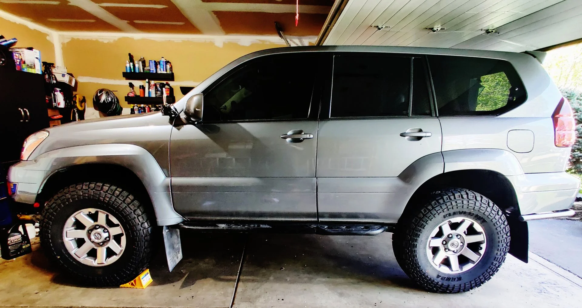

I use mudflap for same reason. Trying to keep dirt and salts from basting the undercarriage.
Not really 460 but similar concepts will work.

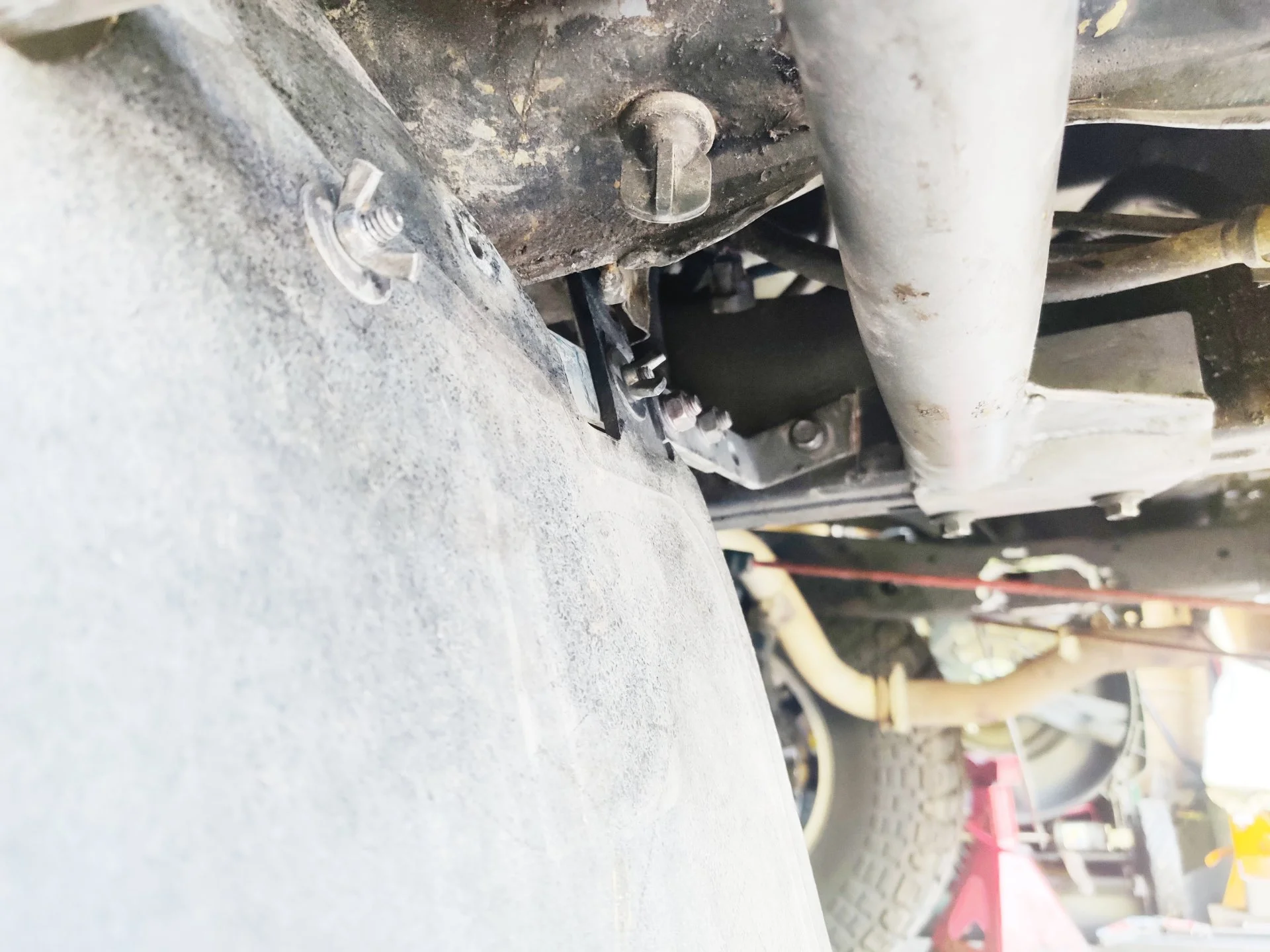

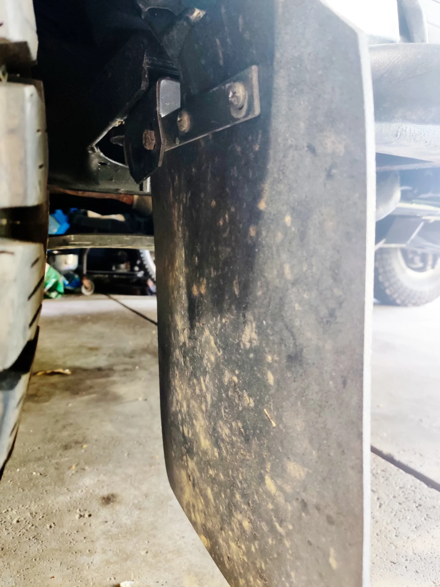

Front is attached to a hole below body mount using angled bracket and some straight piece of galvanized steel.
Rear are angled galvanized steel bolted to threaded hole on the frame.
Recycling some old muflaps from 87 Hilux.
The wing nuts makes it easily removable for heavy off road use.

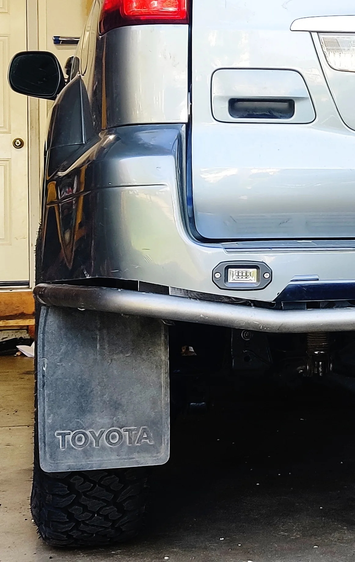

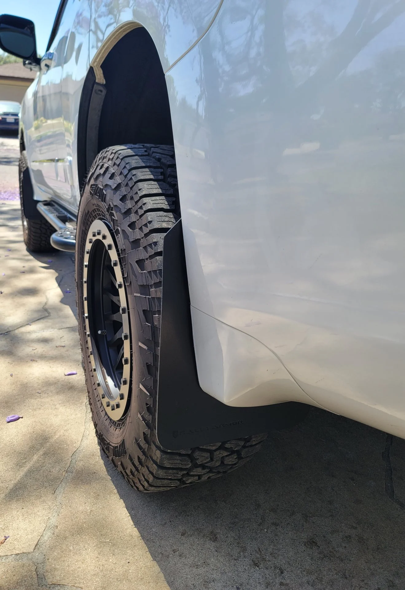

You might want to try the universal rally armor mud flaps. They have 2 sizes, I got the shorter one. Easy to install as long as you make a template first. I only drilled extra holes in the rear liner, otherwise I used the existing liner screws. The mud flaps are flexible but don't flap around.
I was hesitant in adding mud flaps since I cutoff the stock rear ones and I didn't want to risk the flaps getting caught on something on a trail. However, I got sick of rock chips and the car getting dirty every time I went over a street puddle. There's a lot of flex on these mud flaps and I haven't had a problem with them so far.
