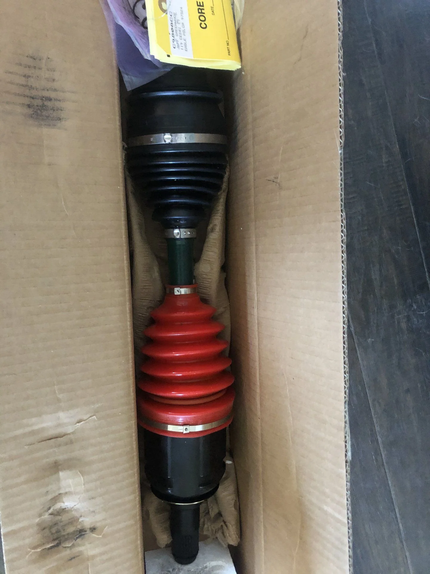

I have used both the Boots and also there rebuilt axles that have the boots. both great .
if you do not want to mess with rebuilding your own just exchange them

One of my axles is the original OEM from '08. My other is a rebuilt Toyota from CVJ that has been on the truck for a little over 9 years I think. I also have another new CVJ rebuilt axle as a spare. I've already have the axles out since I pull my diffs to send to ECGS for a regear. My plan was to take them over to CVJ to get them rebooted or just swap them out.
Regarding warranty, they don't offer one for lifted trucks.
@Firemedic831 How long have you been running the red boots on your FJ?
I put the red boots on last year . But just got new reman axles from them so i could have some spares .

BMT i have the $251.
