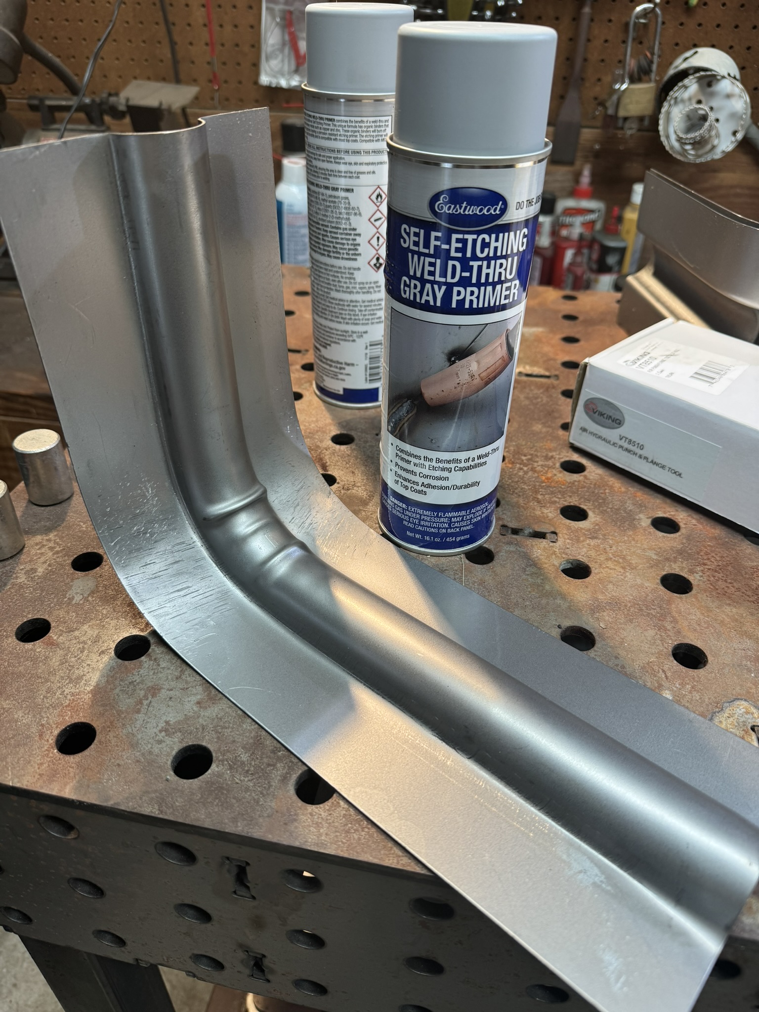

Update: The retrofit project to add roll bar support brackets to our early 40 series is complete. I ended up using the brackets from CCOT.
I had to remove some existing captured-nut support plates that were occupying the same space as the new brackets. As pointed out above, I believe that these originally were for jump seat mounting. However, I believe that at some point, different jump seats were installed in our rig, so the original mounting holes are different and the captured nuts weren’t even being used. It is impressive how beefy Toyota made those support plates.
The spot weld cutter did a good job on cutting out the spot welds: (Side note; I'm deeply envious of folks that have access to a lift and don't have to work while laying flat on their back looking up into a debris field.)
I primed the new brackets with Eastwood weldable primer; mocked-up and marked the roll bar mounting holes:
Drilled, and installed. Finished result:
