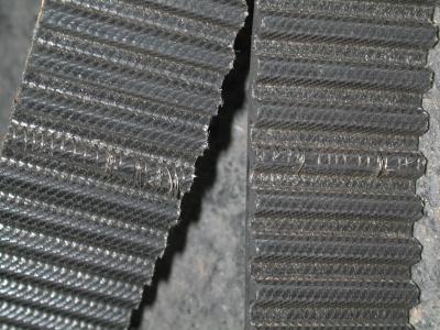

Here (finally) is a picture of my timing belt:
High res pictures here
Overall the belt looked good, but there are two areas where some kind of stitching is coming undone. You can see it pretty clearly in then high res pics...
It probably could have gone a bit further, but seeing the stitching, I am glad it is swapped out.

Holy cow - only 112k miles? Loose stitching!
Dunno what the various compounds are in these belts, but ozone attacks rubber & many synthetic compounds, so if SF Bay area has high ozone (like some of those OTHER areas of CA) the ozone may degrade belts faster, never mind the sunny skies & 69 F weather.
My timing belt looked great by comparison, at 90k, but looks do not tell the whole story with belts. (Reinforcement is where the strength is, and it can be degraded without visual clues.)

Mine was almost 7 years old with only 58K miles on it when I changed it. It "might" or "might not" of made it another 30K miles or couple of years but the water pump was also starting to weep. Mine lived its life in southern AZ. I would recommend that everyone follow Toyota's recommendation of years and mileage. This is something that should not be pushed.
