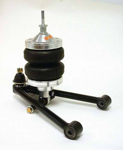

I emailed them asking if they would sell the suspension as a kit. Until then - can anyone supply me with photos or diagrams of this suspension, as well as the brand and model of their "Airshock"? The two pics above are definitely not very useful. If I could acquire the shocks, I could fabricate the rest easily with a few pics to work from. Tho I would definitely rather install the suspension rather than fabricate a copy completely from scratch....

YIKES indeed! $699 for a pair....
I located the manufacturer - they want $900 for them: Suspension Systems :: ShockWaves :: Universal Styles :: 1000 Series - Universal ShockWaves (Pair) - RideTech.com - Air Suspension Specialist
"Diameter and load capacity:
6.5" diameter SKW1000 series = 2140 lbs. @ 100 psi
8.0" diameter SKW2000 series = 3150 lbs. @ 100 psi
Our latest refinement of the original ShockWave™. It is typically used in an independent front suspension application. It can also be used in some independent rear suspension applications. The ShockWave™ v3.0 uses a double convoluted airspring bellow to achieve the load capacity required for these installations.
Recommended Applications: IFS and/or IRS installations on vehicles weighing 1500-2500 lbs. per axle. NOT recommended for solid axle rear applications..not enough travel, too much load capacity."
I guess this makes Adv Trailer's TASS kit a bargain at $1250, but I would have to haul my trailer 25600 miles round trip to Prescott to have them install it for maybe $1000 more. They won't sell the kit separately, according to the reply to my email.
