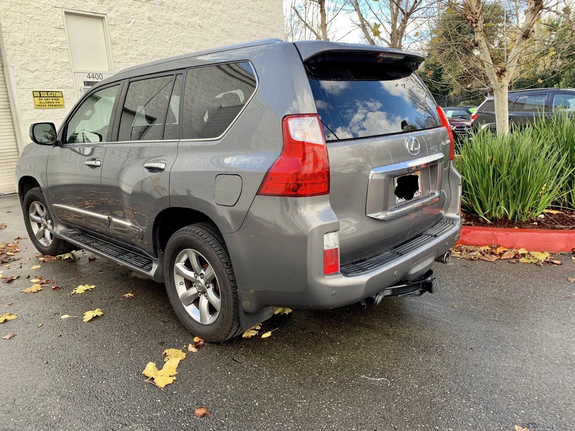

Like the bronze color! What color is your rig that you're putting them on?
That dark grey color. I am going to remove all chrome off of it. Either wrap the chrome or get them painted. Still debating. As of now I am doing all the maintenance on it since I bought it used with 97k on it. Luckily for me it was serviced it’s entire life by a Lexus dealership and looks like it’s never been Offroad and was garage kept. An old couple with no kids and non smokers owned it before me.
