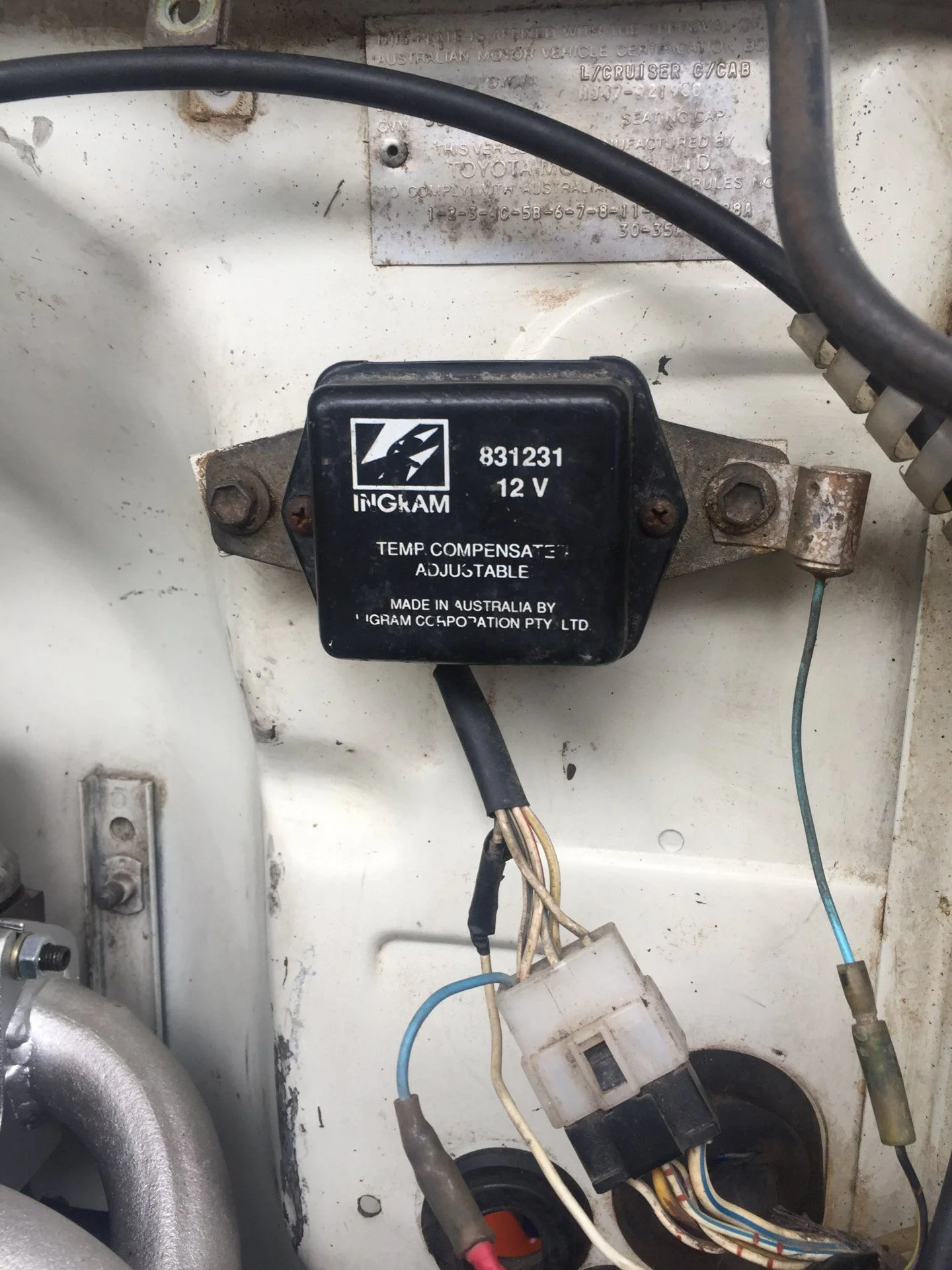

Can anyone tell me what this Temp Compensator Adjustable is for ?
Its on a 1982 HJ47 Landcruiser with a 2H Diesel engine Truck
Thank you
Yes, you can bypass the old regulator, but you may have some re-wiring to do depending on how you wired the internally regulated alternator.
I am assuming the alternator is currently NOT charging the battery?

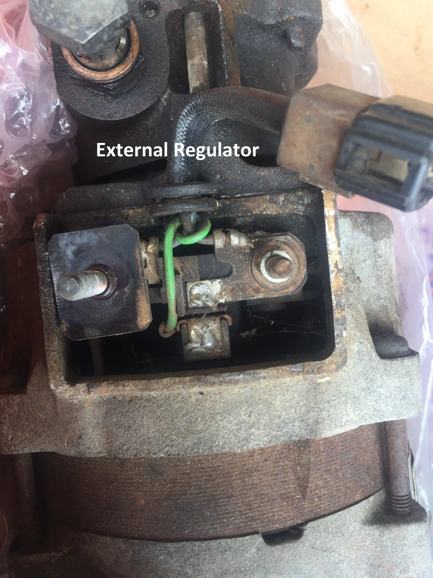

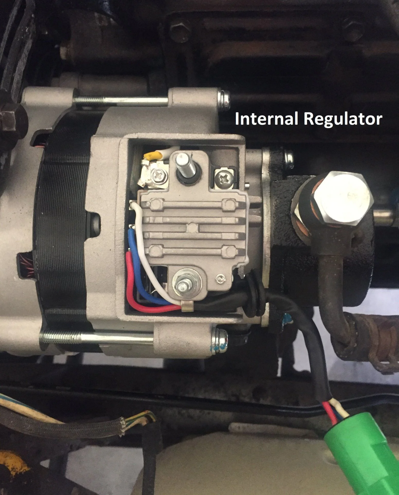

The alternator is brand new with internal regulator purchased from Australia...……. yes the old is not charging correctly.
I didn't do any wiring on the new one and it has the same wires coming out of the alternator as the old one.....
I double checked the Alternators.....the new one has internal regulator......the old one has external one......see pictures...
I guess I need a wiring diagram to rewire ….but still needs the connection to the solenoid operating the fuel shut off arm...….
that comes from the EDIC relay that is also the external regulator ….. ??????
