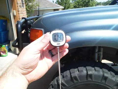

Outside temp.

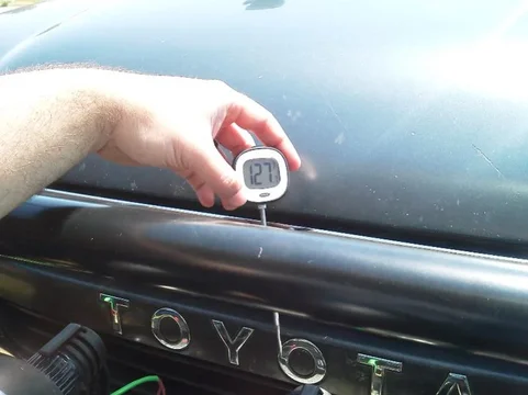

Temp in front of grill.

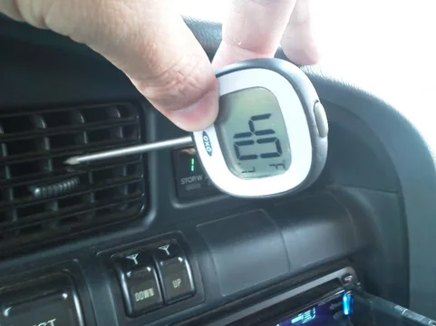

Vent temp on blower setting #2.
