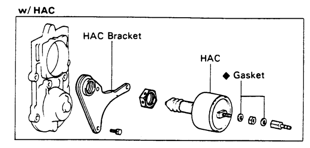

Thanks for the reply @mudgudgeon . It's hard for me to tell exactly how it's hooked up on the 40 as the pictures are limited in the Toyota Engine Repair Manual.
Here's what I can see in the manual on page FU-30.
and on page FU-35
The later pics for 11B, 12B and 13-BT show a connecting link, like you describe.
I thought I saw a picture of a vacuum home coming out of the nipple on the HAC, but now I can't find it.
Would love it if someone had a picture of an HAC hooked up correctly on a B Engine.

@mudgudgeon - good idea. Attached are two pics, and after looking at the components I have, and the pictures again, it's starting to make a little more sense.
The second diagram above, from FU35 appears to show the black, plunger looking part of the HAC butting up against the flat metal piece that connects to a cable that then connects to... something.
At this point, I assume that when mounted and the air pressure changes (or maybe vacuum?) the HAC lengthens or shortens the "plunger" and that moves the metal piece that attaches to a cable. The cable then alters something.....?
The vacuum line is vented to the atmosphere. It's purpose is to go to an area that's unlikely to get water and dirt in it. There's a diaphragm inside the HAC that is responsive to changes in atmospheric pressure and changes the length of the full-stop position. Think of it as a variable-length fuel screw.
