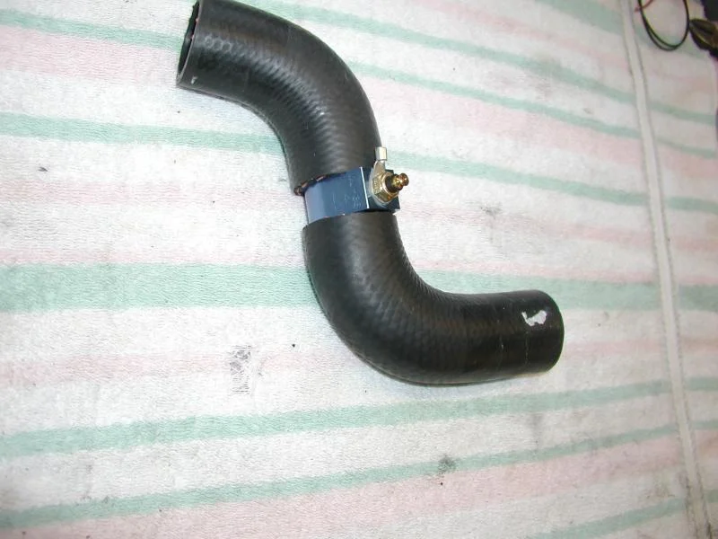

I started off with a rectangular guage from Dakota Digital. See link...
Odyssey Series I, Water Temperature
This in turn was paired with a Greedy Radiator Hose water Adapter. See link...
Greddy 16401634 Radiator Hose Water Temp Sensor Adapter 34mm
What's important to remember is that the Greedy part needs a water temp sensor inserted into it and that sensor needs both the hot wire and a ground/earth since mine was installed in between the upper rubber radiator hose. See picture 1. You can just make out the silver ground lug in between the sensor and the Greedy adapter.

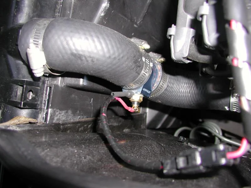

Picture 2 shows the installed part. You can clearly see the RED hot wire and the BLACK ground/earth wire. Both these wires are routed back to the gauge installed below the console.

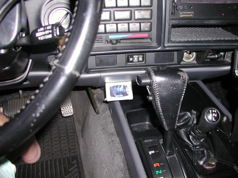

Picture 3 shows the installed gauge. More pics to follow !
