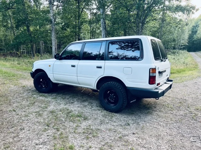

About a month ago I got my hands on a pretty, for Sweden at least, unusuall, poverty packed, German sold, HZJ80 -91 with 280,000 km. Don’t know to much about the history of the vehicle more than I can tell that it’s well maintained and runs like a train. There is Sahara stickers on the inside and everything is OEM. I’m all into the utilitarian look and my inspiration for this car is the UN-cars going around keeping the diplomats and soldiers comfortable in uncomfortable parts of the world. FJ Cruiser steelies is a the paint shop atm beeing painted in the grey nuance to look like the split rims and a real cyclone snorkel is soon to be mounted.

My Cruiser. Exactly none of the possible accessories for the car are choosen. No AC, vinyl seats and just the center diff. But AWD. Not the part-time drivetrain.
