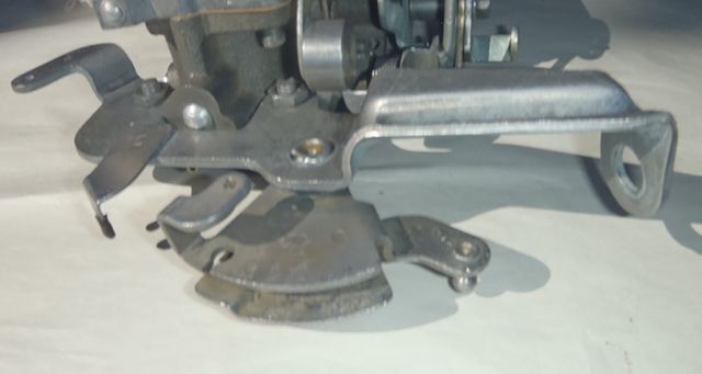

I ordered the cable. Any chance you can send me a photo of your assembly on the carb end? I'd like to see the brackets you are using.
I will. But first, does your carburetor and cable linkage use the stock '73 bellcrank assembly?
I converted my '71 FJ40's linkage to this set-up to avoid the loop in the stock '71 set-up, which would interfere with the '76 air cleaner I'll be using.
