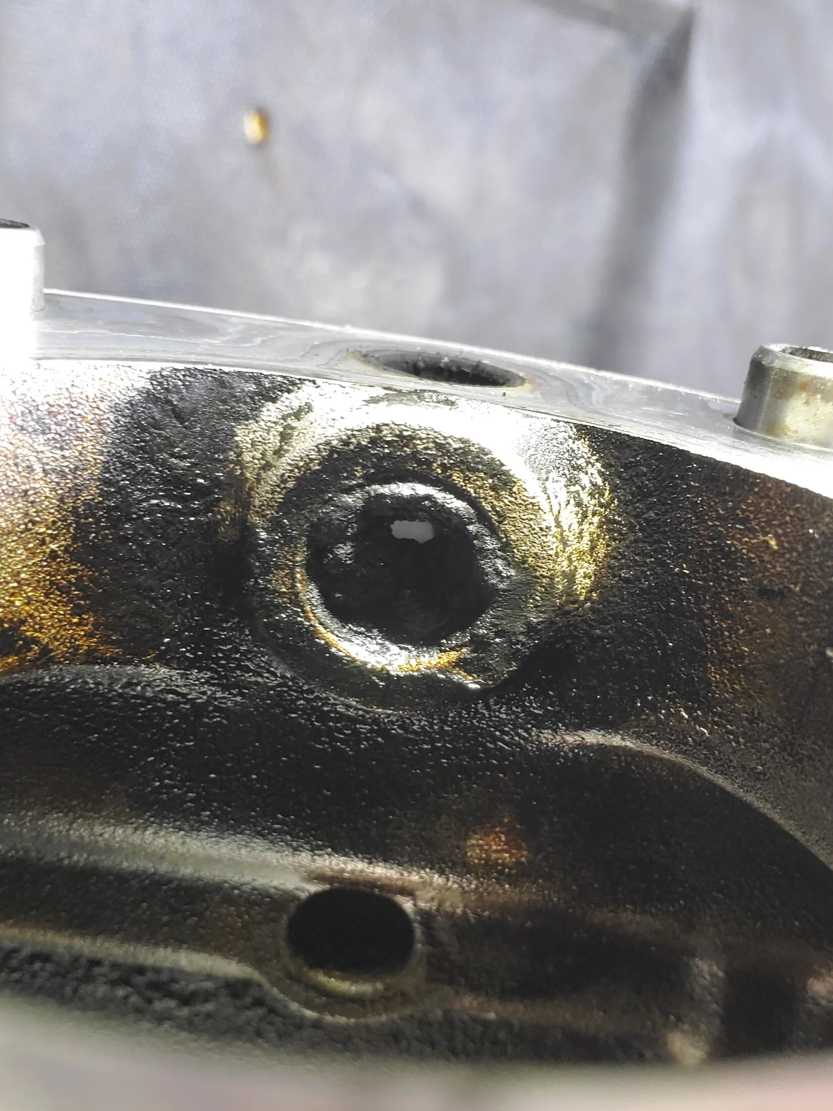

Fixed with:
-Took off throttle body and cleaned royaly and noticed a severely clogged EGR port
-Cleaned EGR port

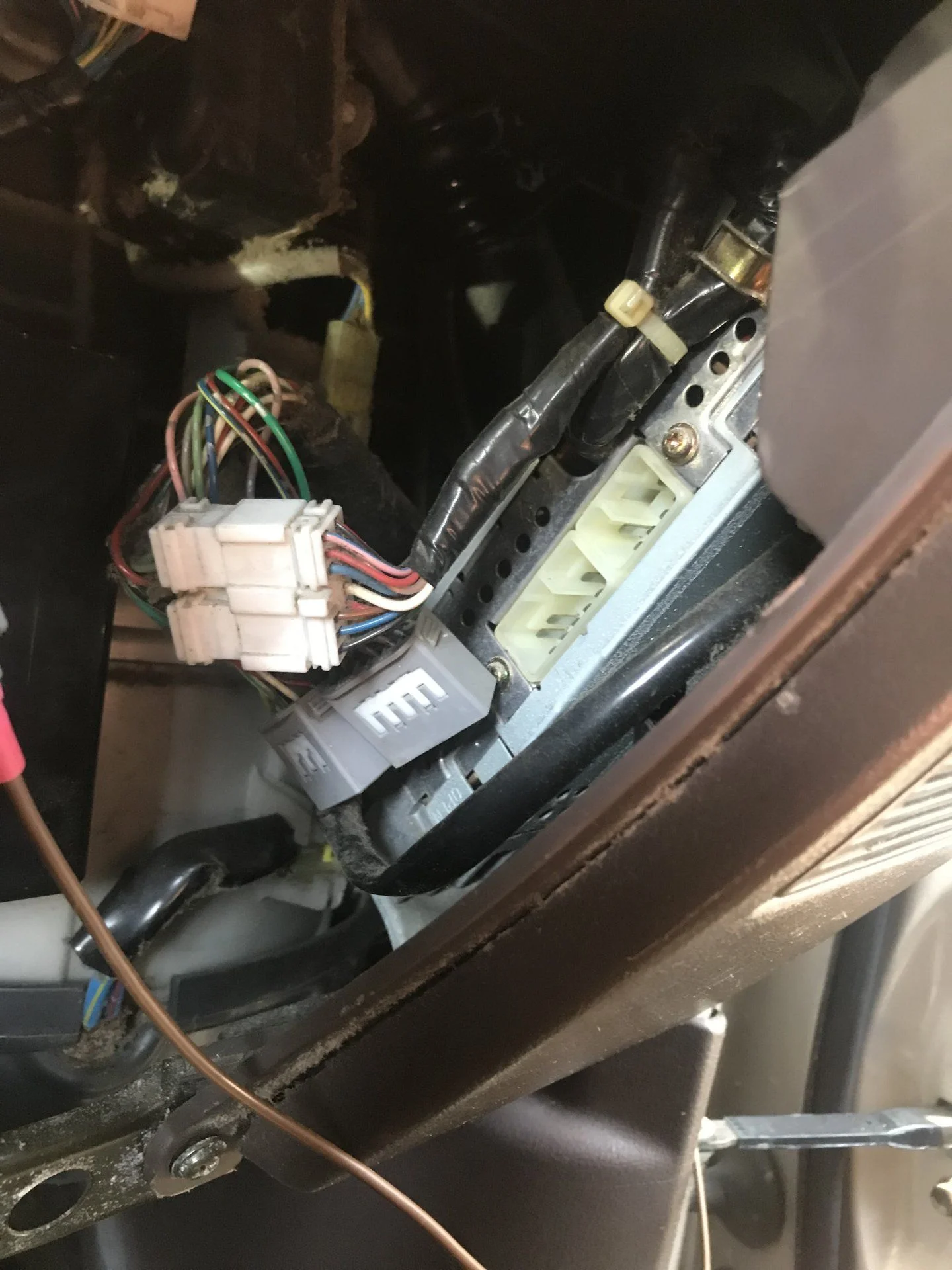

I do have another question though. Does anyone know what the controller is to the left of the ecu behind the glove box? It has two plugs that aren’t plugged in...

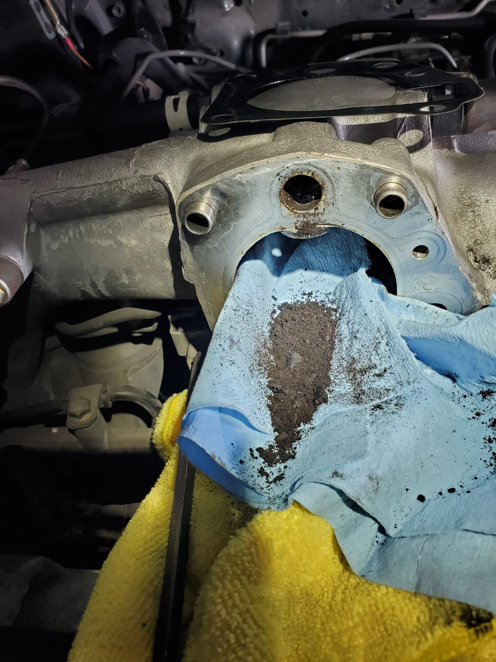

I know this is old post but just incase y'all out there have this same problem when accelerate.
"No CEL and had a studder when under load between 1300-2000 RPM's and when engine was warm"
Thanks to the OP i removed the throttle boby and cleaned out the port to the egr ( fixed the problem). See pics, now my truck runs alot better. Seems like the truck got a little power back.
