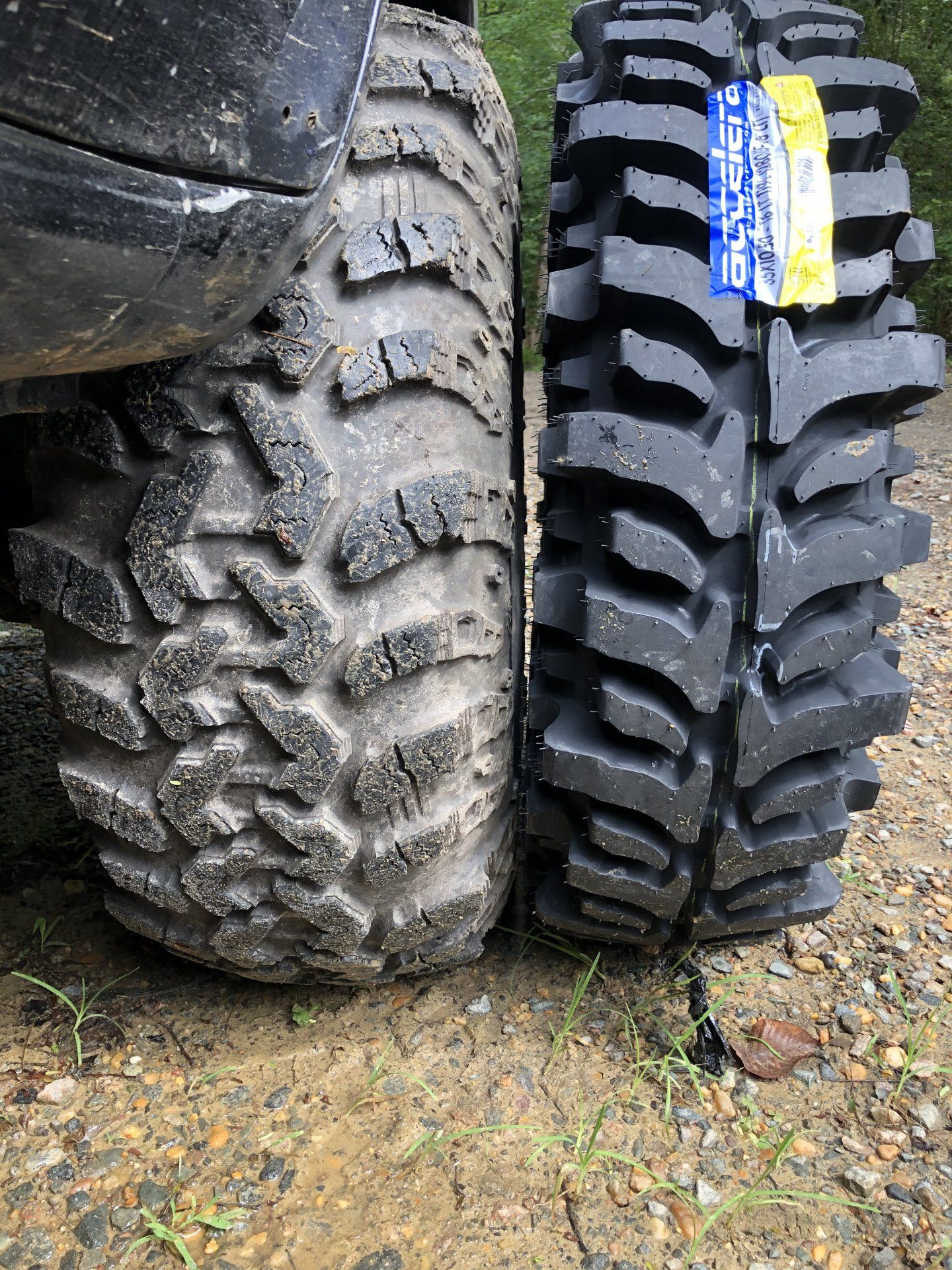

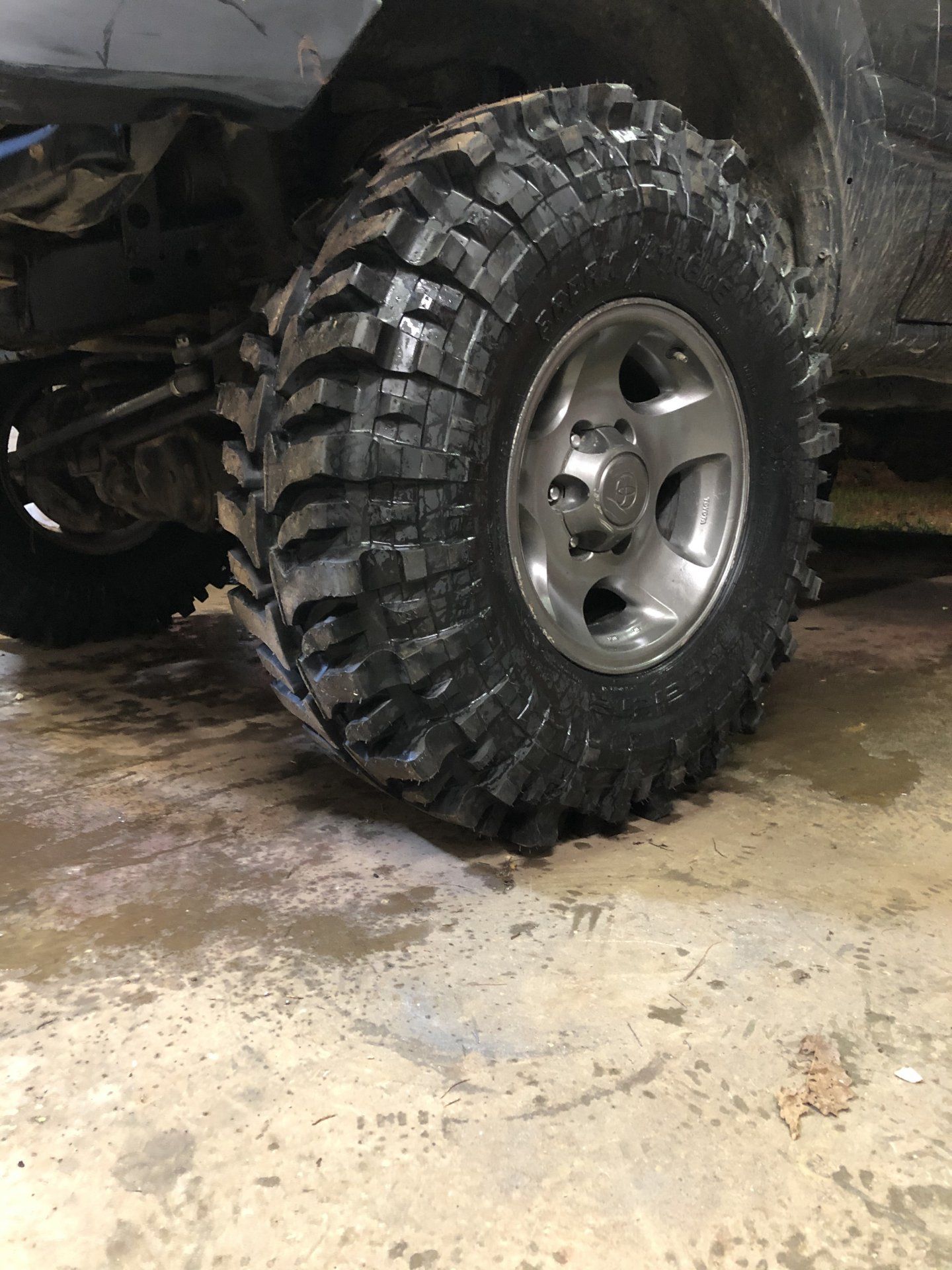

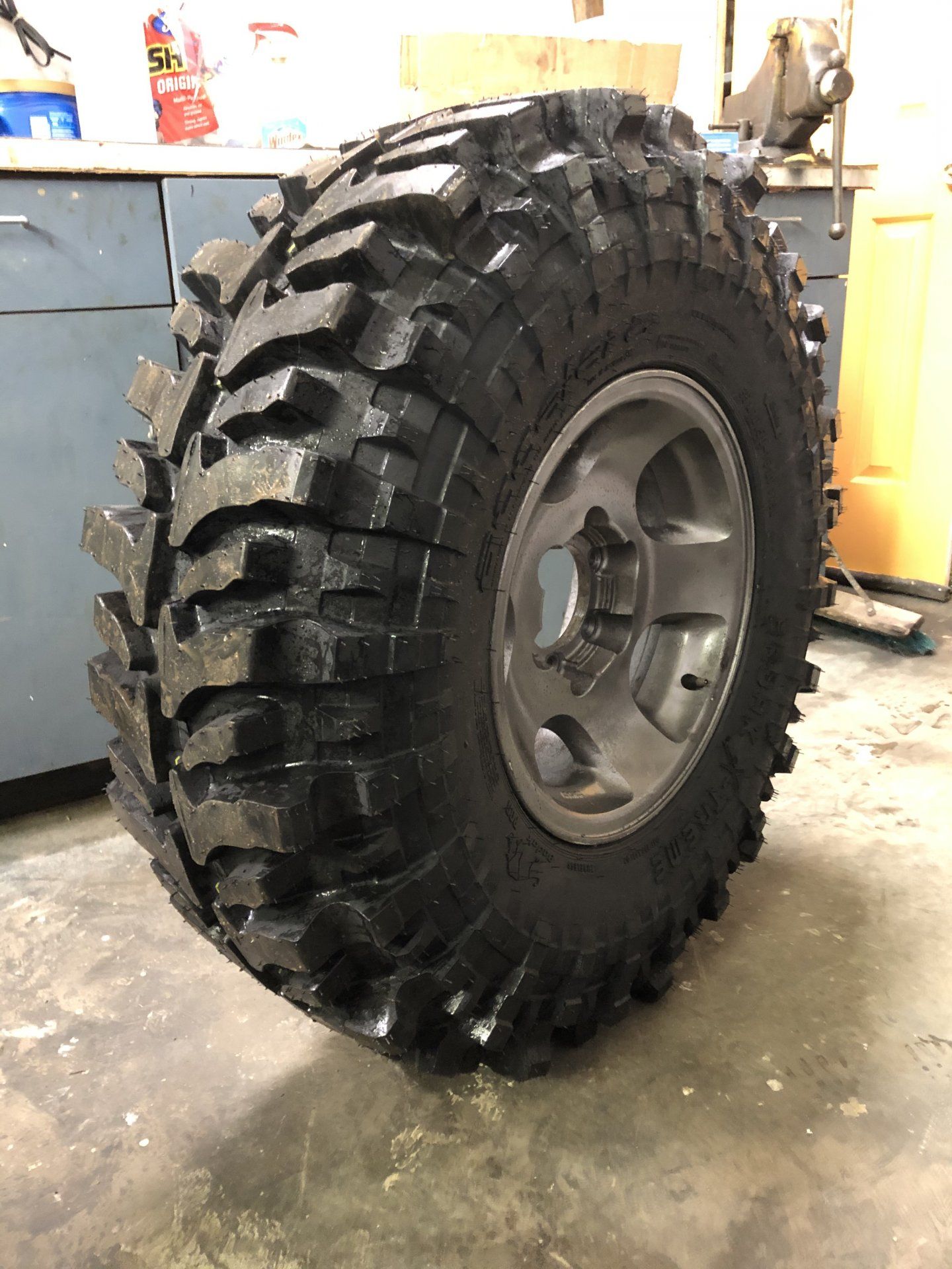

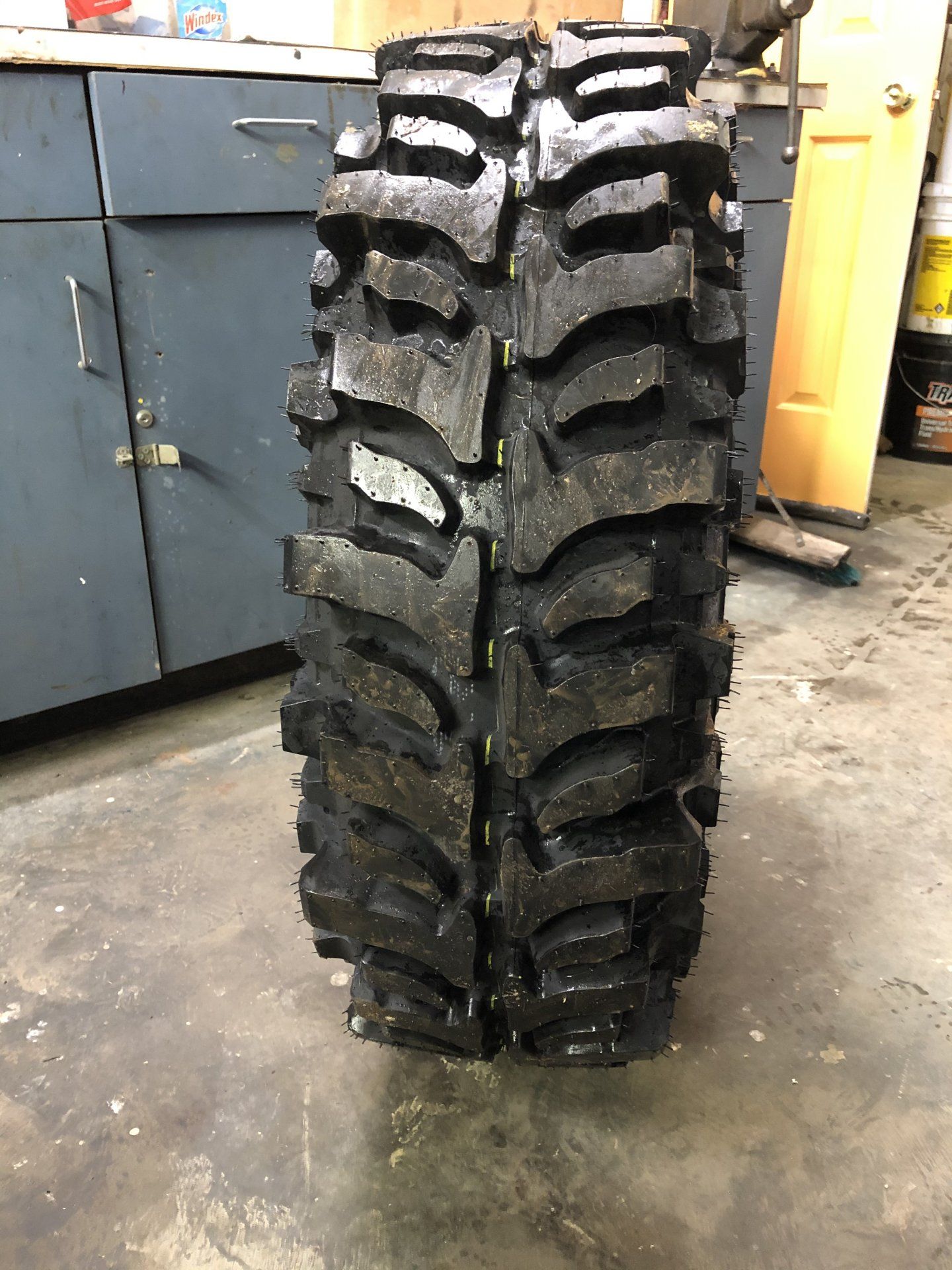

So while doing some tire stalking on the internet a while ago I found these and sent a few emails back and forth and picked up a set of 35x10.50x16s. All the sizes they have are 10.50 wide and range from 31s to 35s with 35s. The only option for a 16” wheel is the 35s. When I first saw these on the Indonesian accelera site all I could think is “It’s a radial bogger with a center bar”. So now that I actually have them all I can say is the pictures don’t do them justice. These things are meaty. I was running 36x13.50x16 iroks, which run tall and Interco specs out at 36.8 and these are only 1/8” shorter if them. I mounted them last night and took a drive on them and they actually ride and handle really well for how aggressive they are, especially since they are unbalanced. I’m getting them balanced this week just to see how much weight they will take but more than likely will run balance bags in them after a couple trail runs. They are loud, like Bogger loud but I like that. The 35 weighed in at 72 lbs and is about 25/32 tread depth at the center. As for hardness, my durometer has them at at 61 or 62 compared to my iroks at 60 or 61. I’m hopefully going to get to give them some trail time in the next few weeks and will report back with more info but I’m expecting in mud they will be amazing and I’m thinking they will do pretty well on rocks also especially since they actually have a little bit of lateral stability. Also I found with some additional internet stalking Accelera has a guide for cutting the tread based on what kind of terrain you are mainly using them in. Yes this will void the DOT certification and warranty but I don’t know another company who does this.

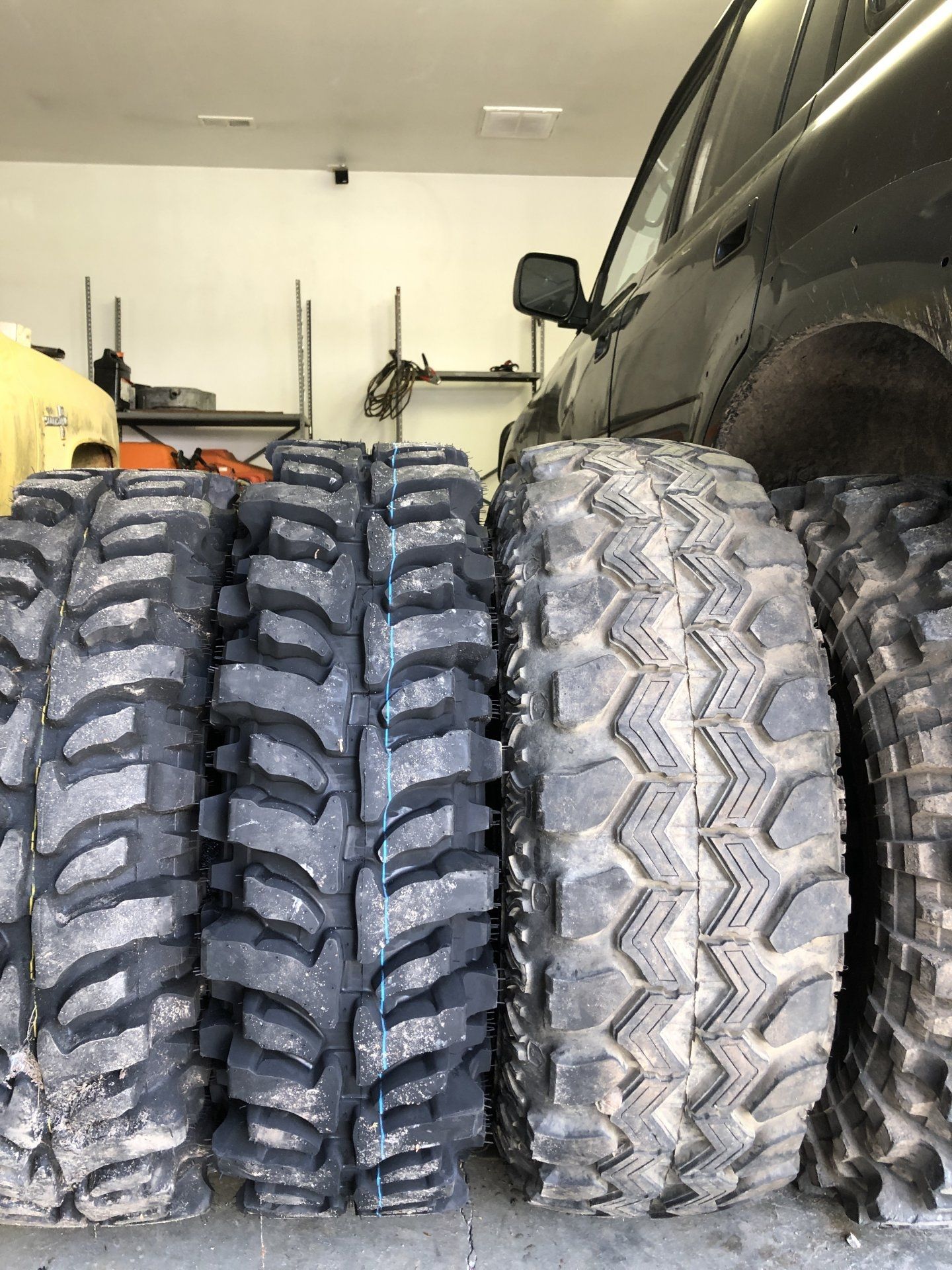

In The pic with 3 different tires all of them are at 28 lbs on FJ80 wheels. It is a 37x12.50 SSR swamper on the left, the Badak and the 36x13.50 bias ply Irok. My 80 is sitting on OME J springs with a 30mm spacer up front and J’s in the back. Right now they have 30 psi in them but that might be a little high. They are load range C and they appear to be very well built. I’ll try to take some better pics of them on the 80 when it’s not raining or dark.

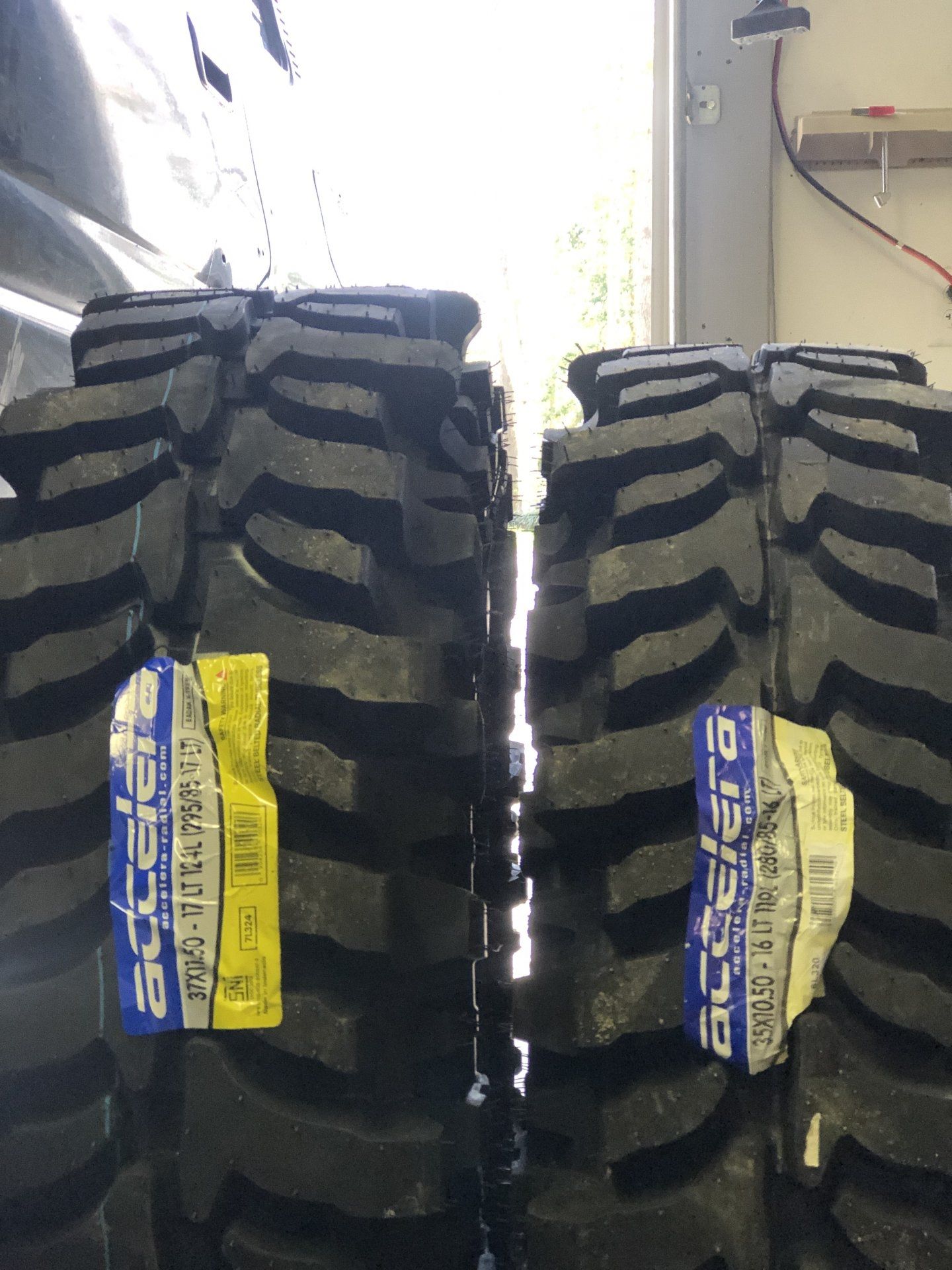

The 35s when mounted are a tad bigger than 35” the 37s mounted are a true 37” tire. I have a set of both now. The 37s are going to be perfect under the cruiser. I have a little over 3,000 miles on the 35s and they seem to be wearing very well given how aggressive they are. I have a slight bit of cupping on the front 2 but I think that might have to do with just realizing I need to redo the wheel bearings. I bet they have lost less than a couple 32nds of tread tops. You have to pay very close attention to tire pressure though and find the right tire pressure for your rig. I can’t wait to try the 37s out in a couple weekend. Here is a comparison pic of the 35 and 37 Badak not mounted vs a 37x12.50x16 SSR that was just taken off the wheel 2 minutes before. The 37s weigh 79 pounds and the lugs for look physically bigger to me but I haven’t pulled out the depth gauge yet
