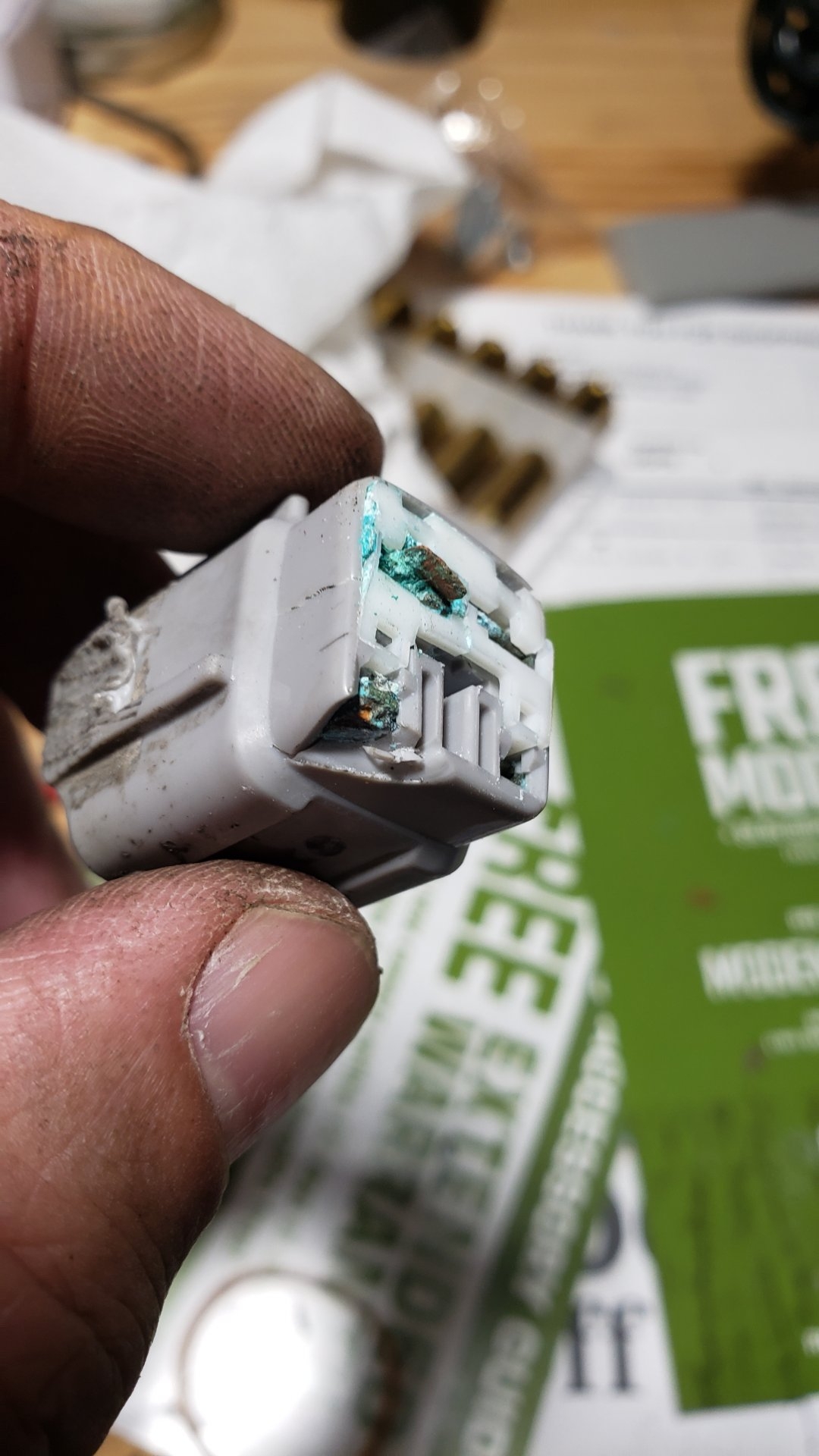

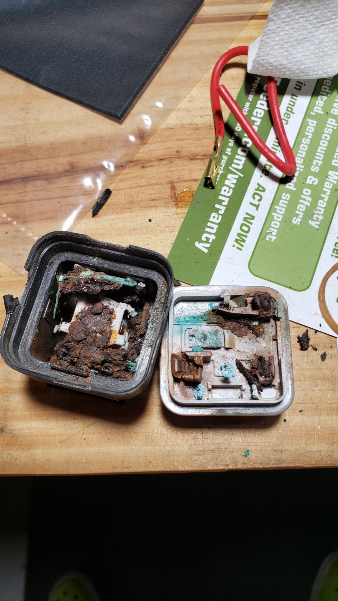

Well, I think we can all agree that the fan relay was faulty.
Unfortunately it took the connector with it
Since I couldn't find that plug anywhere I decided to take the easy route and put an aftermarket relay and socket.
It now blows again...
Yowza..............THAT is bad. Never seen one like that.
Good job on the fix!
