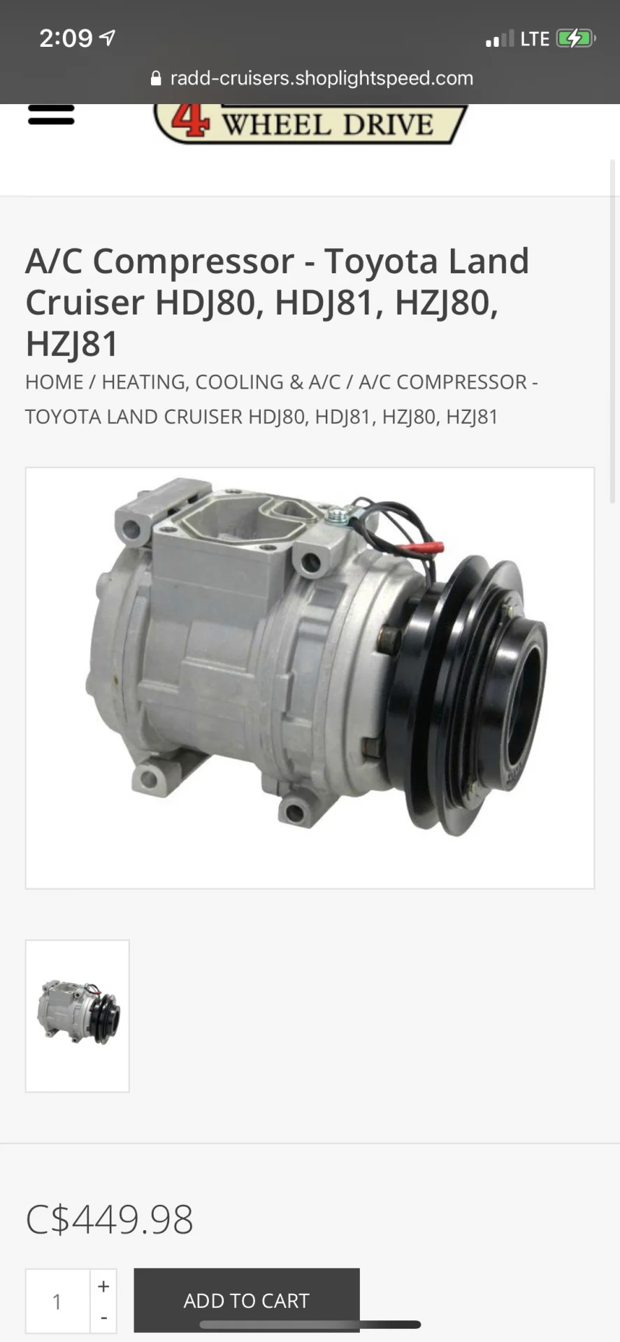

This compressor form RADD cruisers looks pretty identical to mine. Says denso 10pa15c which is what mine says on the back. But it says it works with 1hd and 1hz, any ideas if it would work with 1kz??Need some help sourcing an AC compressor for a kzj78! New is ideal, but I’ll consider used if it’s in good condition. Need it soon! Haha thanks.

Any idea if part number 88320-60560 would work? I think it’s from the 1HD, 1HZ also 1Pz. They all look to be the same denso 10pa15, compressors, 12 v and the clutch/ pulley look the same. But the Toyota part numbers are different.I think the number you are looking for is 88320-60500 or 88320-35H92
