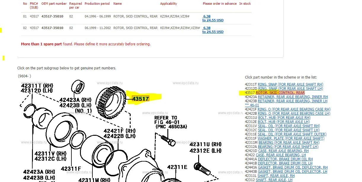

I had an '05 Expedition that had this and it was a precursor of bearing failure. The misalignment caused by the failing bearing caused an intermittent ABS indication which became permanent until the bearing failed hard. - Looking at the Toyota parts list it looks like a bearing failing could have the same effect on a 90 series \
