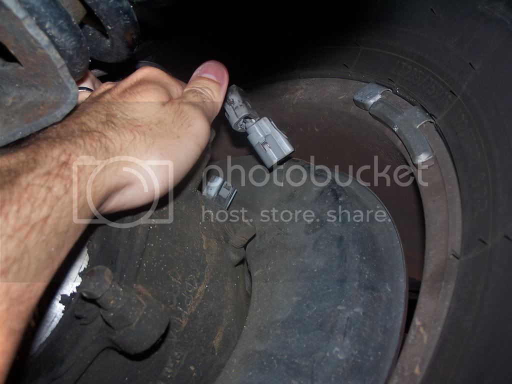

well, gonna keep the cruiser so I want to fix the titbits as much as I can.
Since putting my front springs in my ABS warning light has been on.
Today I finally crawled under to see if I could see what I broke and it turns out that this clip is broken
Can someone tell me what it is called so I can find it somewhere without sounding too stupid :)
This is on the drivers side wheel, looking from front of truck towards the rear.
Thanks for help,
AdamT
PS - sorry for the huge pic....
o yeah, by broken i mean there is a black and a white wire that runs through the clip.
The black one is disconnected from the connector in the clip - you can't tell from looking at the pic.
In case there was a question as to whether the damage was purely cosmetic or not.
adamt
PM Cluthee here on Mud. He is the resident 80 expert. I would think that wire needs to be hooked up.
Later,
Thanks Bodean,
Basicaly that sensor has to be connected to make the magnet portion of the sensor read on that side, if it does not walla light.
You may wanta look in the 80's section, search, then goto Advanced search, then type, ABS+ sensor, should be lots of thread about broken wires.
If I remeber the wires contained in that harness are very small, may be fixable, check the threads out.
Good luck.
That is a wheel speed sensor connector. I have one for a 94 in my tool box at work bring your truck by and I'll see what I can do. You just moved to Flowood right?
