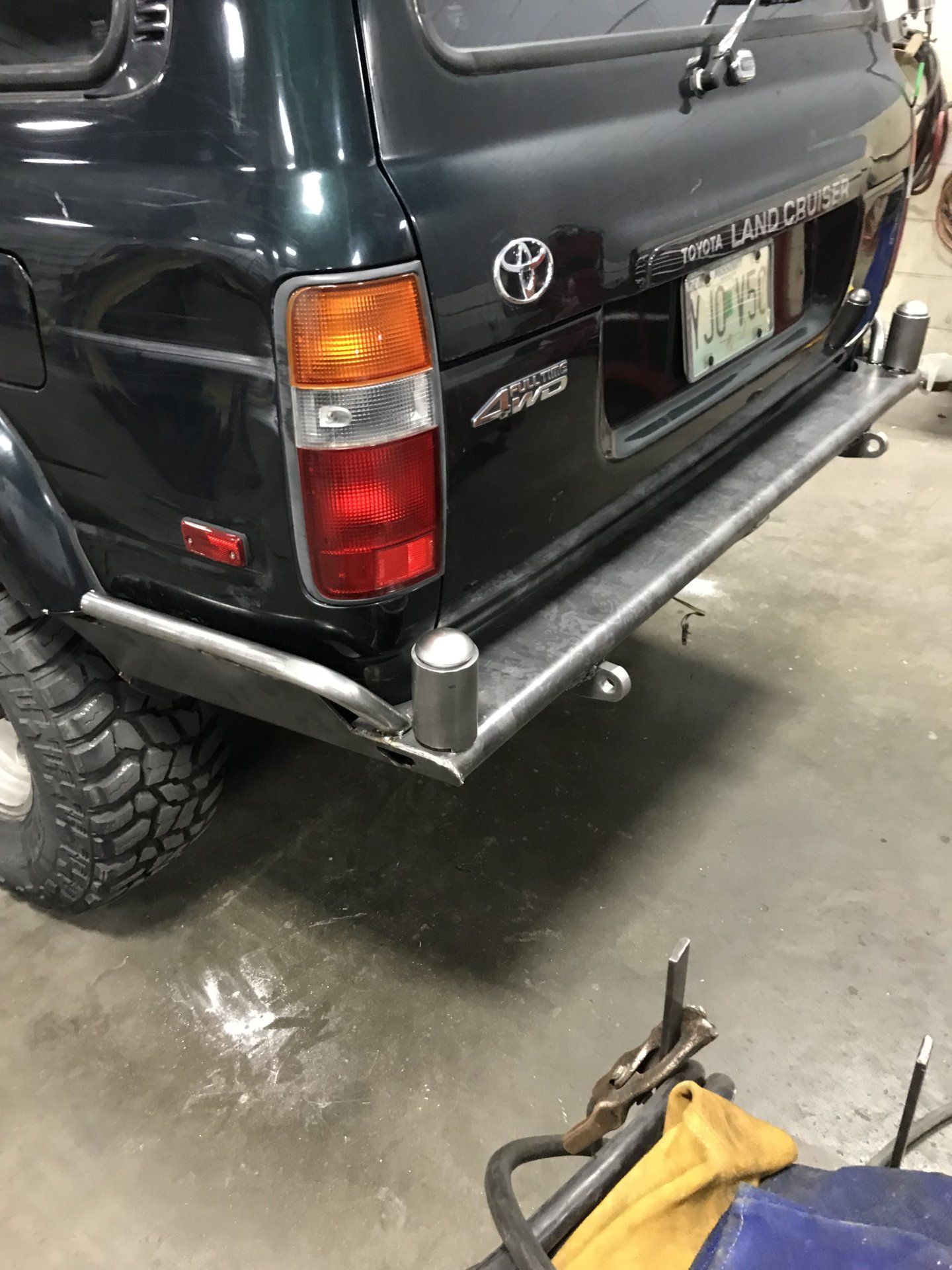

here is my 1994 triple locked cruiser in October of 2016 when I picked her up.
Drove it for a couple months and did some baselining. Good oil sample, new plugs, wires, cap, rotor, pcv, cats, and a front axle service.

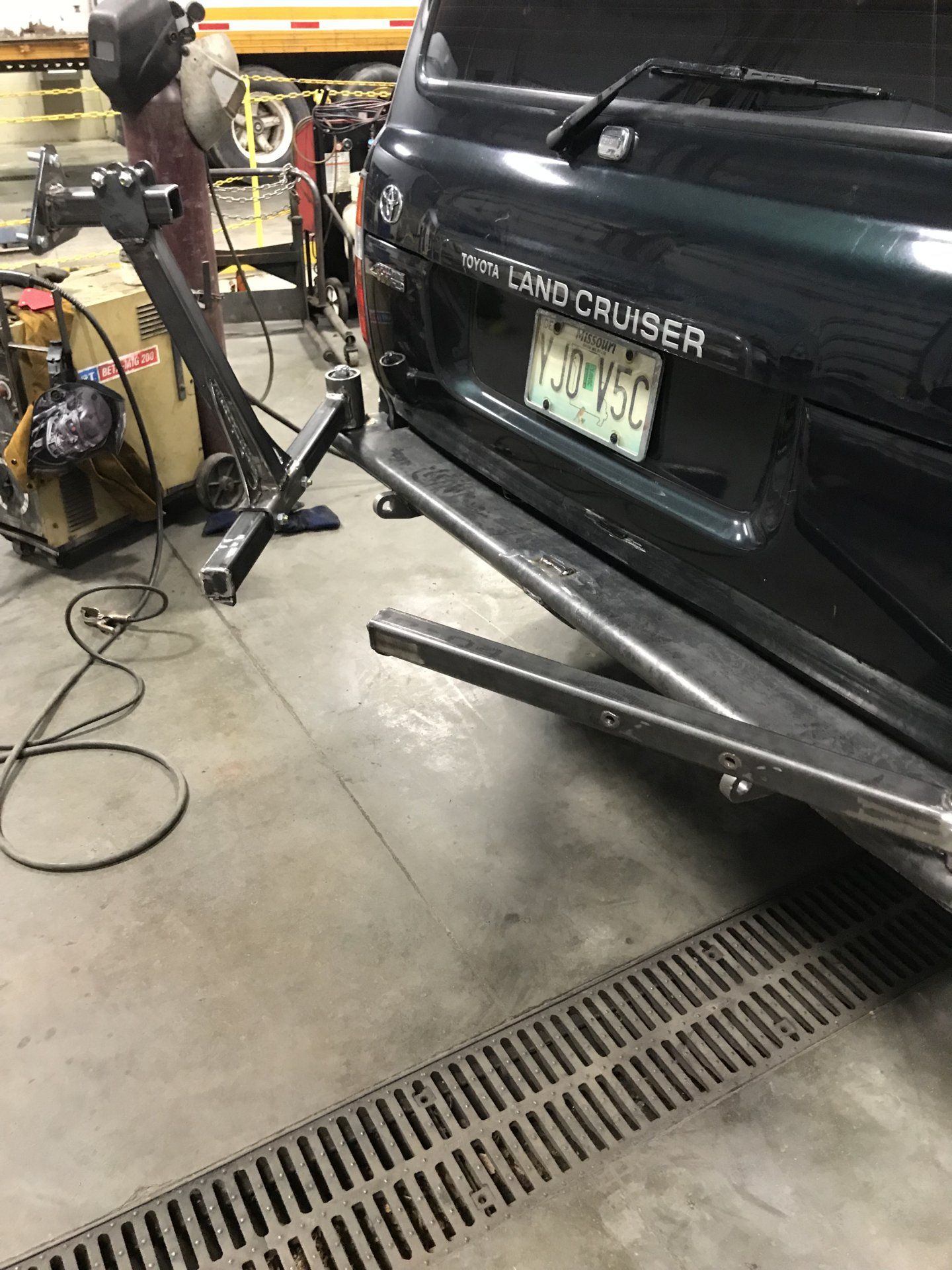

Bumper turned out pretty great. God willing I'll have mine in my hands in a month or so. Any things you'd do differently now that you've done it?
Plan some time for the assembly. I will have 20 hours or so in it after paint. If you don’t weld much find some scrap and practice. Have some cut off wheels handy and a good angle grinder. I had to remove a couple of pieces when I found I made a mistake. Thankfully I figured most of them out before I went past the tacked stage. Overall I am glad I went with the kit. The experience was worth the time and effort of assembly. Also, I would start with the penetrating oil on the frame bolts now, if you are not in the Southwest. I broke two of the mounting bolts even with daily soaking in pb blaster for a week.
