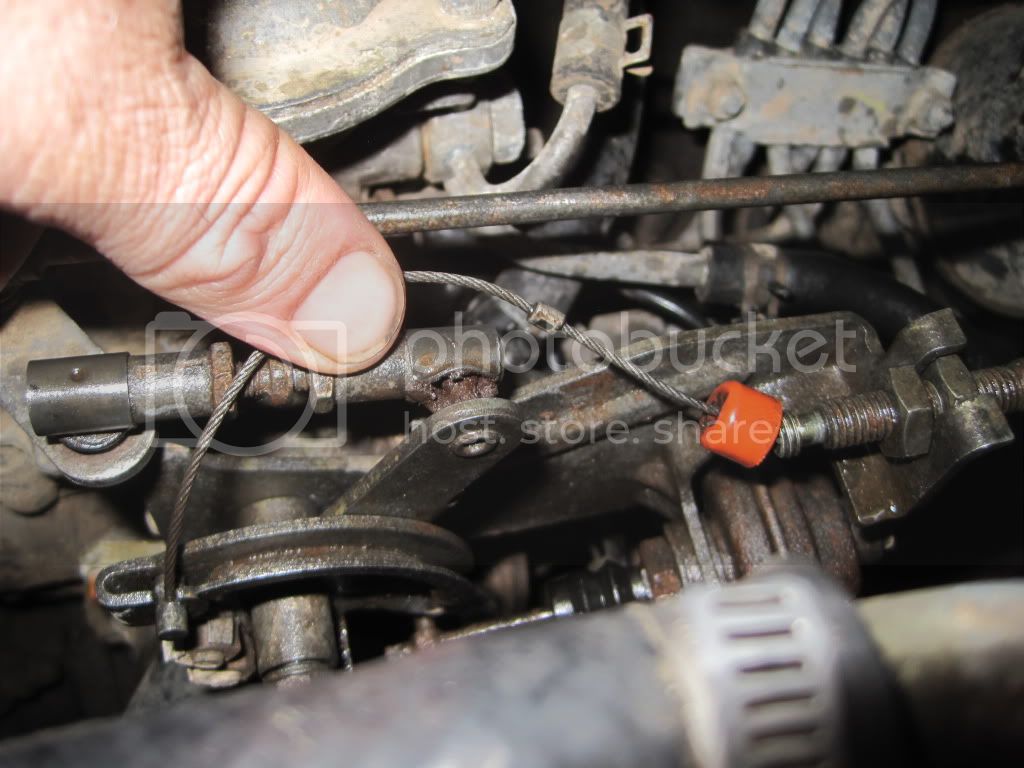

So I have owned my HDJ81 Land cruiser for a few years, always shifted hard. Lately my transfer case started to leak at the rear drive shaft. Well over the last week the truck has been shifting really hard and on down shifts (with loud clunks and metal tings).
Yesterday noticed it was coasting instead of down shifting then once almost stopped, loud clunk. Today would not shift out of 1st or 2nd till over 3000RPMs then very hard shift. So got home and checked FSM and truck out. Looks like my Throttle cable is disconnected inside valve body??
The cable is very loose and seems to have no resistance when I pull on it in engine compartment, and does not pull back inside the cable housing. After reading the FSM it seems to me that the throttle cable may be broken or disconnected at the cam inside the valve body?
Is replacing this cable difficult to replace? can the cable be found easily? and after reading then FSM dropping the transmission oil pan seems pretty hard.
The truck is not my daily driver and was going to be parked for the winter soon, but was hoping to have it out on the trails a few more times this season.
See pics below.

I am in the same boat except different side. My cable broke at the throttle plate. Either way, the pan has to be dropped as the whole cable needs to be replaced. I bought a OEM replacement from Lowes Toyota (a Mud vendor) that cost me around $60. I haven't tackled the job as I have been acquiring parts and trying to find the time to do it.

Just ordered a new Transmission throttle cable (kick down) from Raddcruisers, and am looking for anyone who has replaced this in a HDJ81 with an A442F. The FSM says I have to drop the valve body to replace cable, but John from Raddcruisers (highly respected) said that you can replace cable with just the drop of oil pan. I am looking for someone with 1st hand knowledge of what needs to be done to replace cable. Also while I am in there are there other things I should do: ie replace filter in sump pickup (if there is one) looking for any filters/ gaskets that I should have on hand/ replace while working in there.[/FONT][/COLOR]
