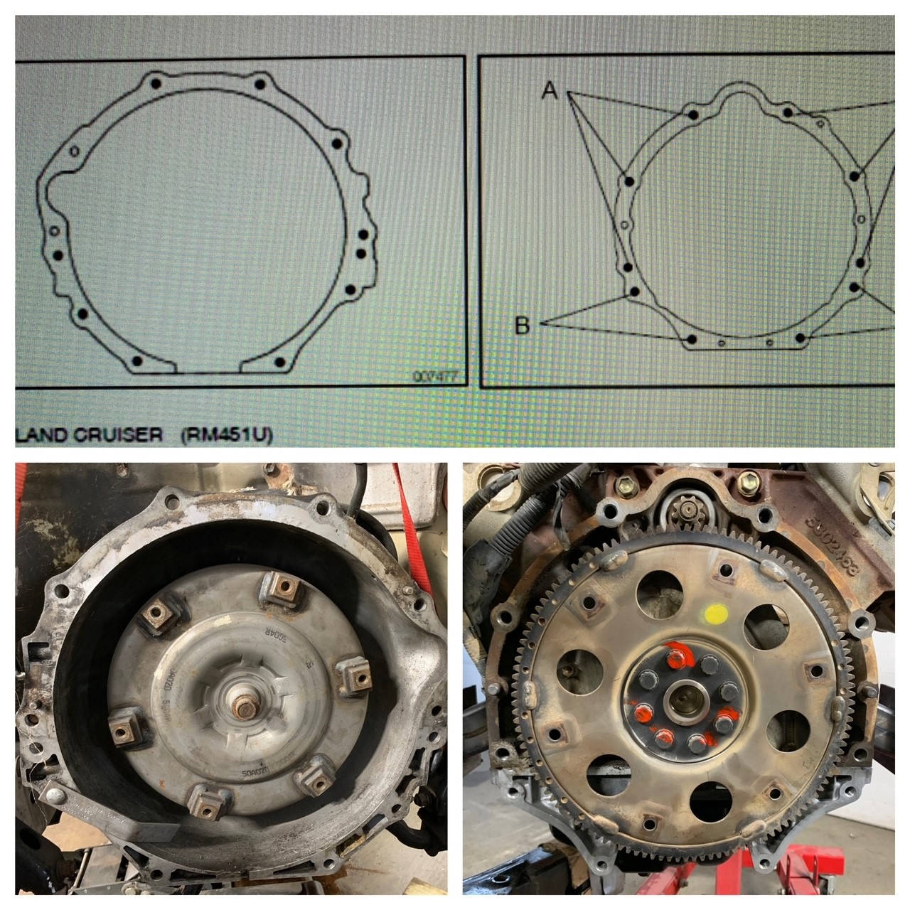

This looks suspiciously like the 80 series A343F manual. How did you verify that it's for the 100 series A343F transmission?

I found out the hard way the shape of the bellhousing is slightly different to bolt up to the 2UZ, I had a pic of them side by side let me see if I can dig it up
Here it is, the one on the right bolts up to the 2UZ, hope that helps
I'm pulling the A343F from my 2000 LX470 this week. I'll try to come up with a legible BC drawing. Maybe someone has an 80 transmission pulled they can check it with, and we'll all know ;)
If not, I'll make one of those when I pull my 80's transmission this summer.
