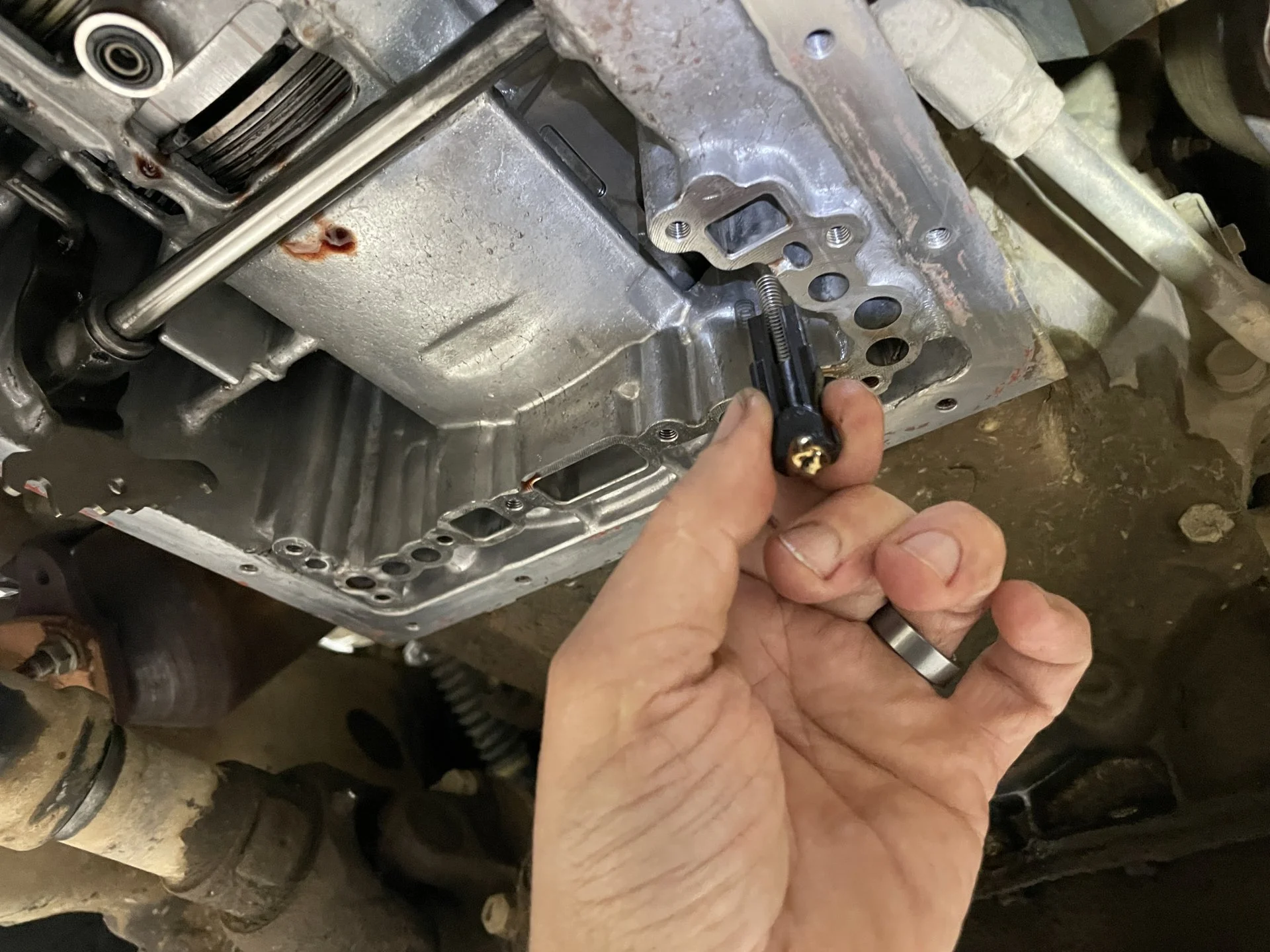

I picked up a kit from Valley Hybrids last fall and was saving this for a winter project. Parts include the HD valve body, new filter screen, o-ring for filter screen & 3-valve piston grommets, torque converter lock-up kit, and transmission cooler kit. I've pulled the pan several times in the past to clean the screen and refresh the fluids. About 19 bolts later, the valve body assembly drops out. The included instructions were pretty straightforward, though they don't depict the exact A750 transmission in the illustrations/images. You do have to be careful as you lower the assembly, as some of the valves will likely drop out and the tiny ball pressure switch will definitely drop out. I didn't see where it fell from and it took a minute for me to locate it's proper place when I reassembled everything.

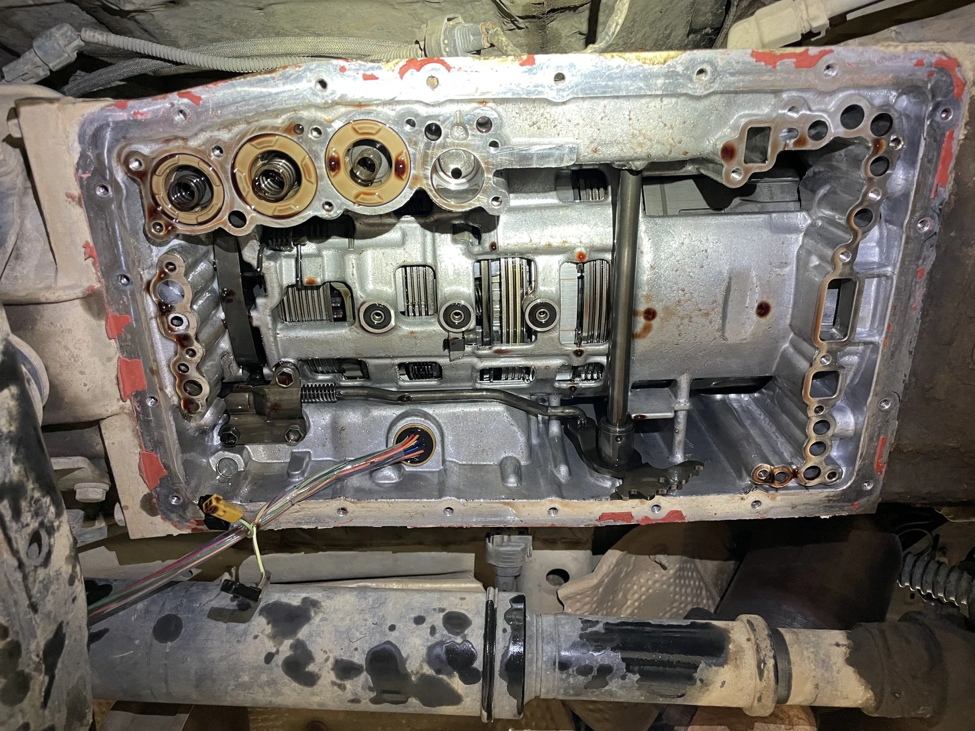

Pan and screen removed. Next is to carefully remove the harness plugs from each solenoid. They are each unique in color/size/shape, so there is no mixing them up when you rewire this on the new valve body. Two sensors are near the filter screen orifice and have specific orientation, so take note there as you go.

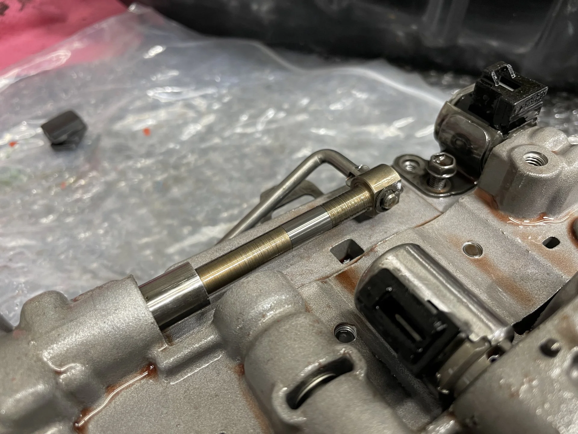

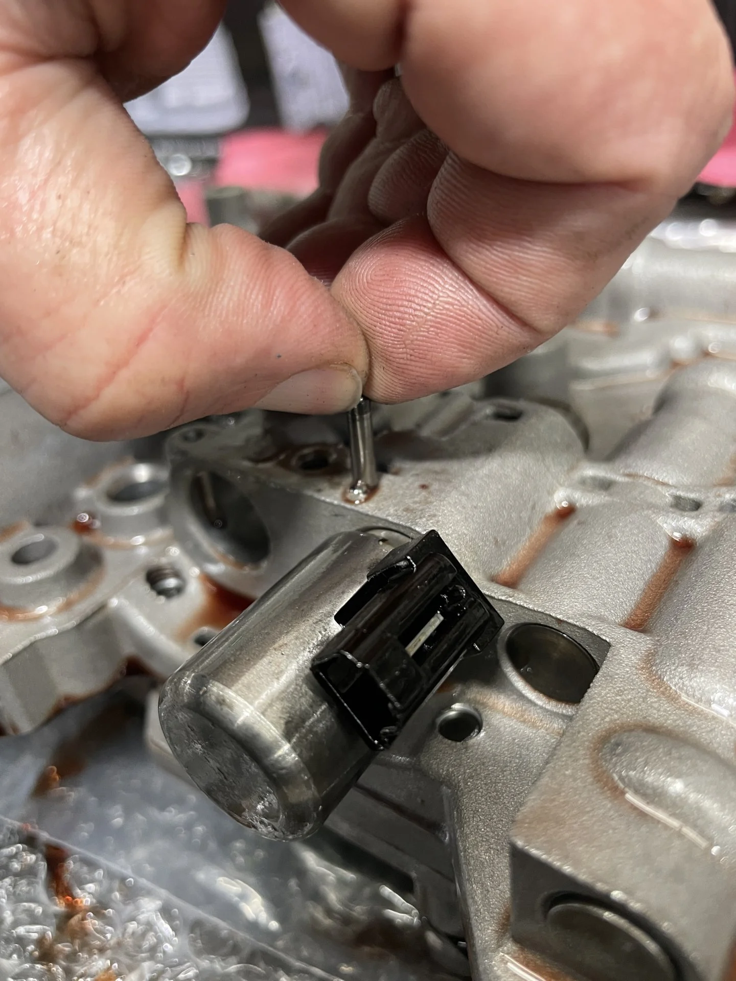

New and old side by side. The new valve body does not come with new solenoids (or any hardware for that matter). These get transported from the old VB to the new. Take your time and it's really easy. The manual shift linkage comes out only after removing the two solenoids blocking it's travel path (top right on old VB). Solenoids are retained by either a bracket and bolt, or a bracket, bolt and alignment pin. The alignment pins are held in place by a steel bracket that's bolted to the VB surface.
Pulling one of the alignment pins (also get transplanted to the new VB).
Looking up at the transmission, you can see the 4 valves (one on the right dropped out) that are still held in by viscous magic. Leave 'em be or add some vaseline to keep them in place. If the trans is still warm, vaseline will do no good. The three grommets along the medial line get replaced with new (included in kit). The smaller rectangular opening at top right is where the small ball pressure valve seats. It will take a lot of vaseline to hold it in place because it has a very loose/free fit in this recess.

Here's where the tiny ballpoint pen-like pressure valve ball goes.

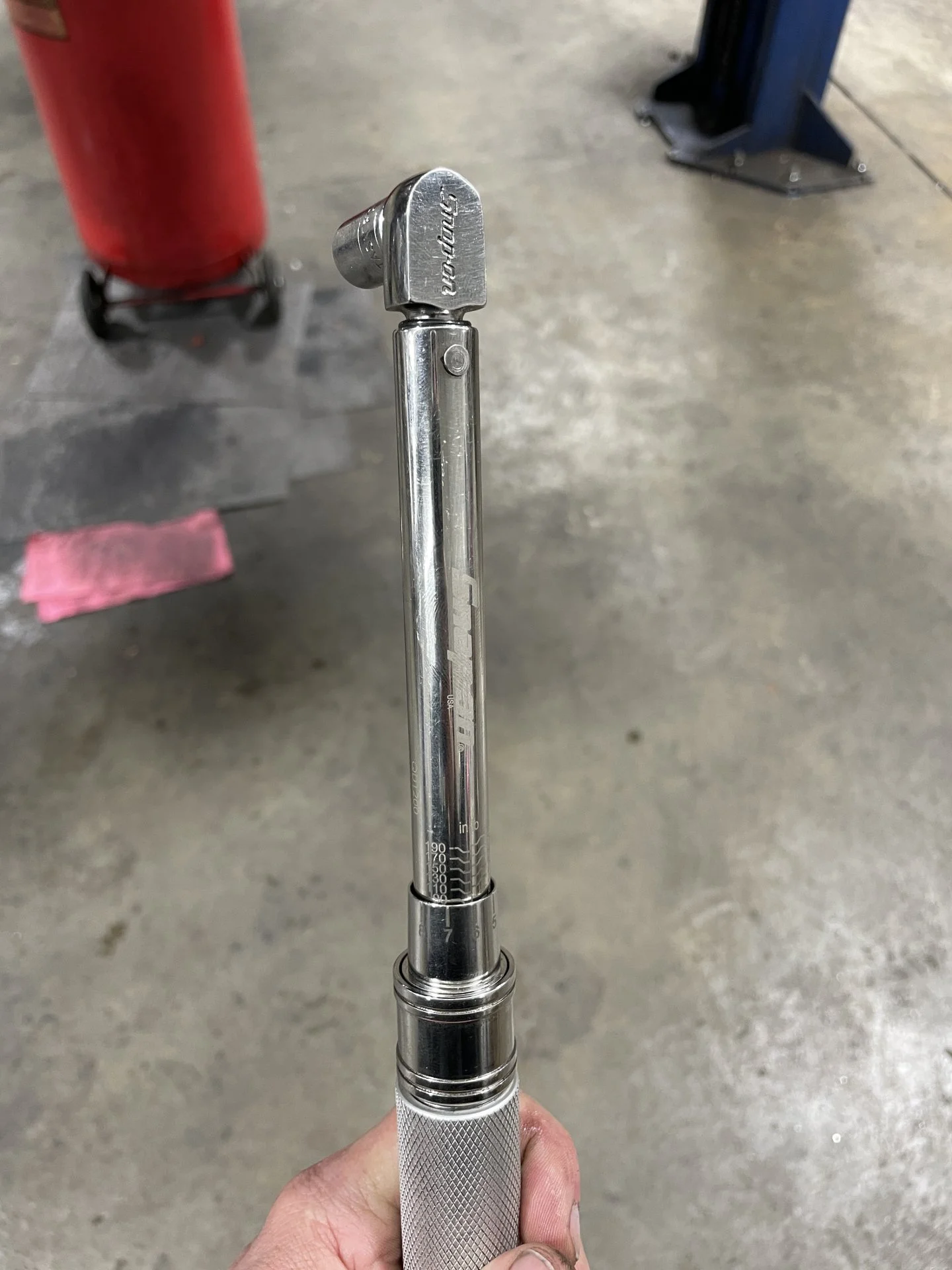

Then find yourself a nice inch-pound torque wrench to reassemble all the 10mm bolts (8 ft-lbs = 96 inch-lbs). Three of the bolts are 36mm long and the rest are 25mm long. The three long ones go in near the filter orifice along side the sensors I mentioned above. It's in the instructions, pretty clearly, but I took a sharpie pen and marked an "L" next to those three bolt holes before I got back under the truck just to make it easier on me. This is the trickiest part - making sure all the valves and springs don't fall back out of the upper assembly while trying to get the manual linkage arm into place and then running a few bolts in to hold it in place while you insert the other 15 bolts.

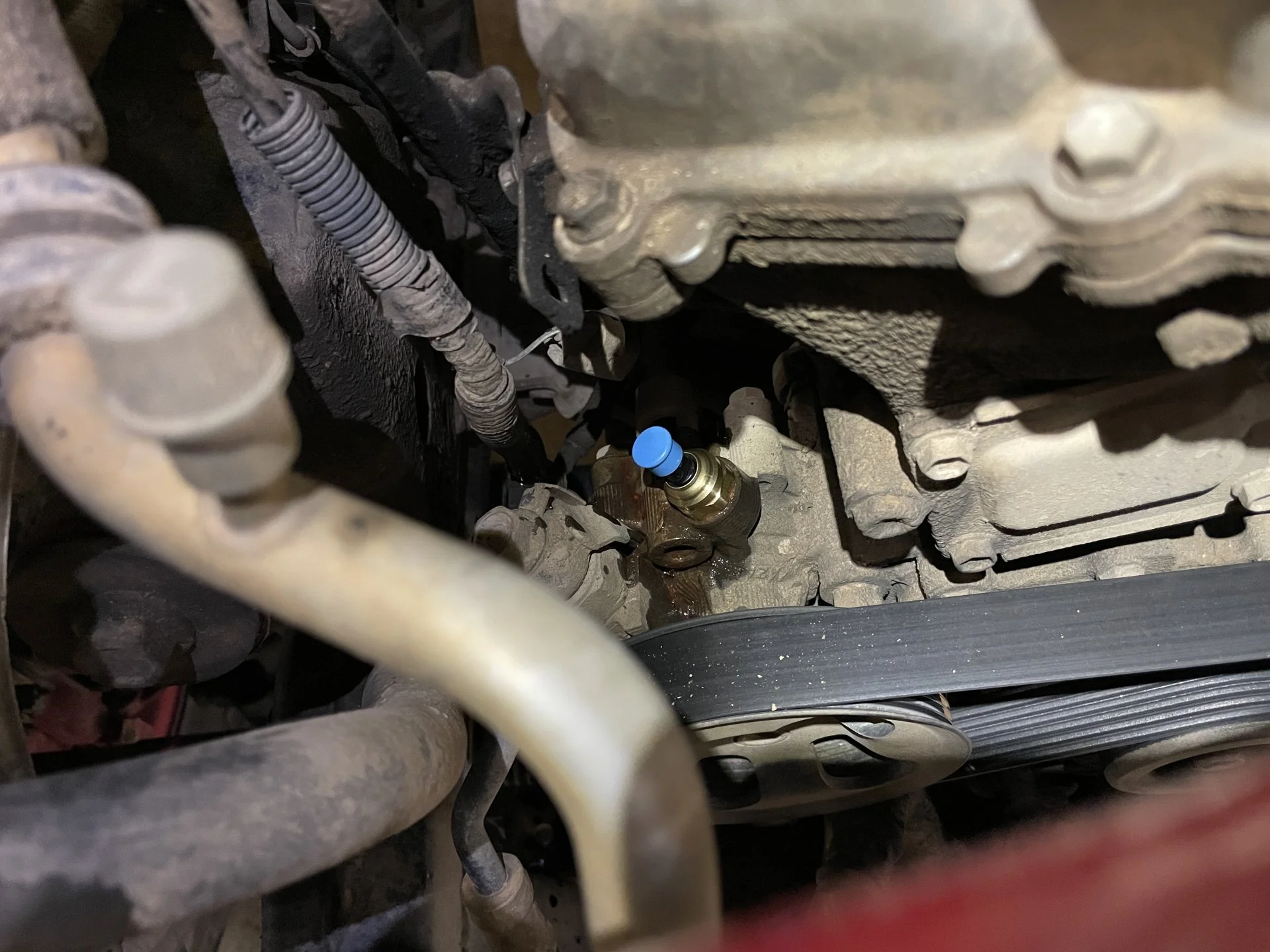

New twist. Got the engine to stall in my parking lot at home last night. Turns out it's likely PS pump related and not transmission related. Both times above it was stalling when I was backing out of a parking space - wheel at full lock when I transitioned from R to D. So, I remembered that last night and sure enough, it's the PS pump bogging down. Probably some kind of vac valve pressure sensor that supposed to idle up the engine and it's not working properly.
New sensor and a couple hoses for good measure. But it didn't fix my stalling issue.

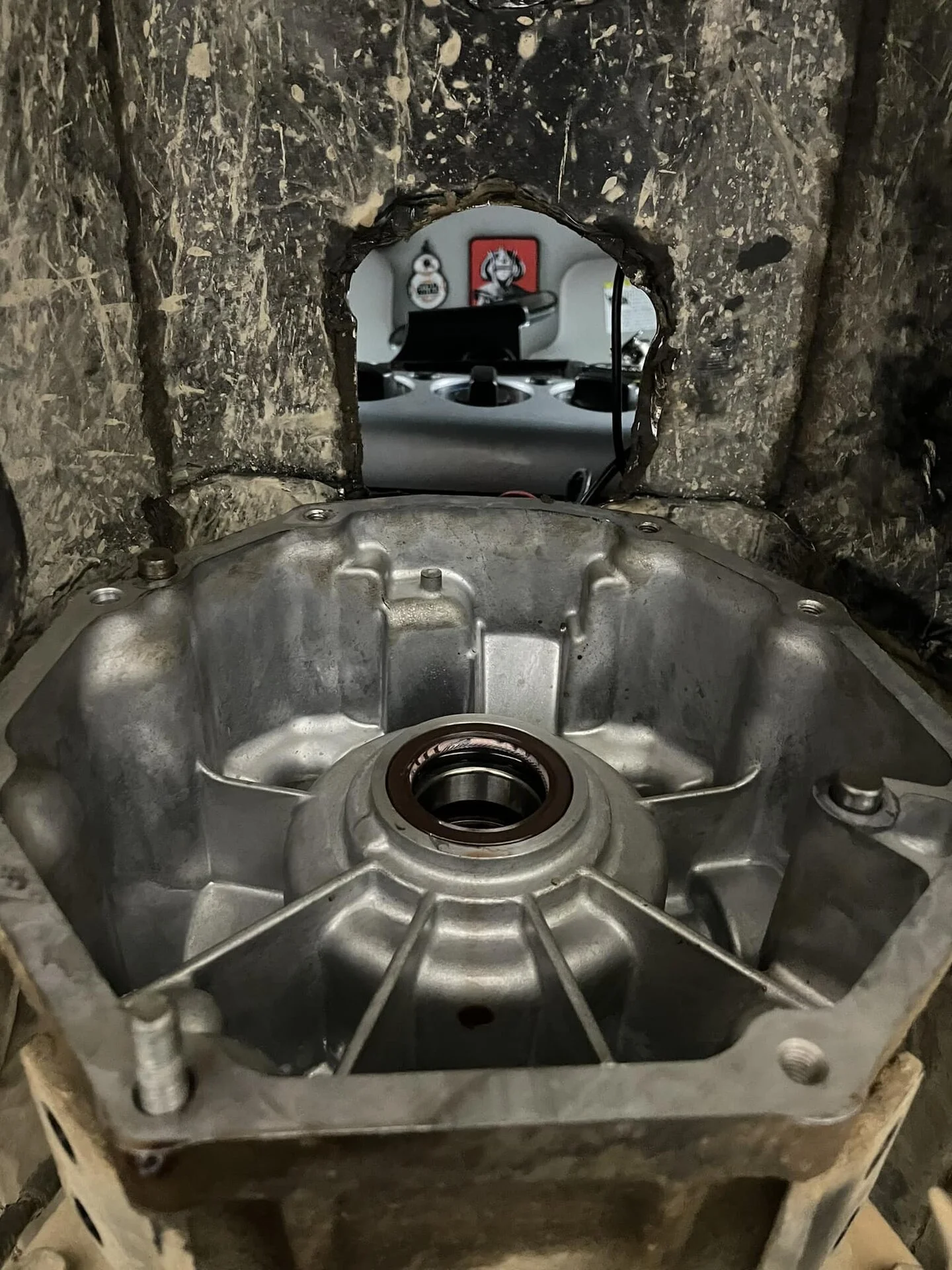

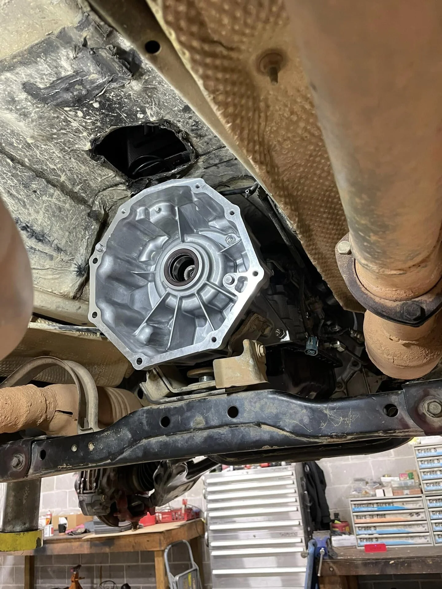

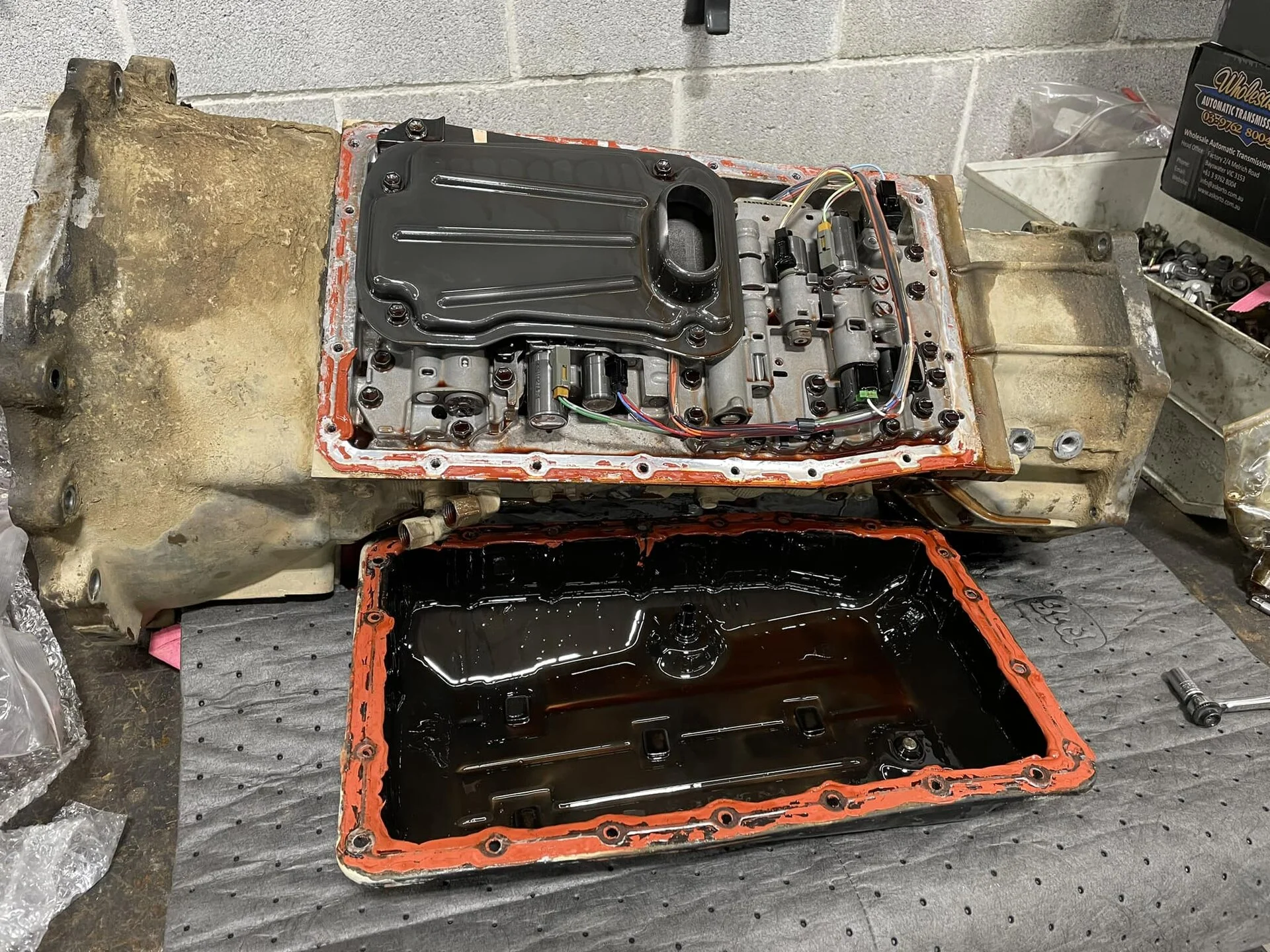

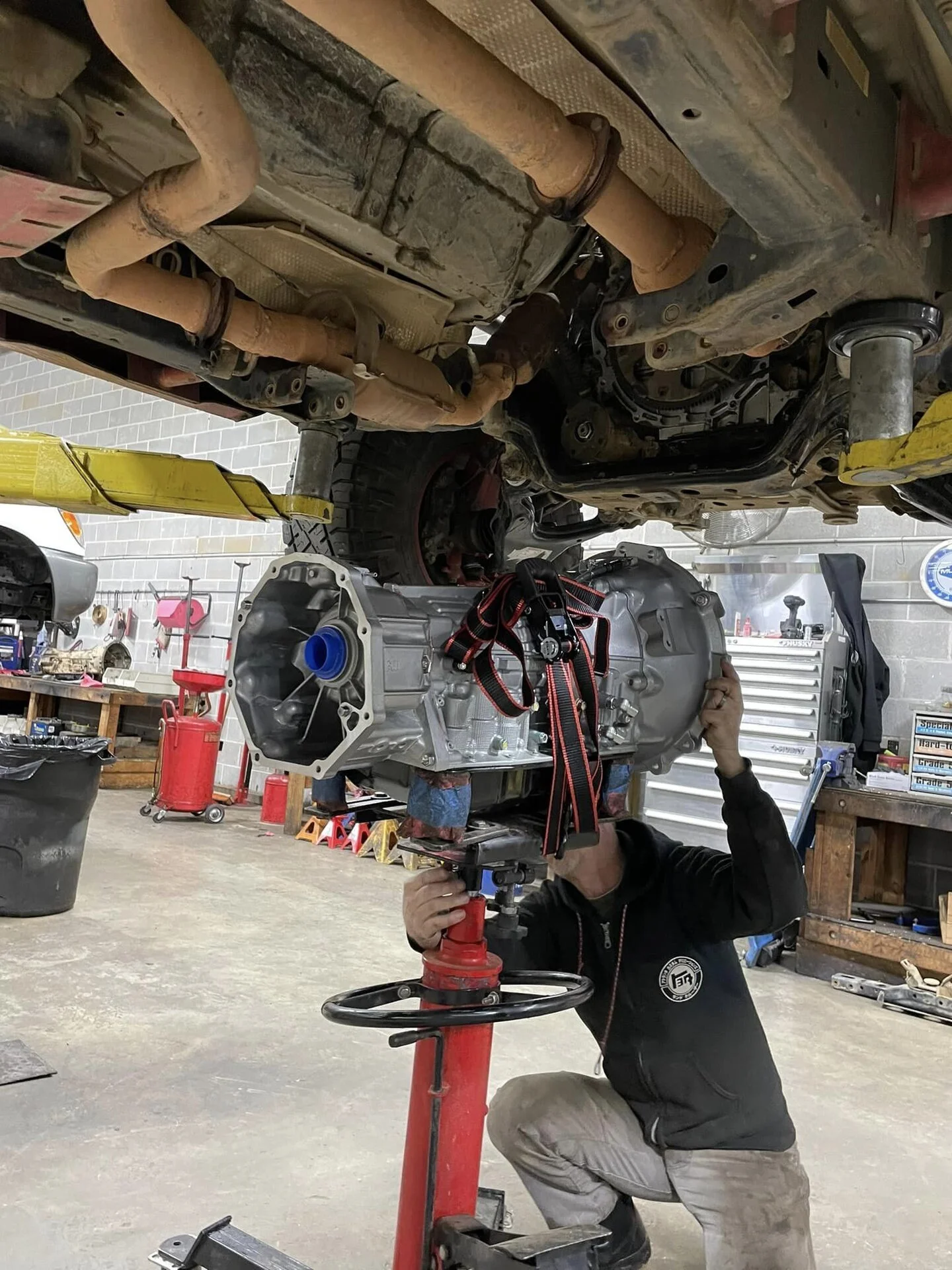

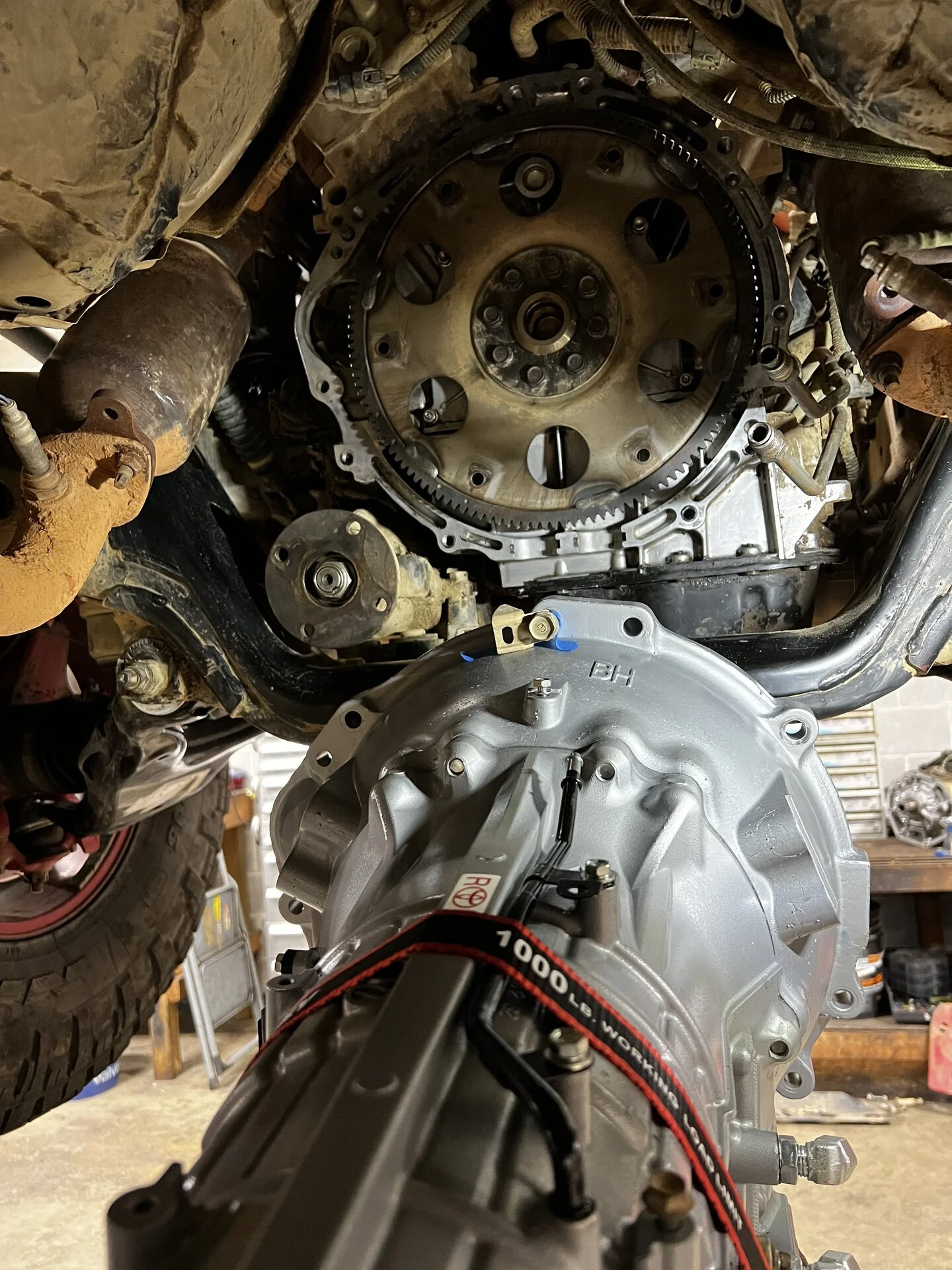

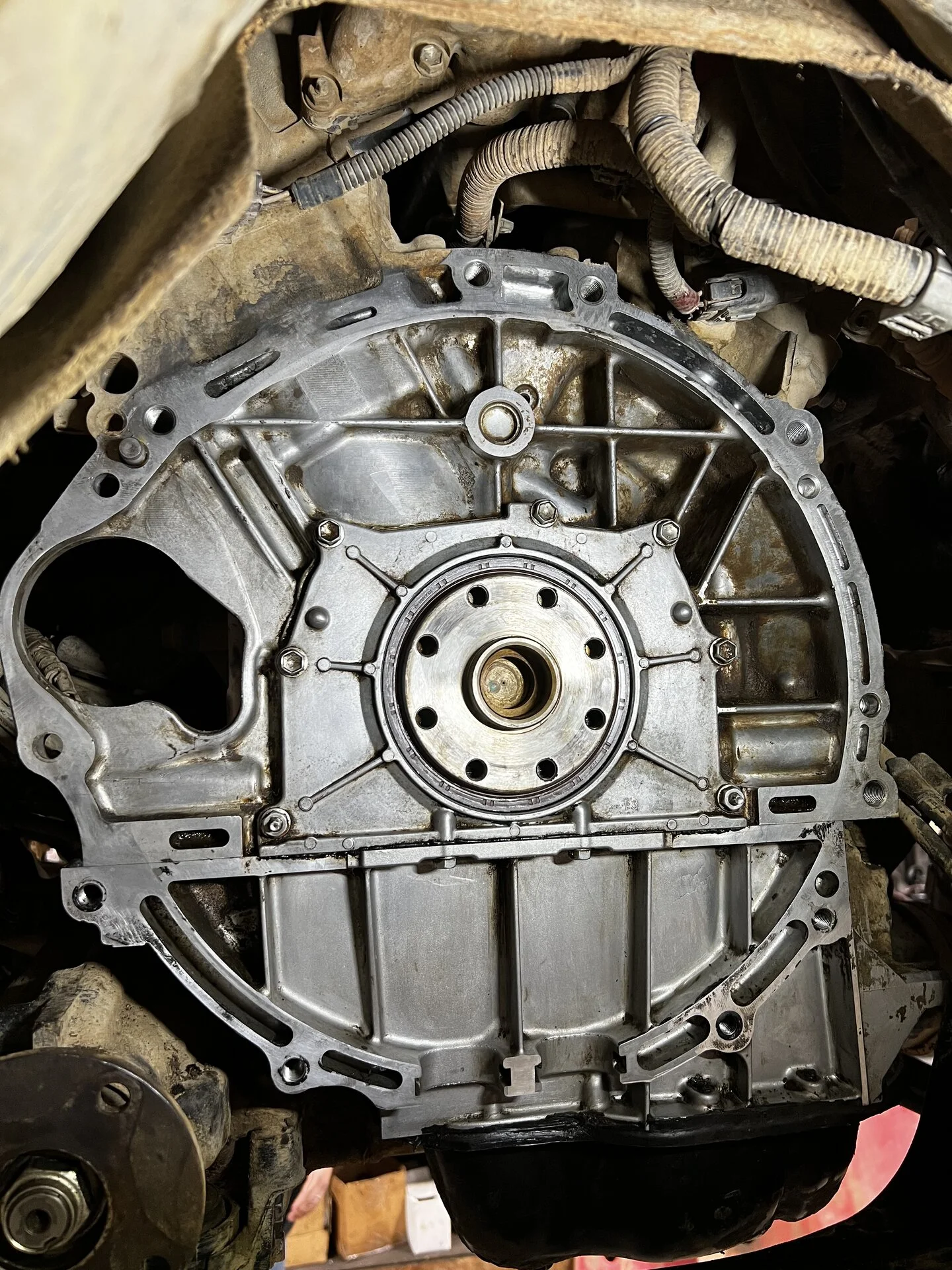

It all started back a while ago and I've just put it off this long. The transmission has about 303,000 miles on it and has been slipping in the lower gears, and even stalling between reverse to drive maneuvers (like backing out of a parking space). I finally ordered a reman transmission from Toyota and it arrived about a month ago. I recently got sick, recovered and felt well enough this past weekend to do the swap. I have pulled the trans once before to redo the rear main seal, so not completely unknown territory, but still a really big project that involves removing a lot of components.

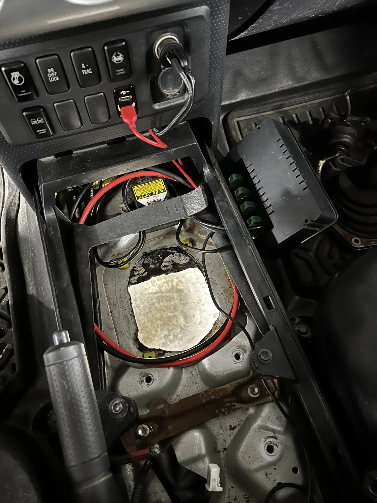

You have to remove both drive shafts, the starter, the transfer case, the middle cross member, the Y-section of the exhaust, the exhuast manifold brackets that are bolted to the bellhousing, the transmission cooling lines, all the wiring harness doodads on the tcase/trans, the breather lines on both, the center console to access the transmission shifter and tcase shifter. And not necessarily in that order ;)
Over Saturday/Sunday I spent about 20 hours in the garage. The first day was just removing the trans, putting the OEM valve body back into the return core, installing a new rear main seal (why not while you're in there). Second day was devoted to installing the new one. Had trouble lining up everything just right to put things back together which is why this was a longer day than the first. First was getting a few bolts into the bellhousing using all the socket drive extensions you own. Then the flex plate and torque converter lined up, then getting the starter lined up and re-attach wiring harness stuff. There's a couple bolts on the tcase that mount front to rear and you need to get the one closest to the crossmember bracket in before you raise the tcase to bolt it in. I'm still sore in places from all the lifting, craning, reaching into blind spots, etc.
