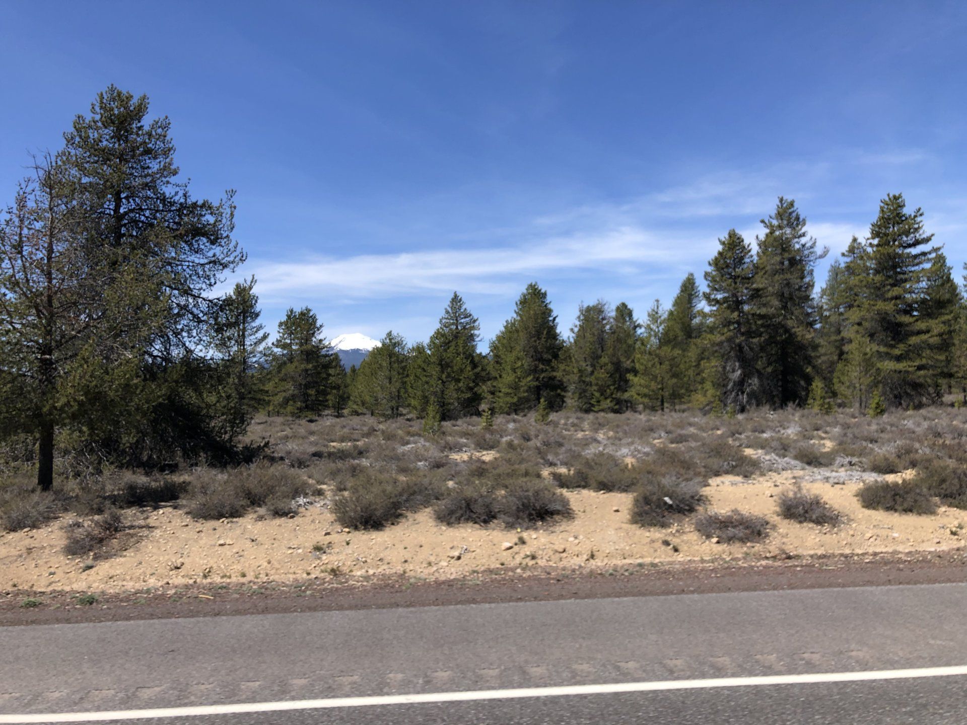

Here’s the lot I bought. All lots are an acre and buildable. Power is at the road. Mine actually had a 60’ well drilled in 2012 that was not listed on the lot description. I found the well on my walk about and got the info of the well iD tag. My realtor got tax ID off the well log and it matches the lot tax ID, done deal $6500.00 🤣

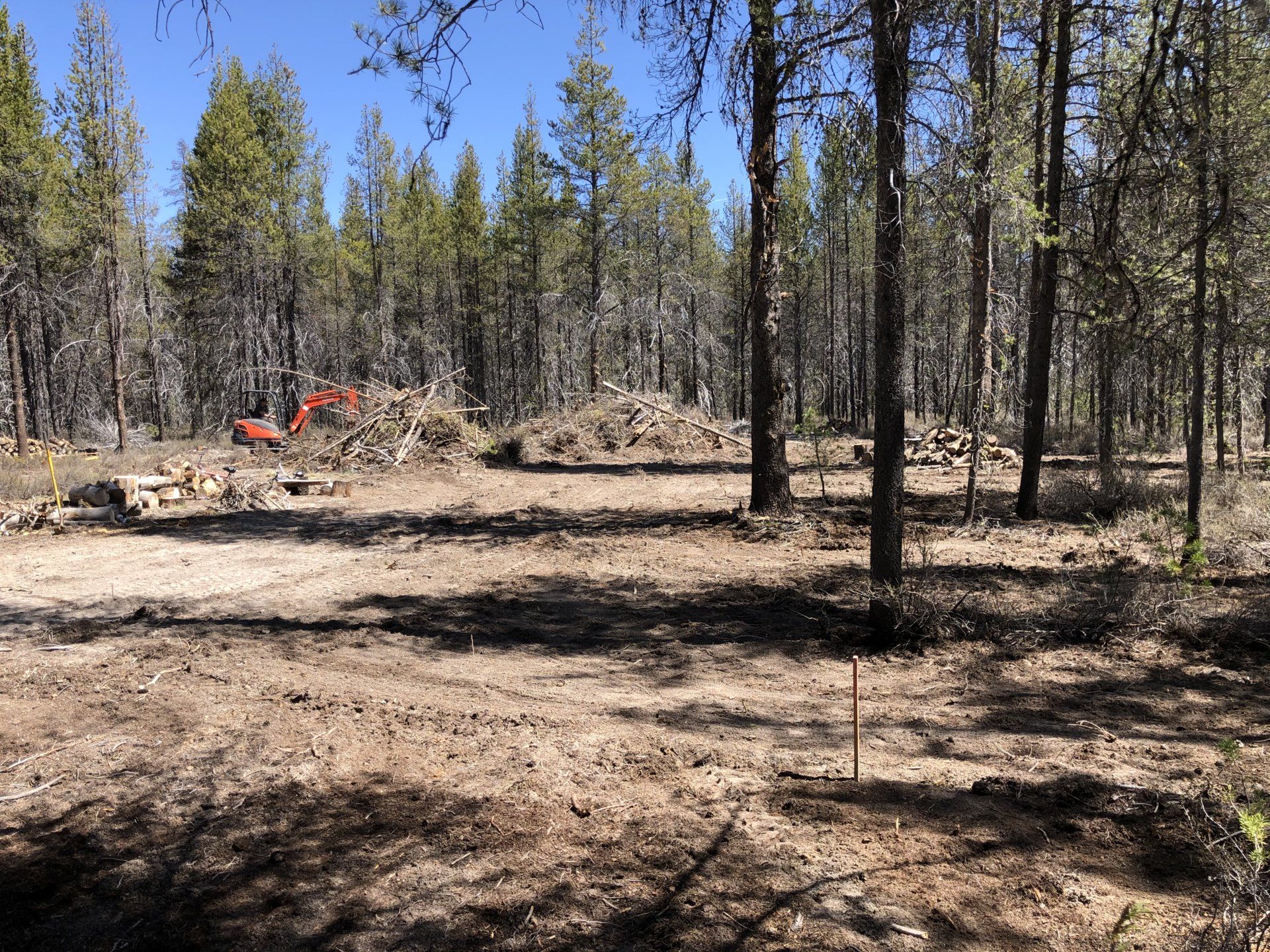

Time to clean up and build slash piles
Excavate site for a pumphouse

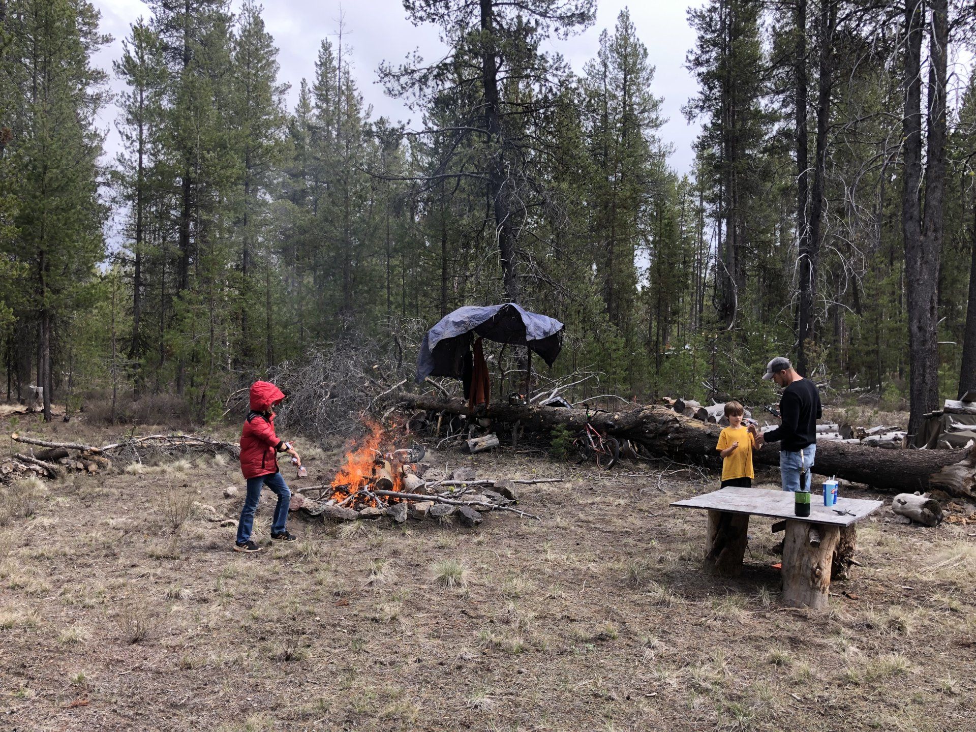

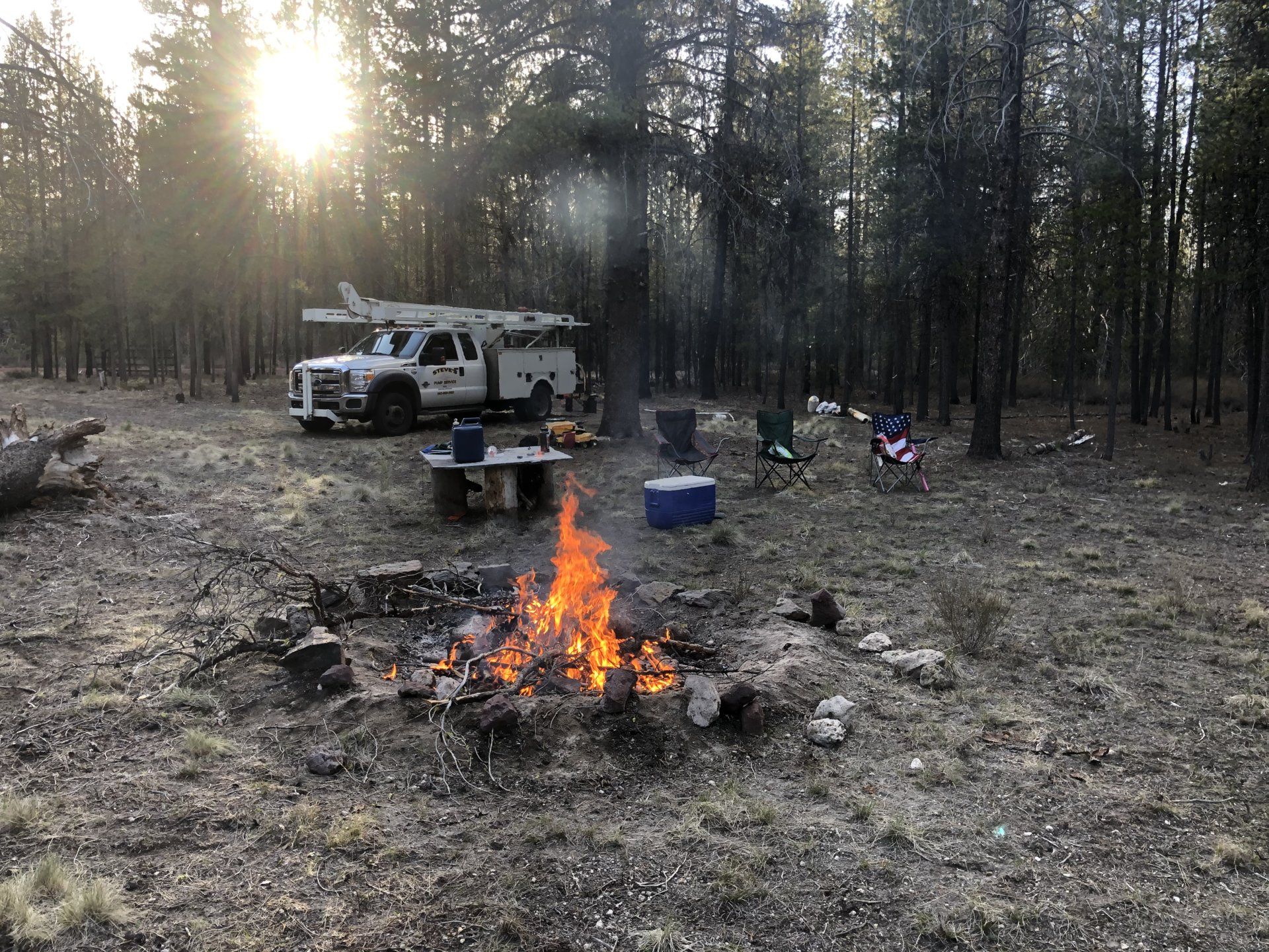

Got a fire going and camp setup

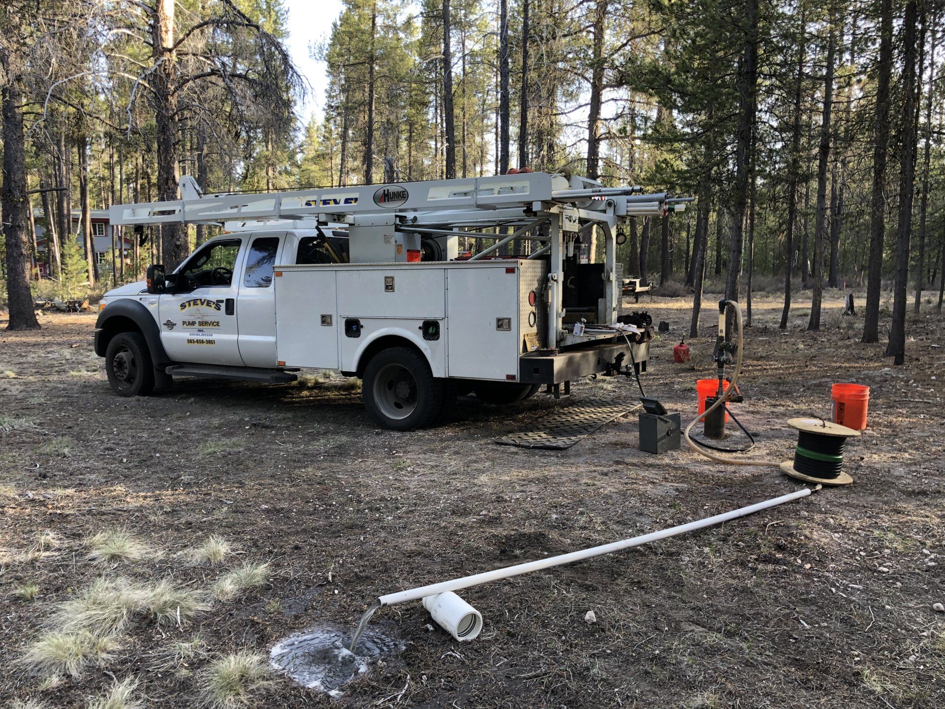

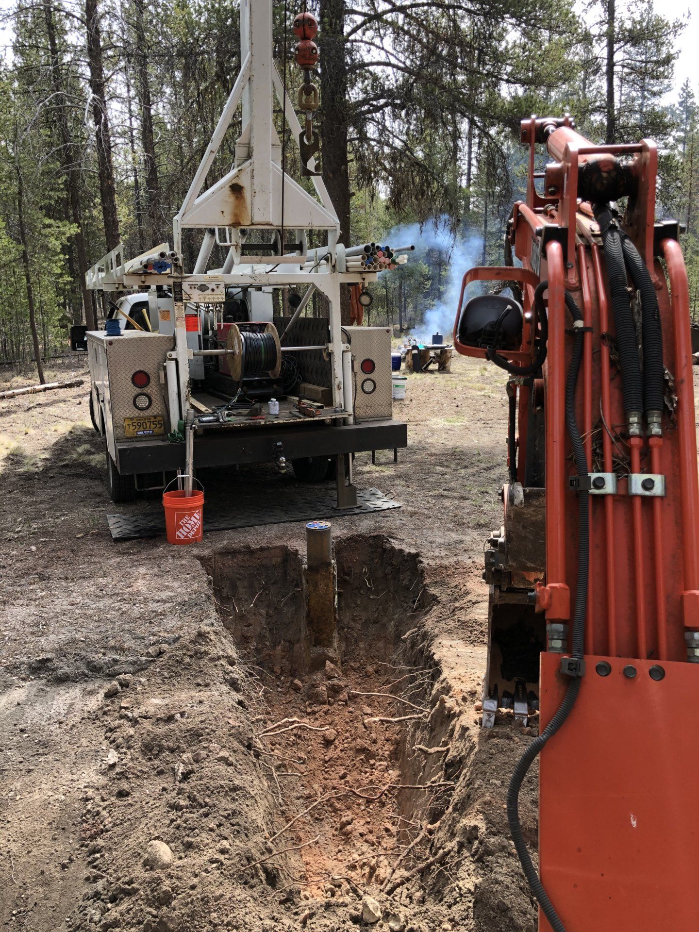

Main goal of trip is get my well going. My well 6” steel casing that’s 60’ deep. It has a 4” PVC liner inside with a fine 10 slot screen at the bottom to keep debris like gravel/ pumice out of the pump. It’s also set too high and need to cut it off so it’s deeper in the well.
Set up on the well.
Used our PVC liner removal tool to extract the PVC liner.

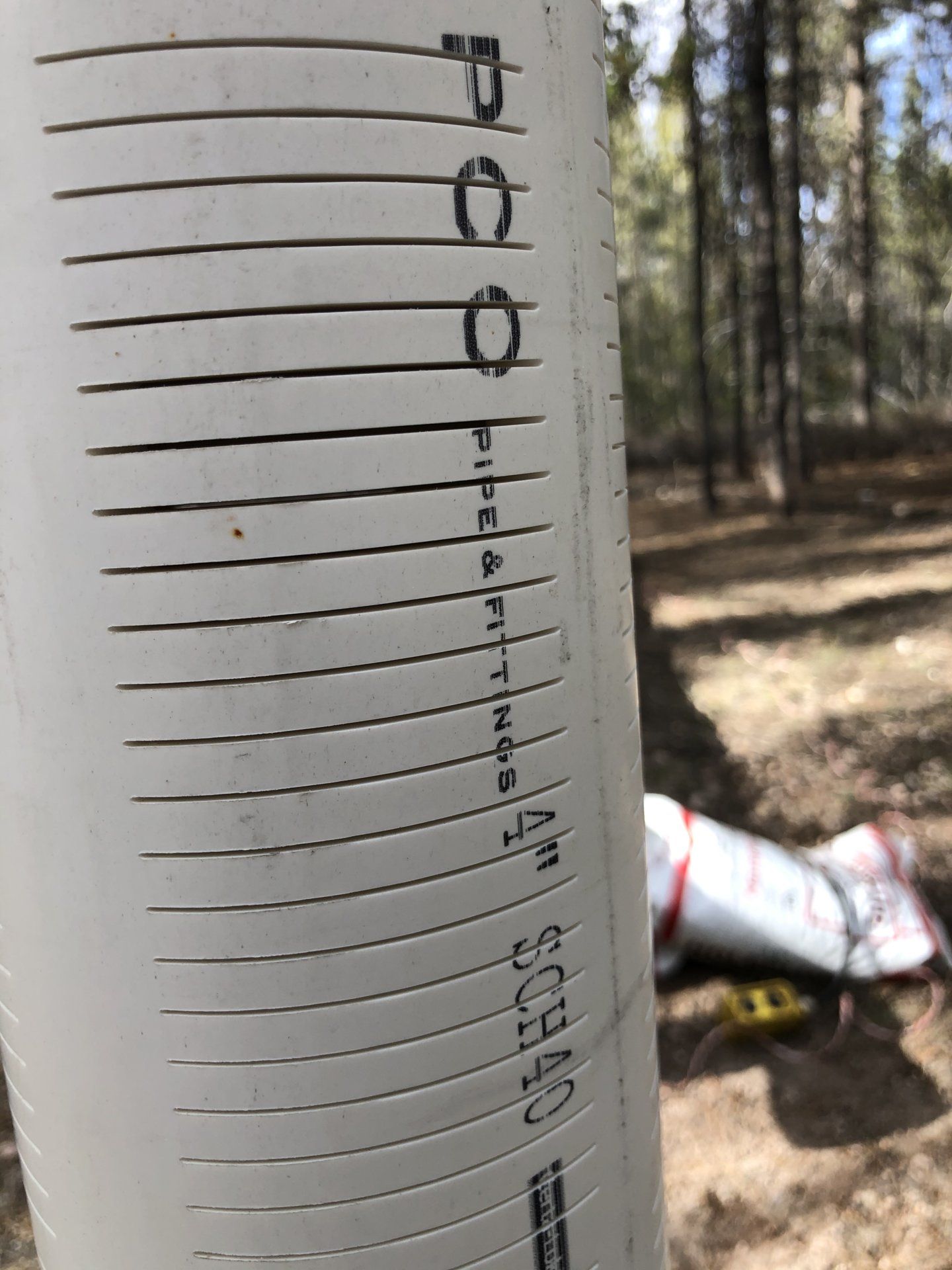

Here’s the fine 10 slot screen.
There larger 30 slot screen for better flow rates.
Now the 4” PVC liner goes from 10’ below surface to 60’. Originally it was set at surface level making it not possible to install a pitless adapter.

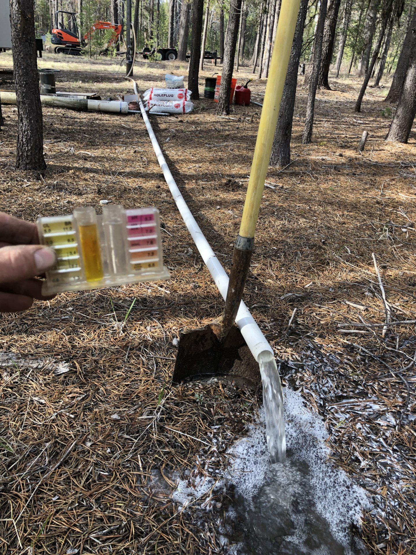

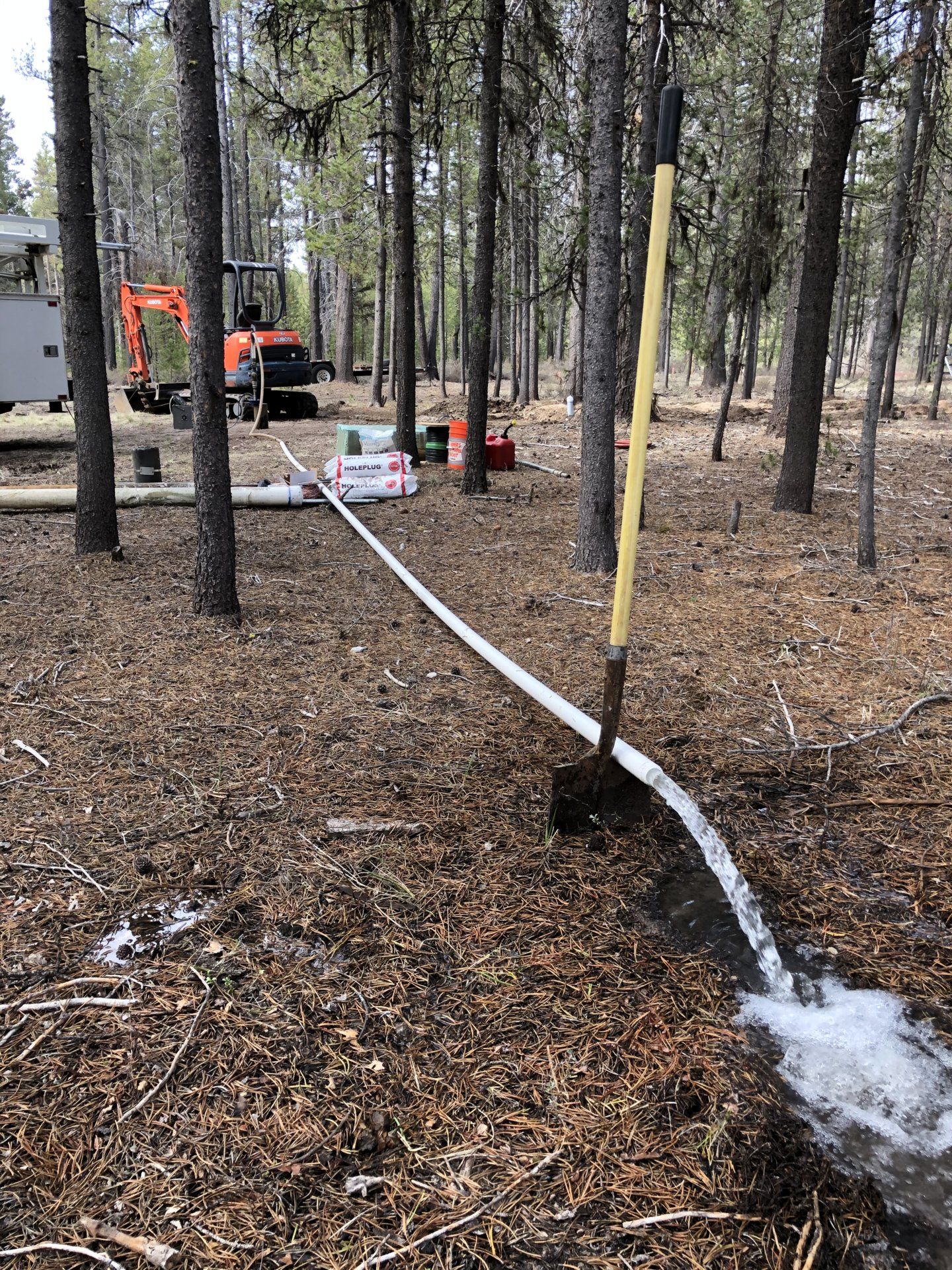

Shock chlorinated the well before I left the property Friday night to allow the chlorine to sanitize the well til Saturday morning. Returned and pumped the chlorine out and also did a flow test.
Chlorine was still present.

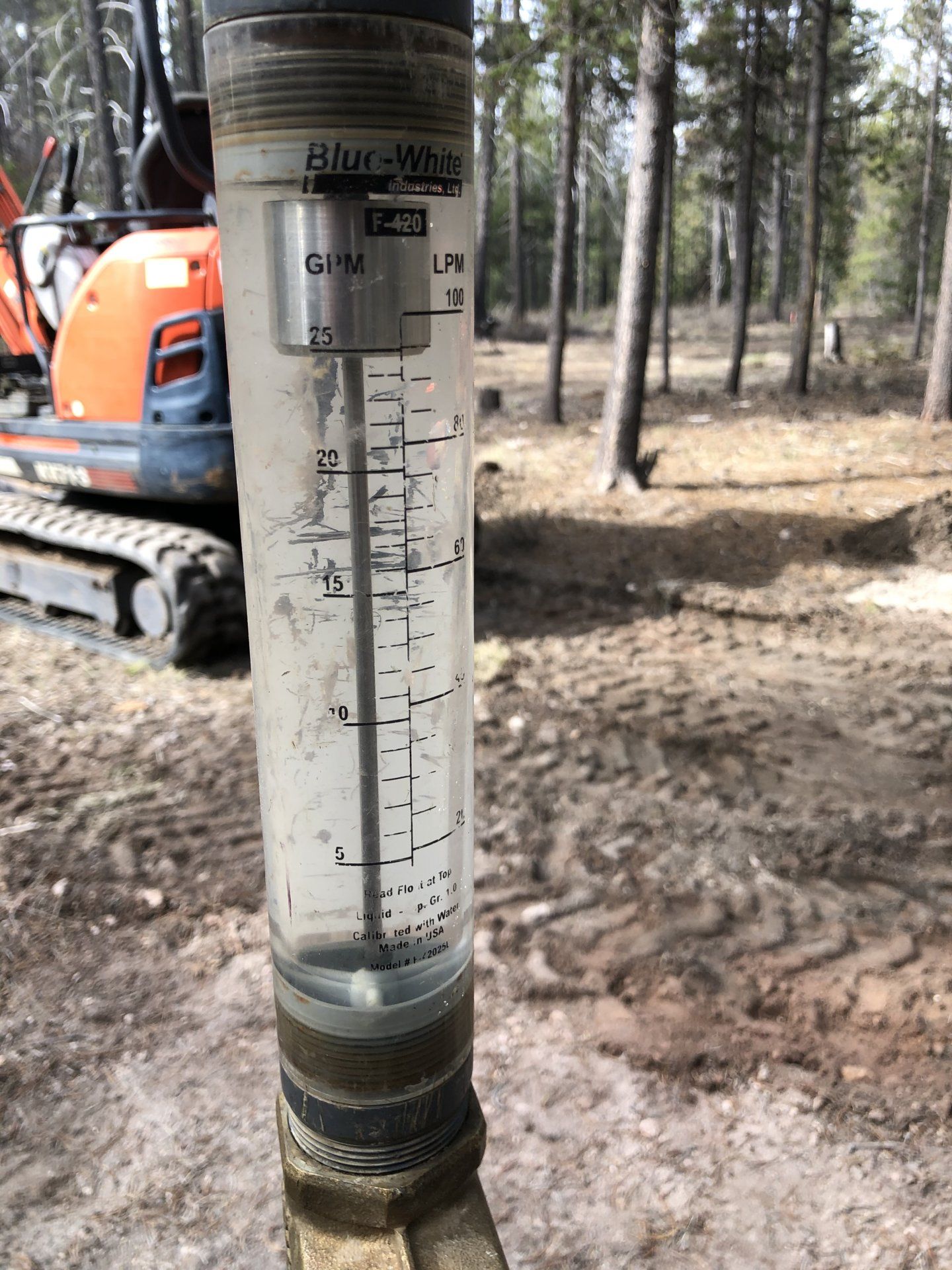

Flow meter on wellhead with pressure gauge.
15 gpm at 70 psi.
Opened the valve wide open and it maxed my flow meter out. Probably 30 gpm.
Static was 20.5’ drewdown and stabilized at 40’ pumping 30 gpm.
Now the work begins.

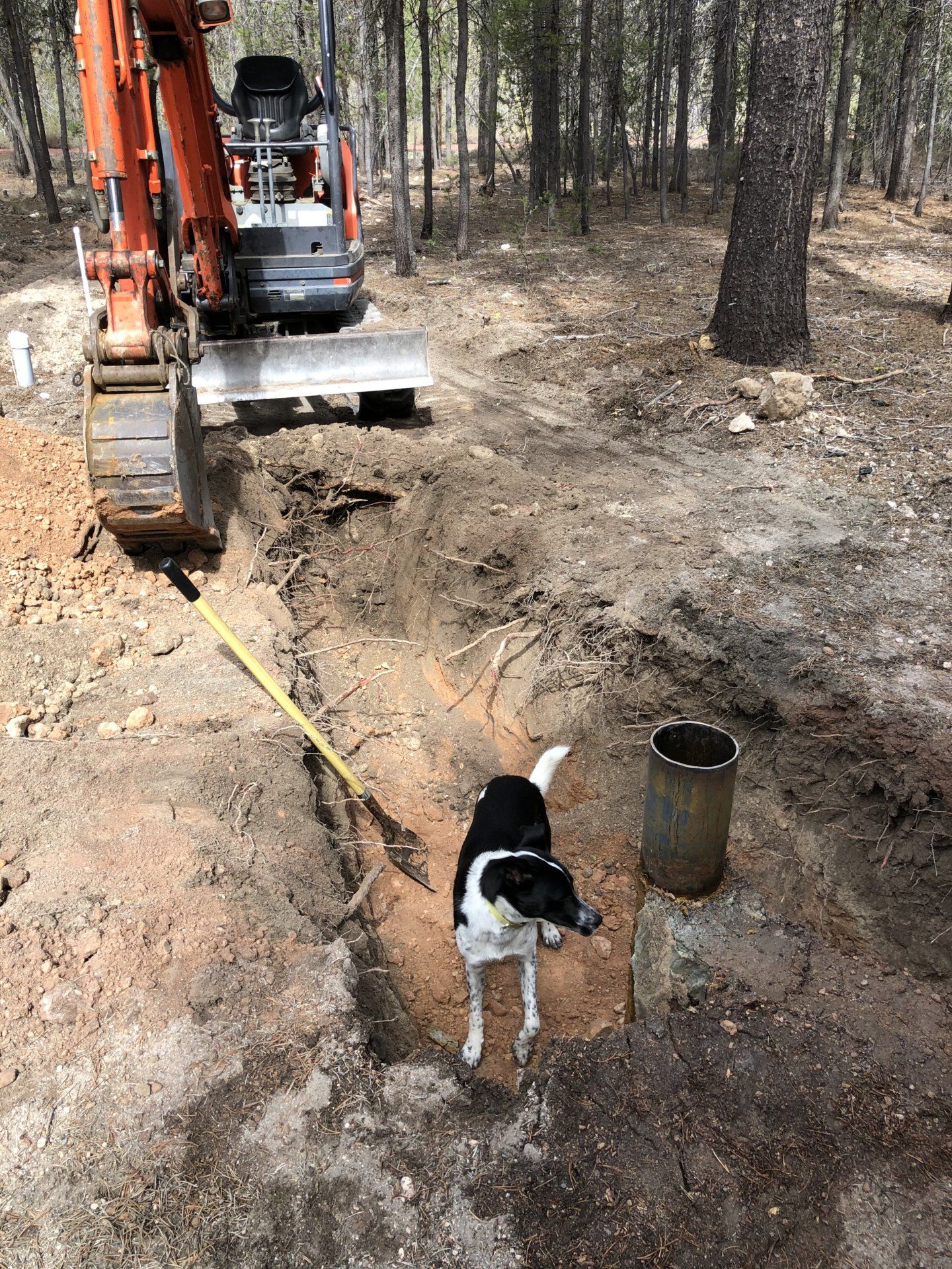

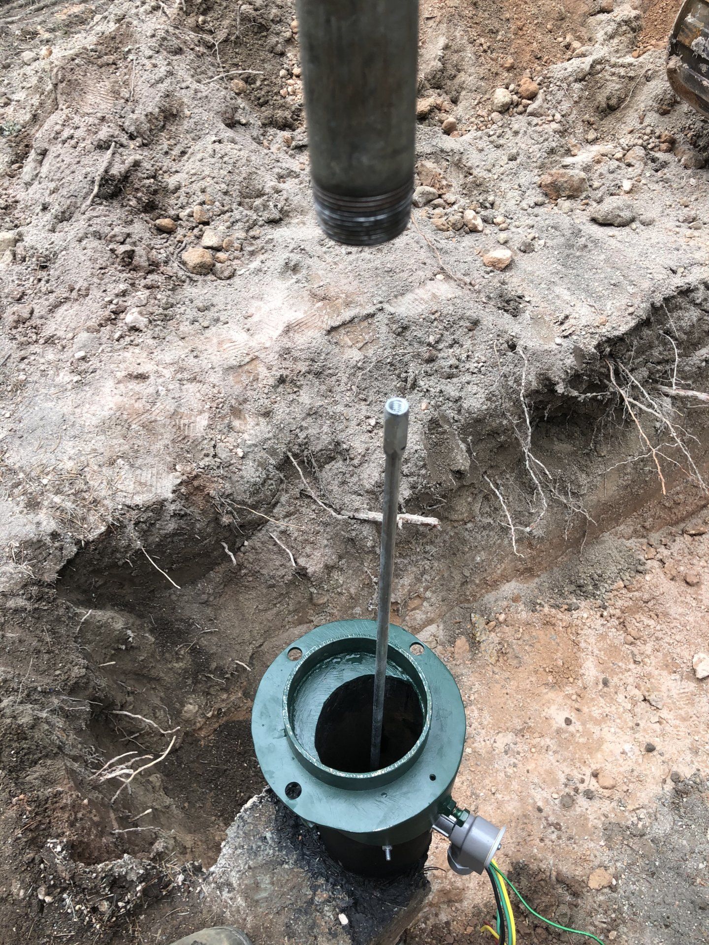

After testing well, pulled the submersible pump. Dug home with trackhoe and cut in pitless adapter holes for submersible and hand pump.
My dog Reload hard at work

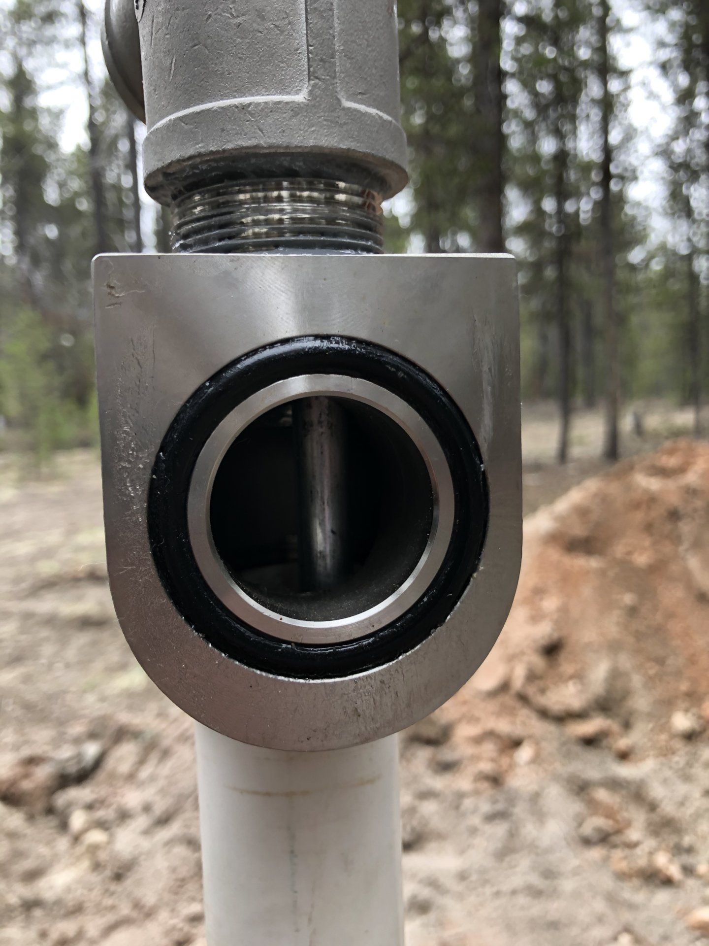

Looking down the well with both pitless adapters installed.

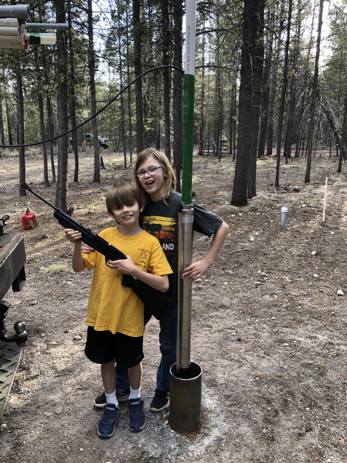

Reinstalling the submersible pump with my daughter Harlee at the controls.
My son Ryder tailing in the hand pump pipe and rod.
A proud dad watching his kids work.

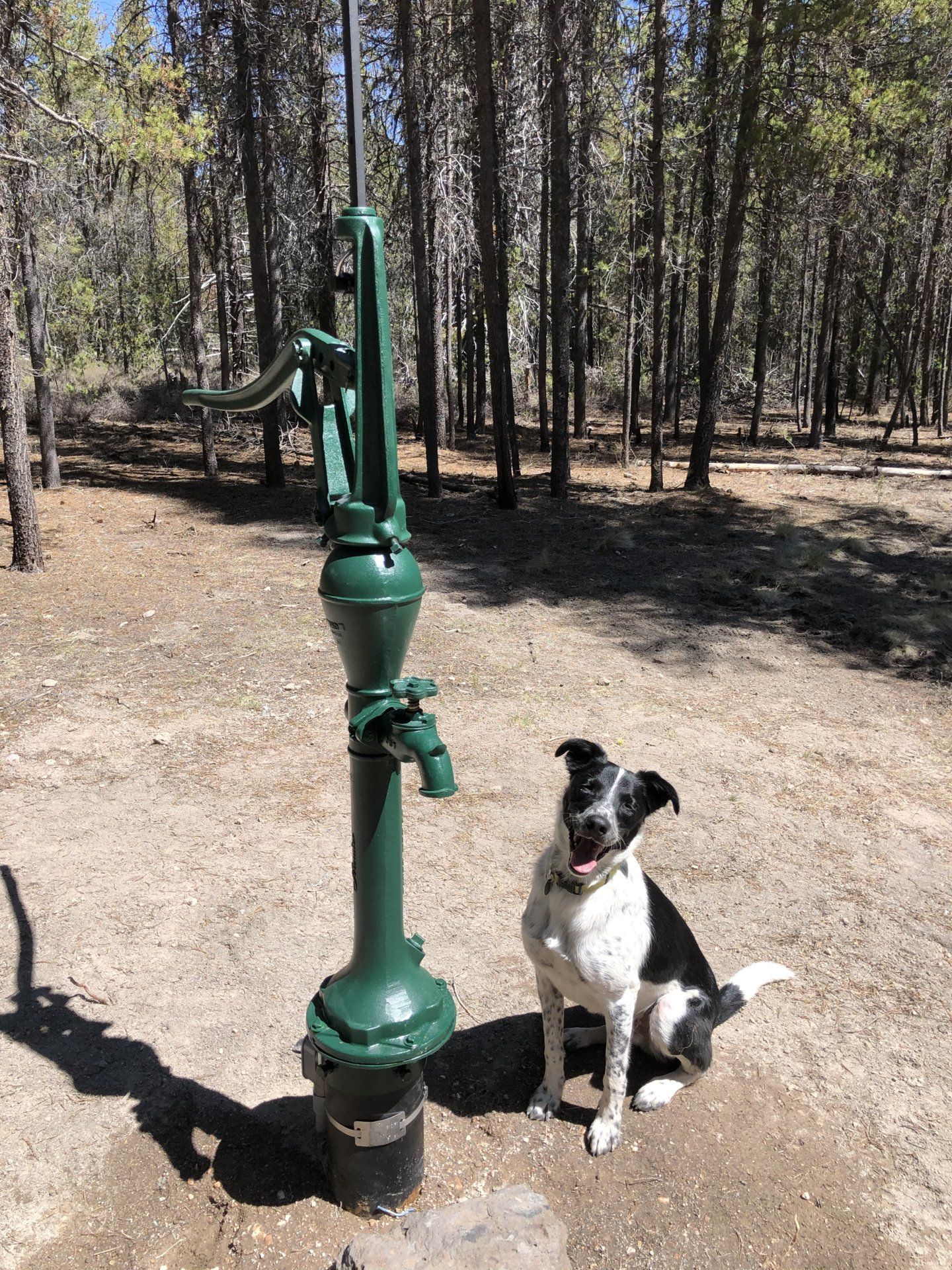

The 7/16” galvanized rod passing through the pitless adapter

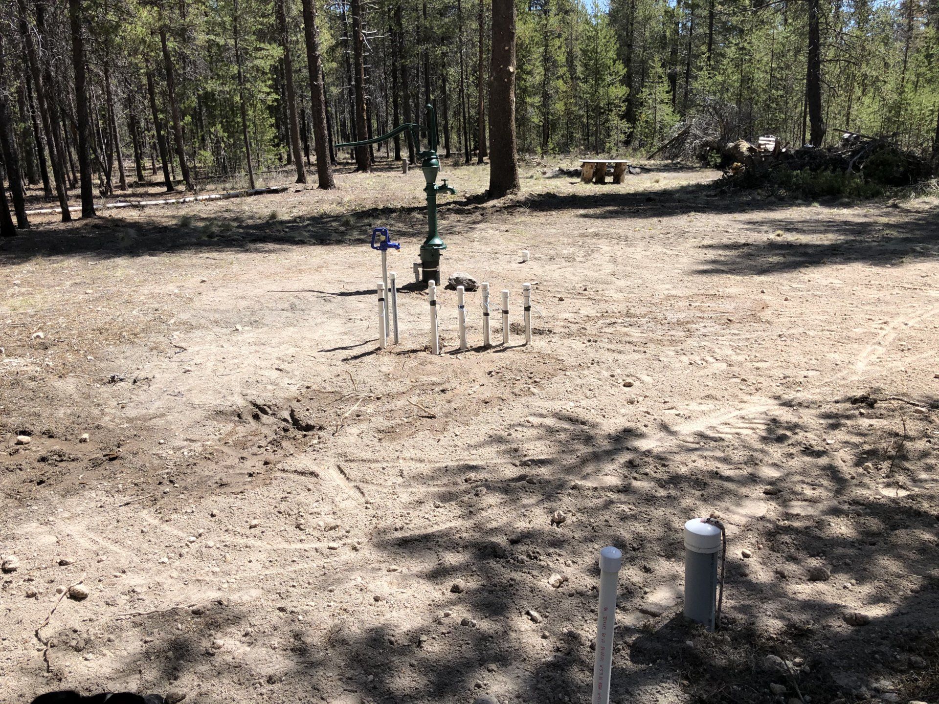

Stainless steel tee with 1” rubber bleedback to drain water from hand pump stand to prevent it from freezing. When the hand pumps stops pumping the water drains back down the well.
Getting measurements for how much pipe to cut between bleedback tee and top of hand pump stand on top of well.
Installed hand pump stand.

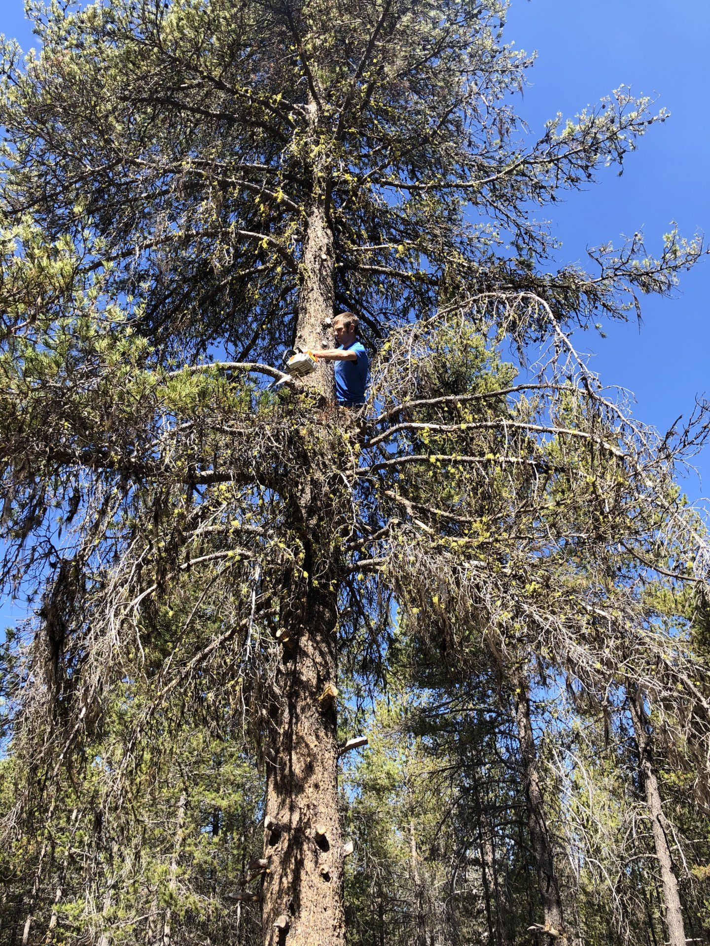

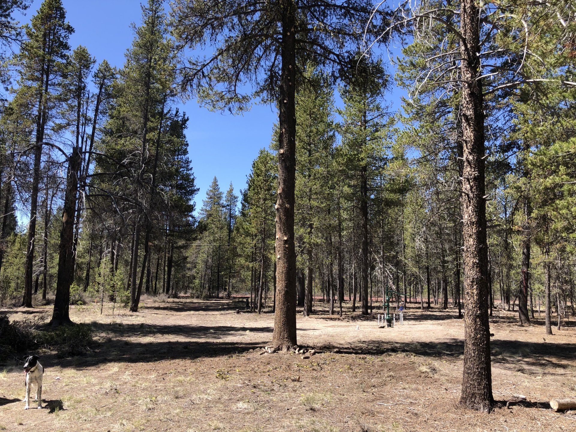

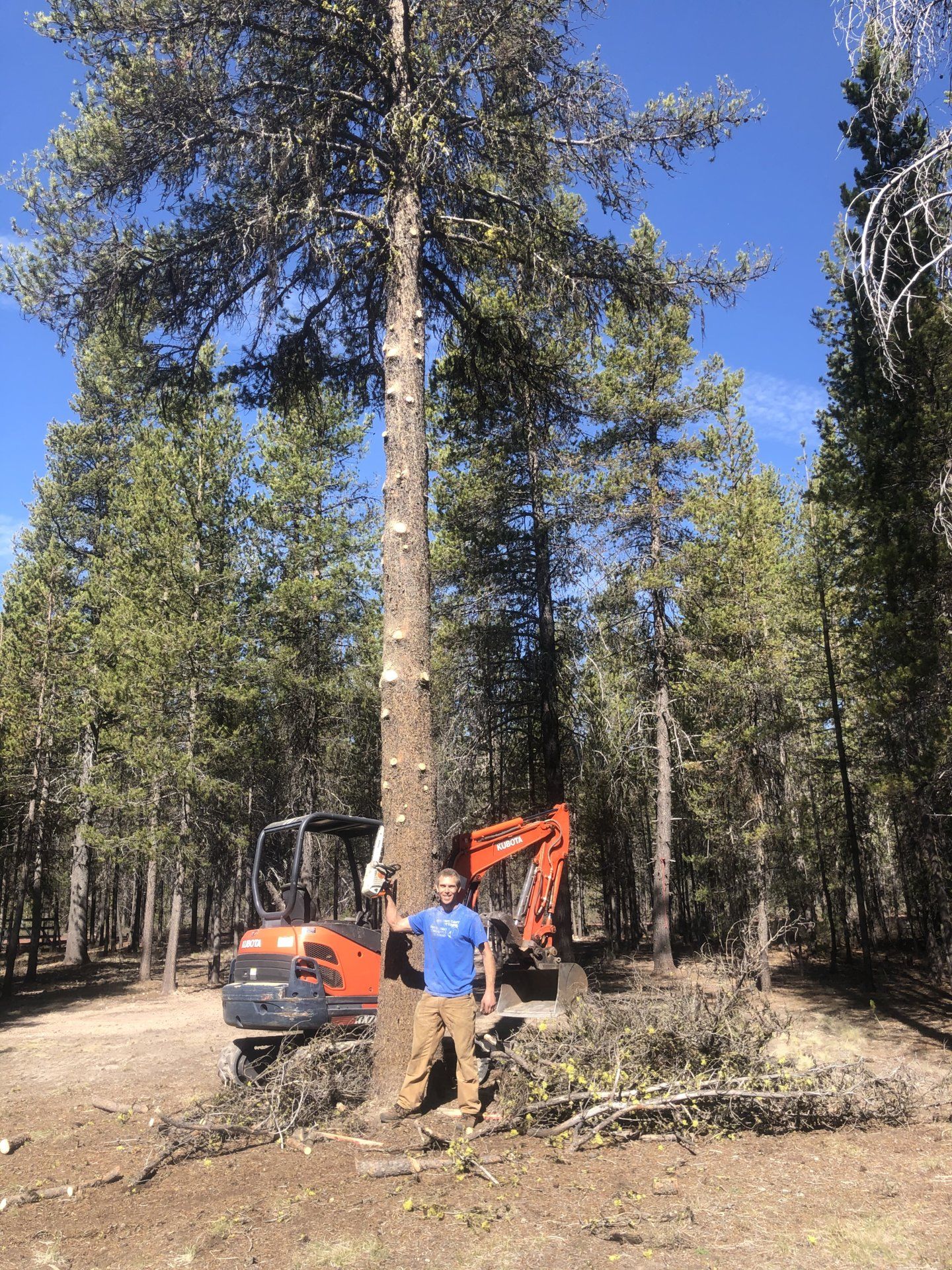

Today while making breaking decided a pine tree in the middle of the lot needed to be limbed up. Being a (little) OCD I grab the Stihl chainsaw and start climbing.
Distance between my lot to my buddy Travis’s lot.

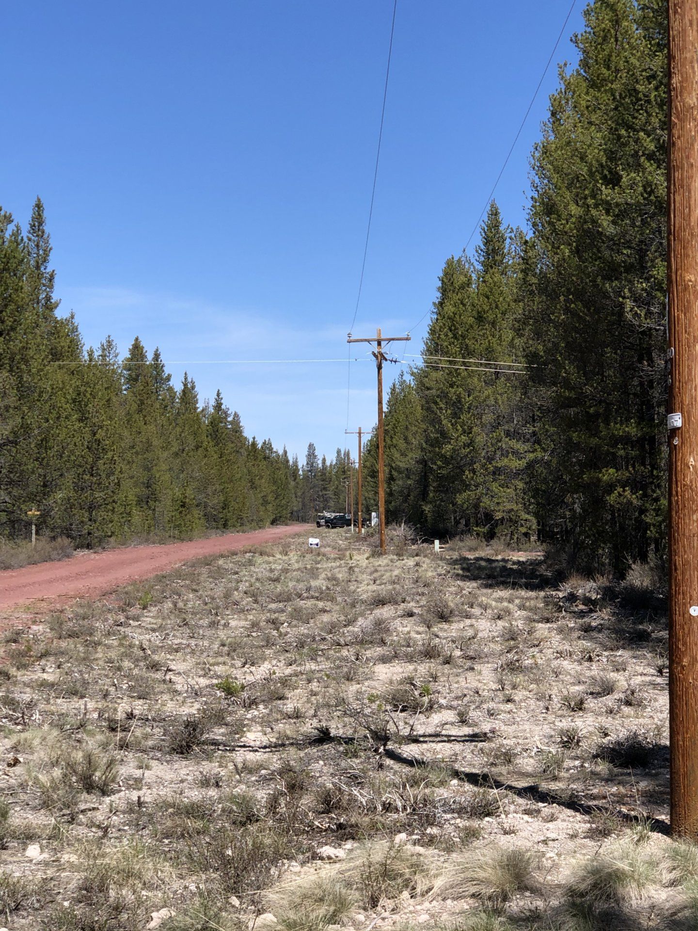

The well was all done. Next will be building a pumphouse with all the pvc lines and valves. Get power pulled from power pole at street and install a meter and breaker panel at the pumphouse. Tree I limbed is behind the well to the right.

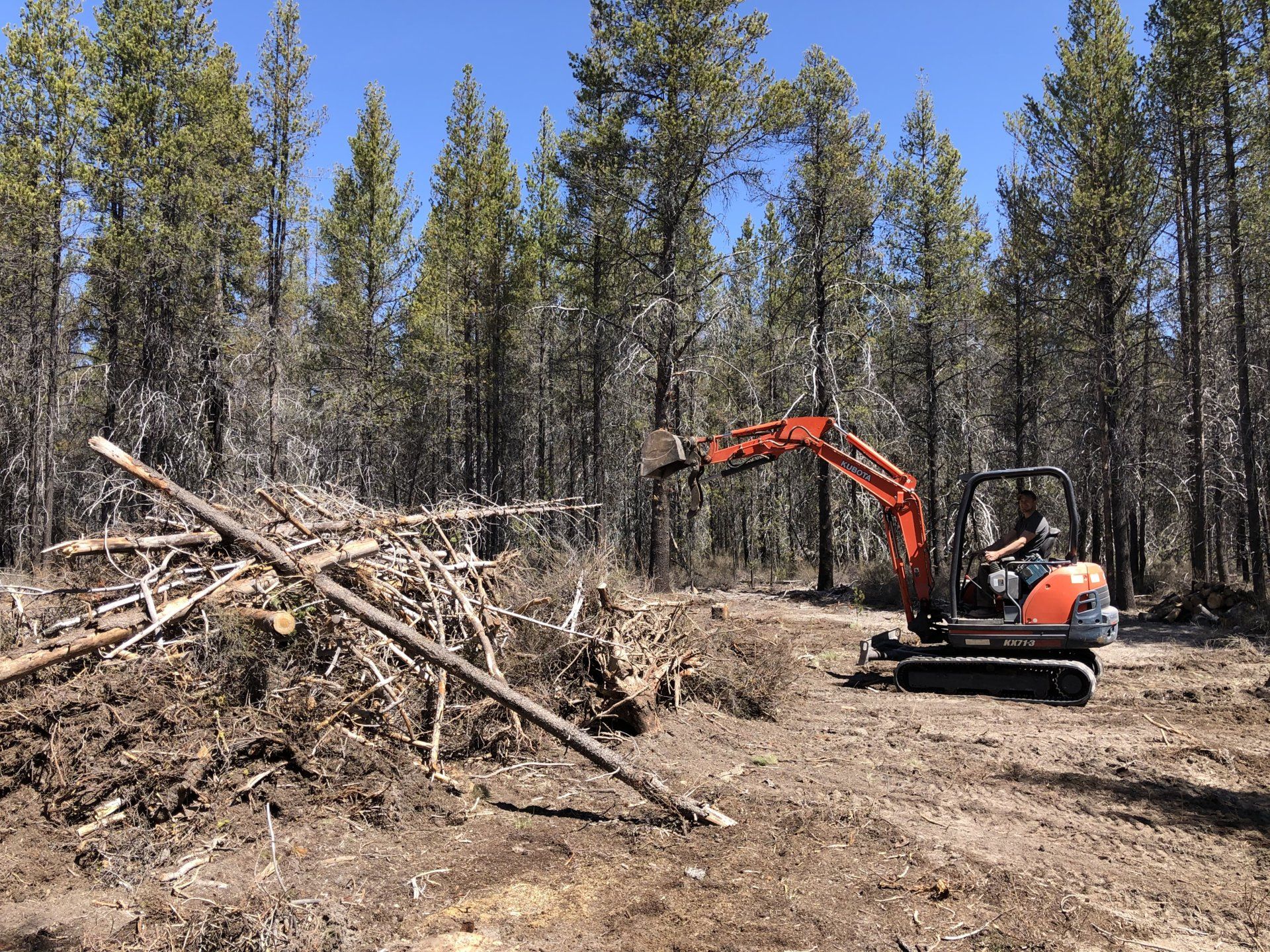

Cleaning upmy buddy Travis’s lot with the mini excavator.
More and more slash piles...
